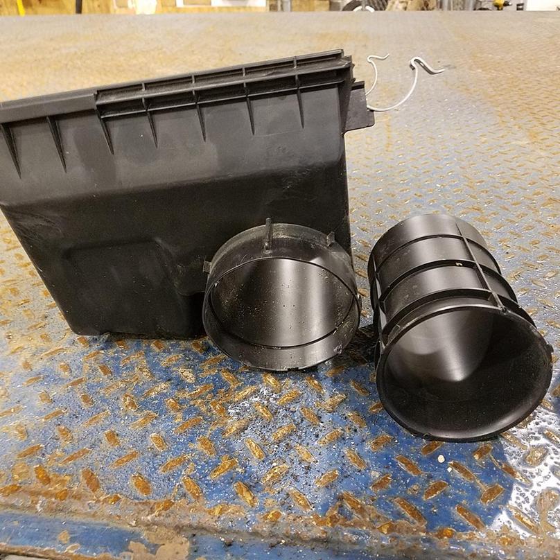

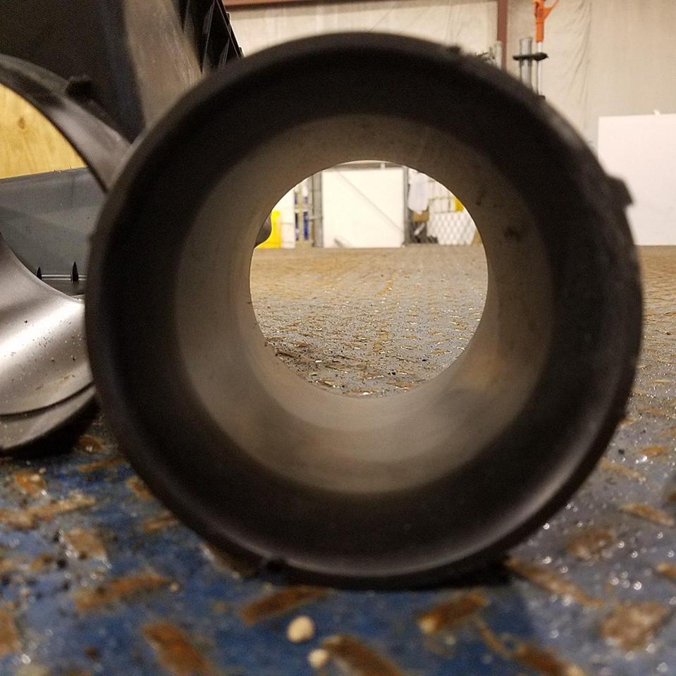

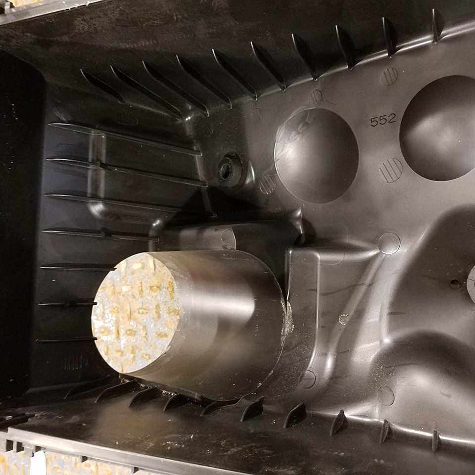

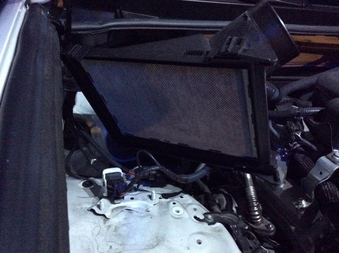

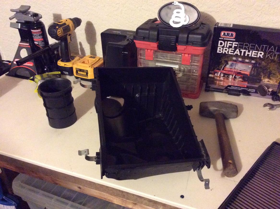

So I was seeing a bunch of people post stuff about a restrictor in the stock air box which was noticed when replacing with an aftermarket intake. I figured there had to be a way to remove it so I messed around with it tonight after work. Removed the lower air box, removed the water shield from the intake box, tapped the restrictor from the inside once with a hammer, fell right out. May have improved midrange power and it has a subtle throaty sound to it now. Not the sound of an aftermarket intake by any means but I do hear a difference. Only other mod is an AFE Pro Dry drop in filter. 10 minutes and free, works for me!
Now look what you’ve done..restrictor delete.

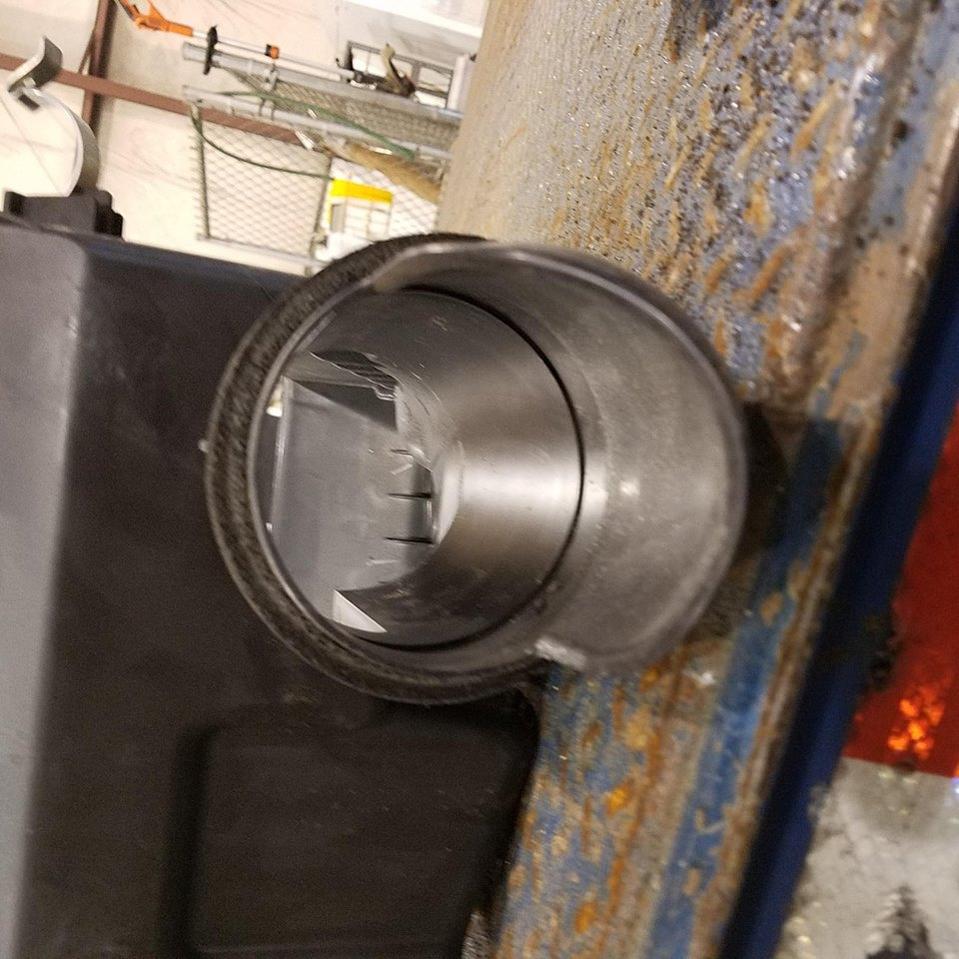

But what is this in pic 2? A pre filter I’ve never noticed?

lol that's what this group is all about! It's a carbon filter, I removed that a long time ago.
Let me know what your impression of the restrictor delete is!
Well the carbon filter went away and I cleaned the throttle body while I was in there. When I started the truck this morning it was definitely breathing easier as the RPM's shot up to 2000 rather than the usual 1200. That is proof enough for me that the restrictor had to go. The restrictor delete mod is butt dyno approved, as I noticed faster acceleration merging onto the highway this morning.

wow! just did mine in less than 20 minutes. Takes longer for me to fill up a tank of gas. Everyone should try this the next time you change your air filter. I kept my carbon filter intact but the restrictor pipe is worth a try. You can always add it back.
Curious what you removed for the "restrictor" ? Any more info? The Carbon Filter definitely restricts and needs to go
the same reason why everyone buys a 300 dollar TRD CAI kit, NOISE! I kept my carbon filter. I removed it in other vehicles and did not appreciate the smell of unburnt fuel
