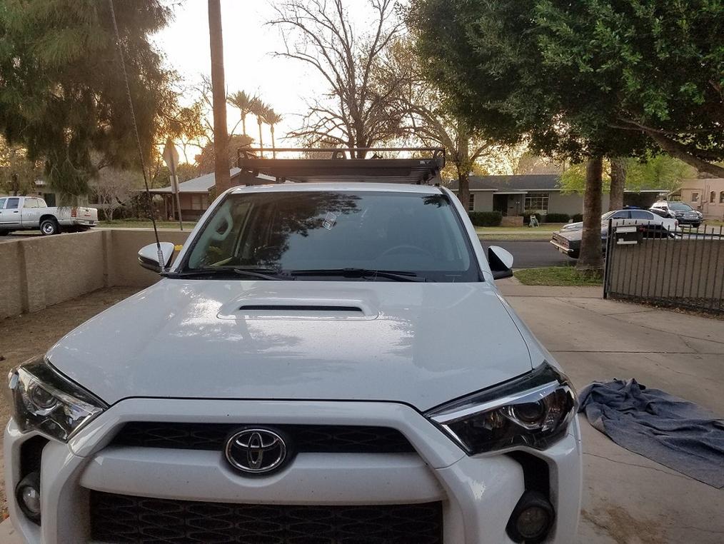

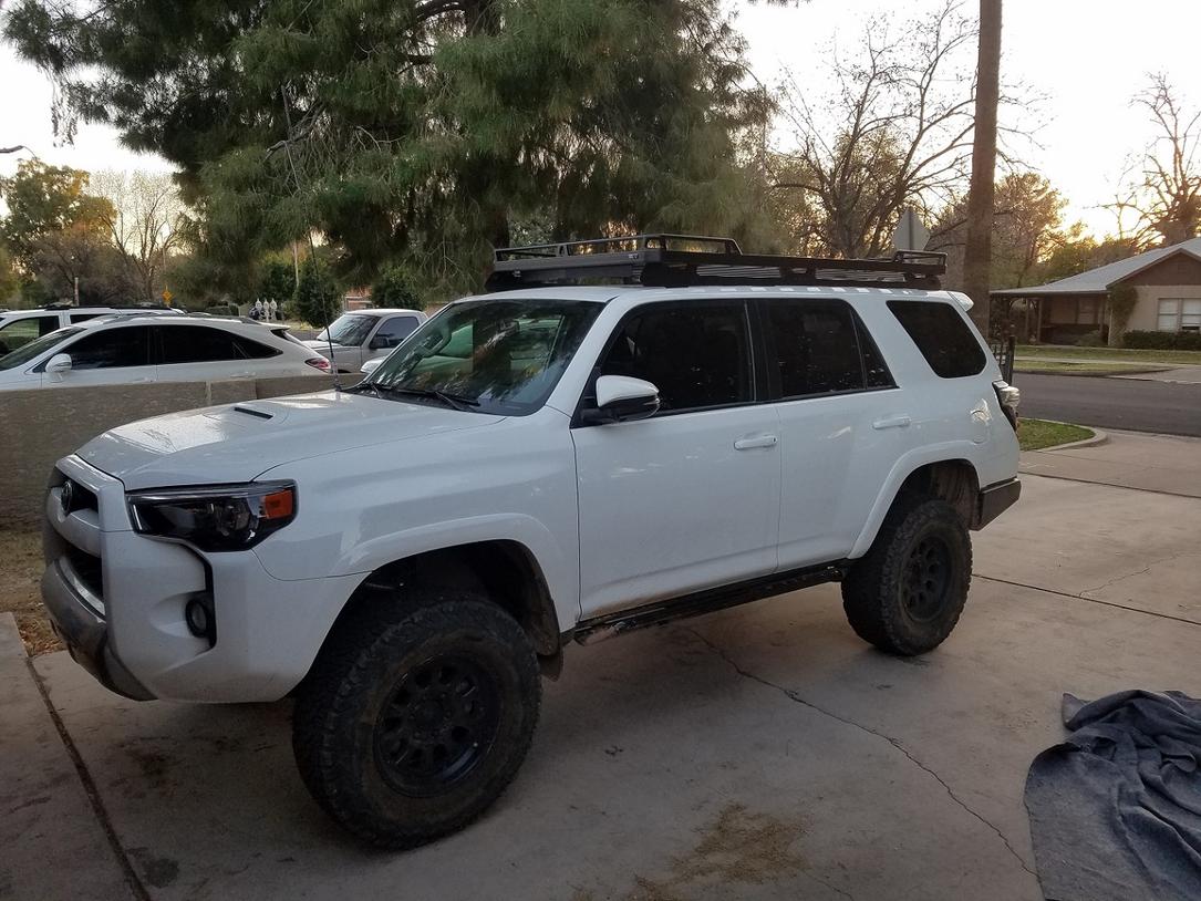

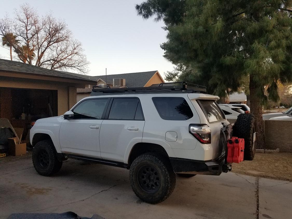

Installed a full Front Runner slimline II - Loving the rack, not so much the rails. install was easy once you got past the drilling part
Notes on install.
- an 11.5 MM drill bit for the rivnuts? Really? err okay it worked perfectly, just took a bit to find one online. Likely there was a standard size I could have used.
- Get a bit depth stop for peace of mind when drilling to ensure it doesn't get into the headliner
- measurements are in mm for the drill marks.... I do not have a tape measure in MM - just laid out the rack mount over the existing holes and marked where to drill
Stupid User issues (aka read first monkey boy)
- The expedition rack corners mean you can't take off the corners without removing the entire rack from the top. This is important as some attachments require using that slot around the top and/or bottom of the outside rail. Luckily the side rails have a pass thru for the nut. At first I was incredulous so I called them up and there is a way to squeeze a nut in there. Whew! or so I thought....
- When they say ensure the expedition rails do not move by using the shims, they mean it, use the shims provided! Mine would not move left/right but could rotate a bit and I though eh, it'll be fine.. NO they turned into noise makers the wind so I have to take the entire rack down. Because.. the corners will not come off (due to design) unless you pull the entire rack down. Ugh. I'll give it one more shot to keep them from howling, else they are coming off.
- MaxTrax must go on the front or back edge unless you purchase their side mount thing. Don't bother with the maxtrax pins unless you get that side mount thing. There is a youtube video on how to do this more cheaply.

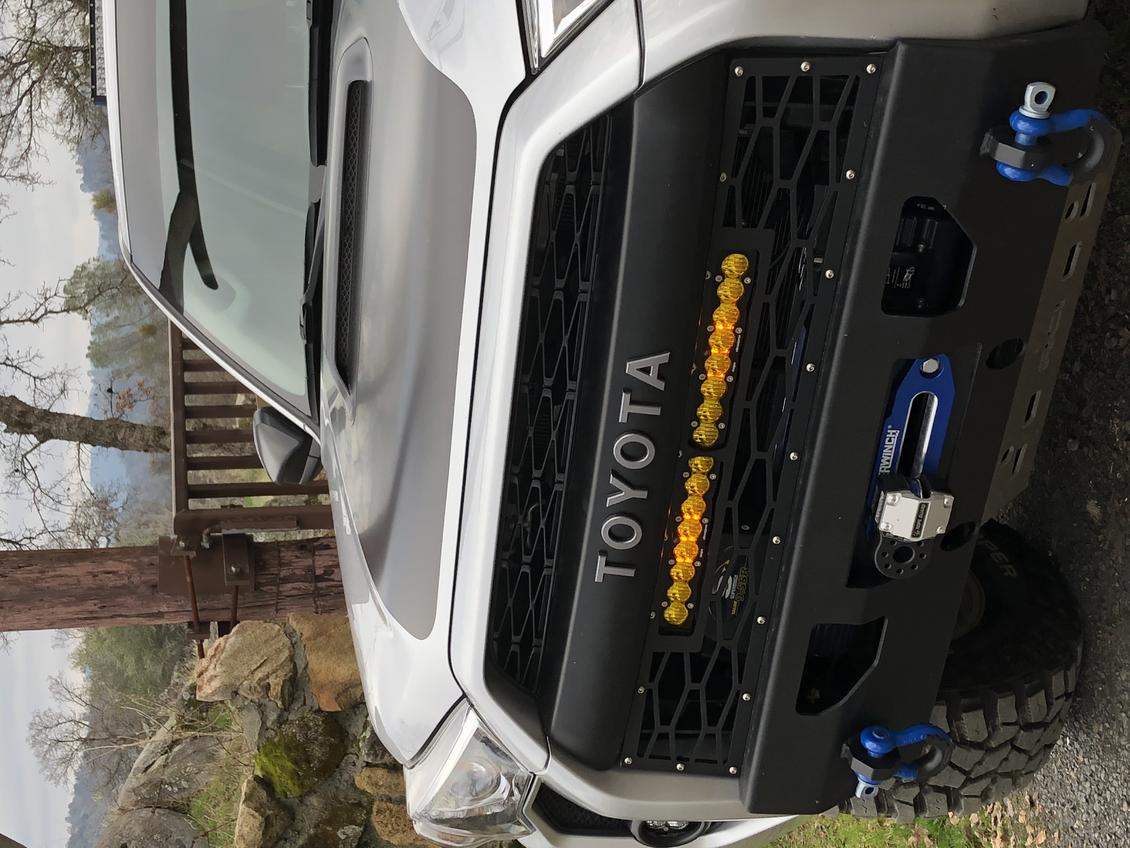

Added The Relentless Lo-Pro Winch Bumper
I love this bumper, the look and functionality...winch, tow points, LED light bar all integrated into one high quality solution. However I obviously need help with rotating the image...the file in my documents is orientated correctly. Also tried saving to desktop with same results.
