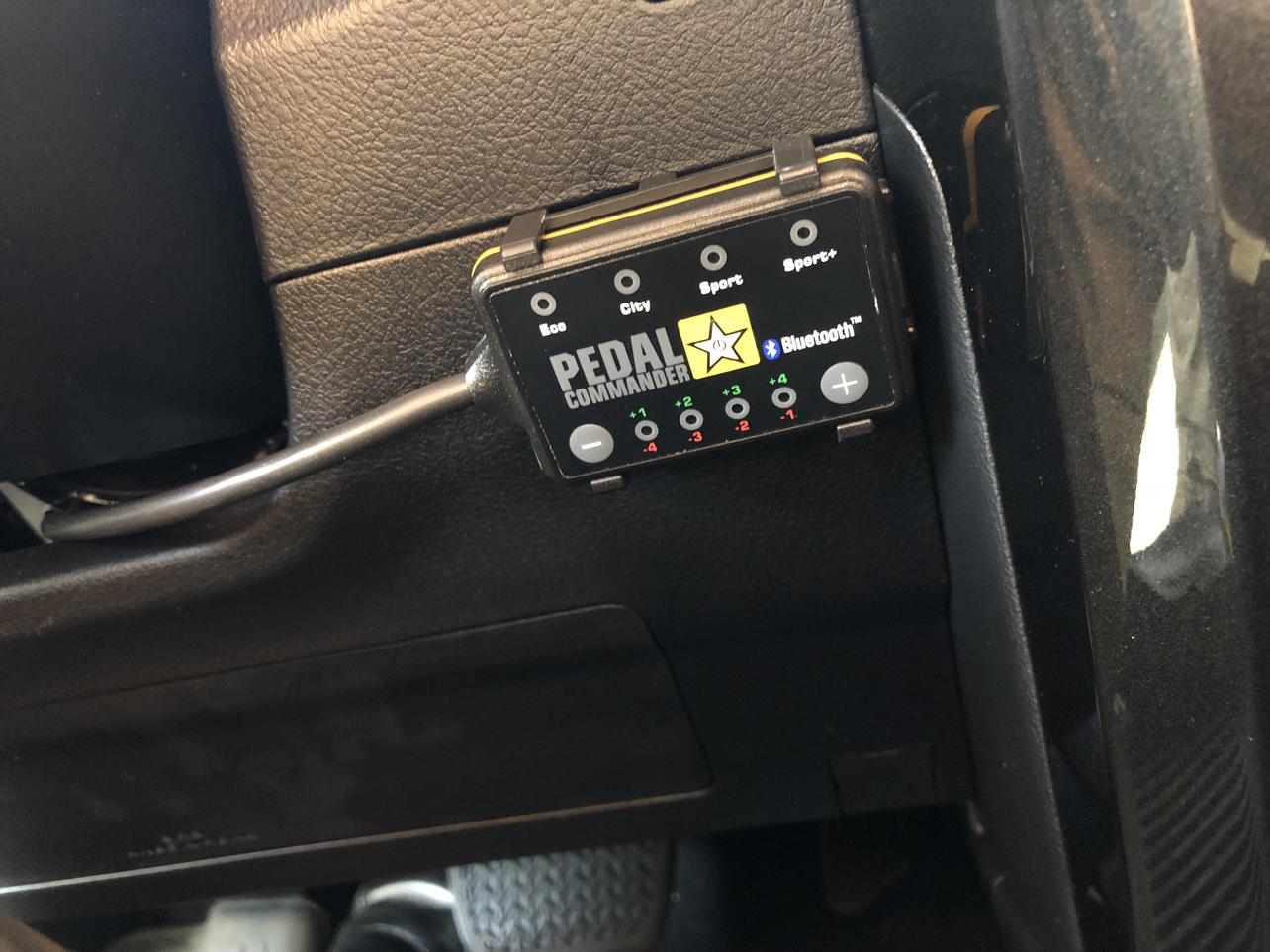

Installed my Pedal Commander! It’s niiiiiice!

I have mine istalled exactly in the same spot, does it fall off once in awhile? I cleaned the spot with rubbing alcohol before attaching, but still fell off sometimes. I cleaned the area again and put some 3-M double sided tape on it and no more problem.

I did not use the alchohol wipe. I put the hook side of the Velcro on the holster and the mesh side on the vehicle. No issues as of yet. :llama:

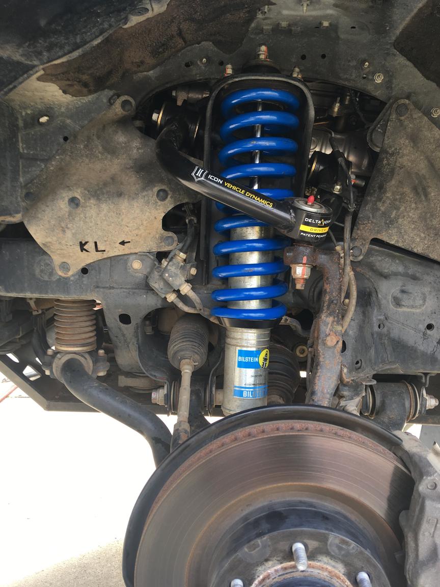

Swapped out the 600# Bilstein springs on my 6112's with some 650# Kings.
Got back the 1/2 inch lost when I added the C4 Lo Pro and Winch, plus an additional 1/4 inch, pretty much perfect. Ride is more controlled, but not stiff at all.
Bit of of "Mutt" of a front suspension setup, Bilstein Shock, Icon UCA, and King Springs, but it works pretty good!

I will be getting the LoPro and winch also. Ever want 700 lb springs instead of 650? I was planning on 700.
Cheers
Cheers
I went back and forth quite a bit trying to decide between the two. I don't think the 6112's are valved correctly for such a heavy spring. I think it would have been to much spring anyhow as my ride height is above where I started (before adding weight)with same spring perch setting. Was not looking to have too harsh of ride or lose flex off-road by having too heavy a spring. This works for me at 650#.

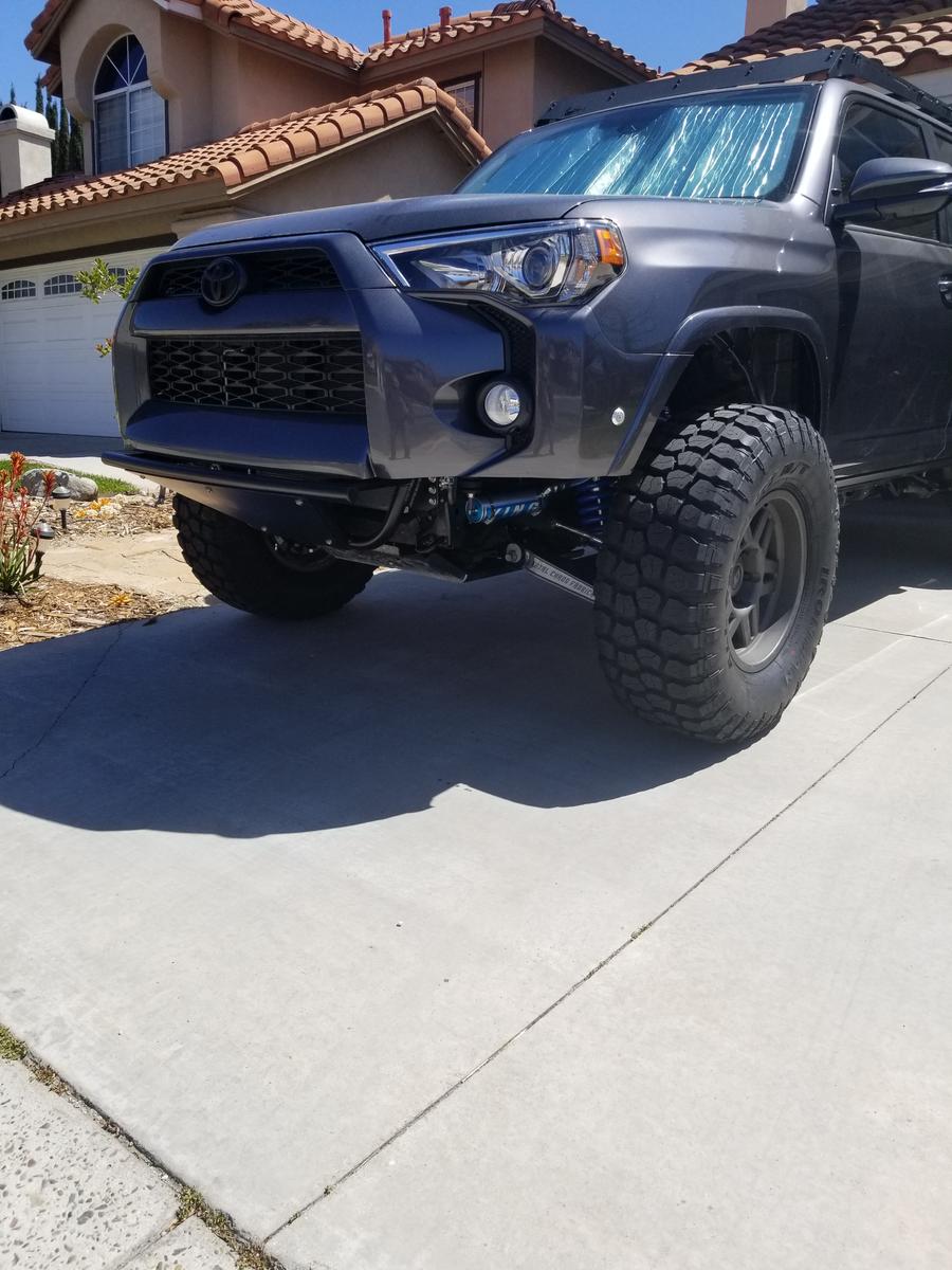

Do you have any other pictures and information of your front bumper and skid?
Bumper is a one off custom build (local guy in Huntington Beach built it for me)...went more of a "pre-runner" style route since it appears most of the pre-fab bumpers seem over-built and heavy.
What was the time frame on the install? Great job!
2 hours-ish at a non-break neck pace while watching movie playing in my garage.
