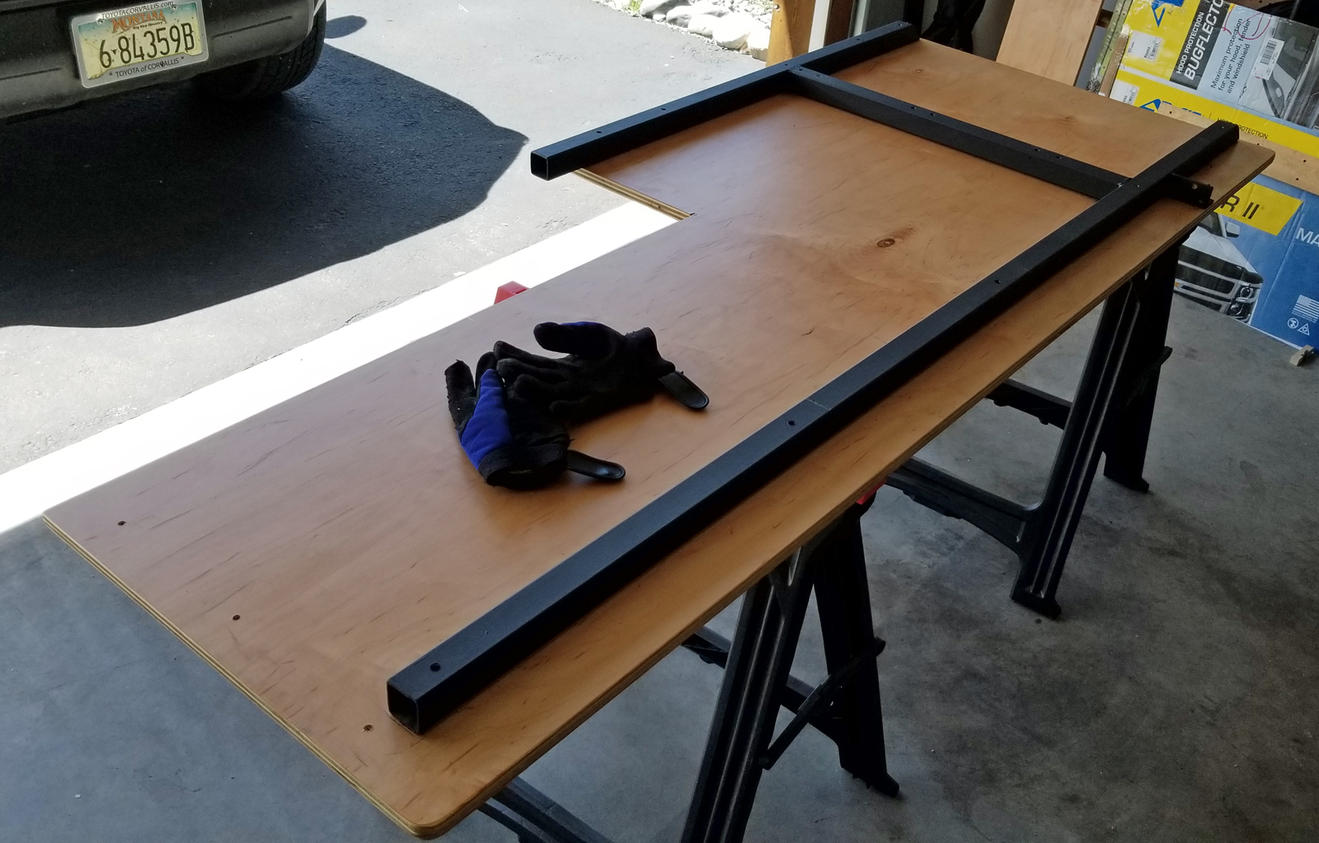

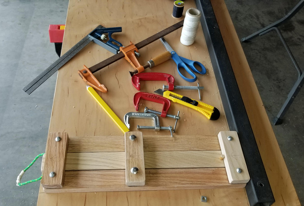

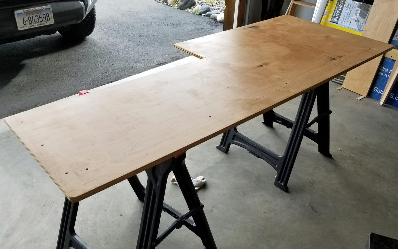

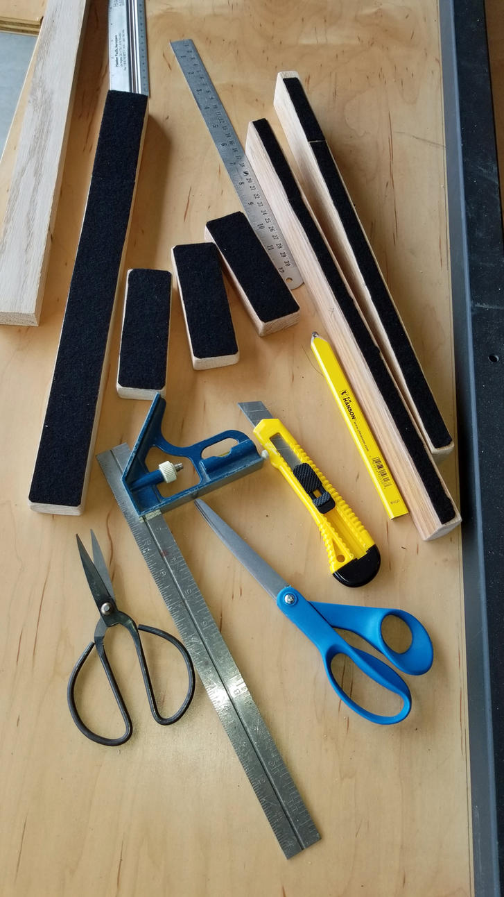

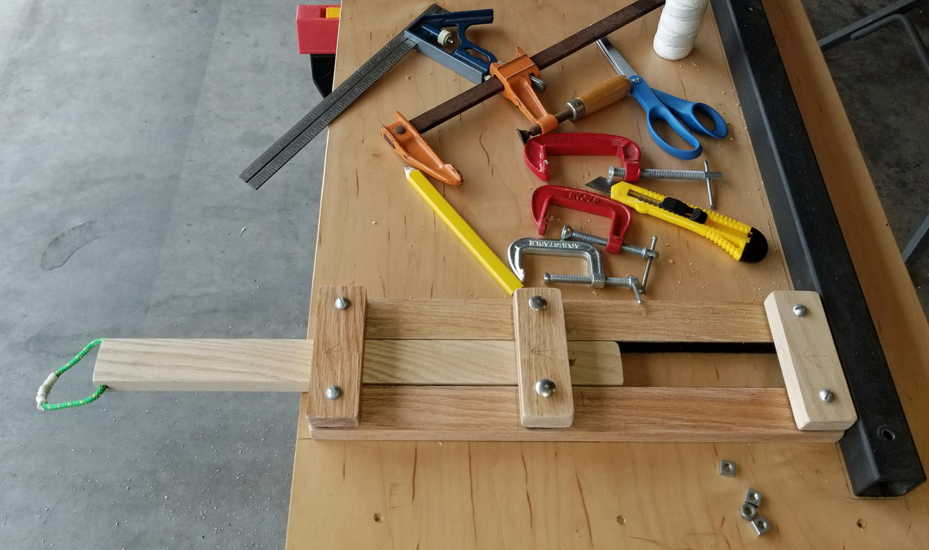

...More Progress On My Sleeping Platform-Part-2...
...Howdy, Again!
...in post 3318, I gave Y'all some pics of the bases for my sleeping platform...
...Here I will show ya the progress on the plywood platform itself...with additional support from welded steel parts....
...The platform is in two pieces, hinged in front on the driver's side so I can still open my console when not sleeping...plus it gives my right arm more room so I am not crowded by the platform while I drive....
...To support the 'wing' that is hinged, when closed, I devised and built a sliding wooden brace made from oak up near the front...and had the metal support beam in the rear extend forward 3 additional inches past the plywood to hold up that end...
...I have included some pics of the development stages...added adhesive-backed felt to all the sliding surfaces...to keep the wood pieces in place...and to keep them from rattling annoyingly as I drive around!....
...( the bolts are just temporary to hold pieces in place for now...All parts will be bolted together with nylon locking-nuts in final assembly )...
...The steel supports also include a small attachment to bolt to the rear seat back metal bracket that would normally hold the seat-back in position...I had the fabricator build this to give extra lateral support for the platform....
...figure might as well use what is already existing in the vehicle to keep the platform in place as much as possible, ya see?...
...I gave the 3/4" maple plywood several coats of polyurethane-sealant to protect the wood...keep it dry...keep it from swelling in the heat and rain....and give it added strength....
...Also gave the garage-floor some sealant when I dropped the quart can....mostly still full..while trying to clean up the rim after the last coat!...DOH!...%#@!&*&^%$%!!!...
...Here be some pics to hopefully explain it all betterer:
