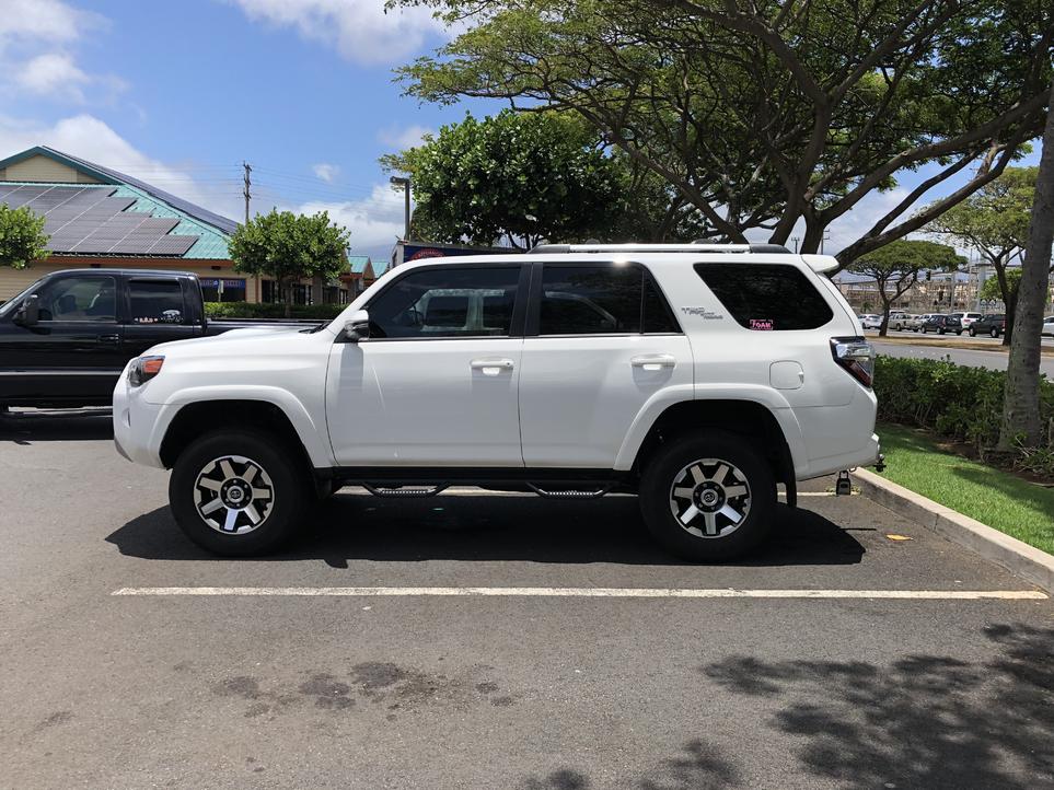

Bilstein
Couple days ago
Bilstein 5100 front and read
Daystar spacer rear
Wheel alignment

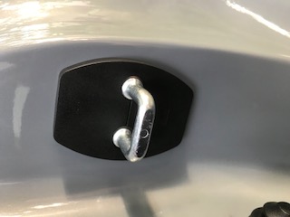

installed these mega expensive latch covers (I think all of 2.00 with shipping). no adhesive, they snap on
Such a simple thing can make such a big aesthetic difference. Would be a good idea to put a little grease back there just to avoid any standing water from causing rust. Do you have a link to them?

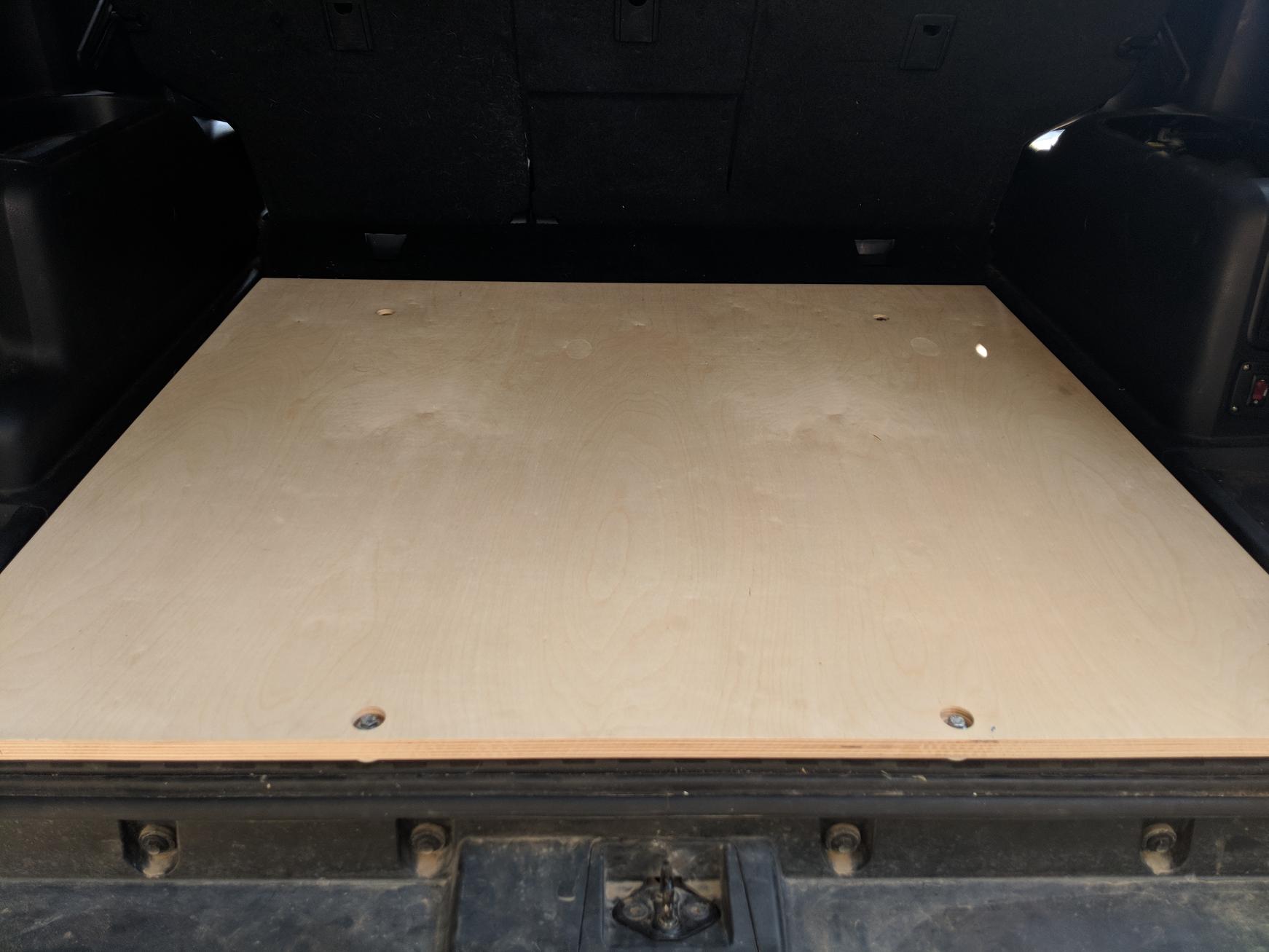

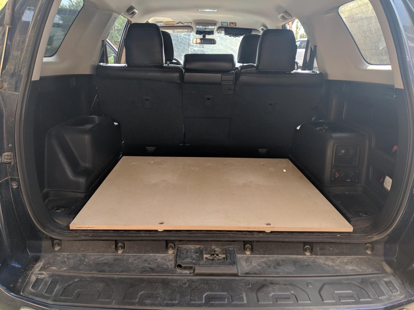

Worked on my "don't call it a goose gear" rear platform. Used 3/4" Baltic Bird plywood. This is the second iteration. Will put some herculiner on it to finish it. Still deciding how I want to proceed with this. Most likely going with the ATOverland Combo Slide and not sure if I want to do a single drawer or just go with L-track and Alu-boxes.

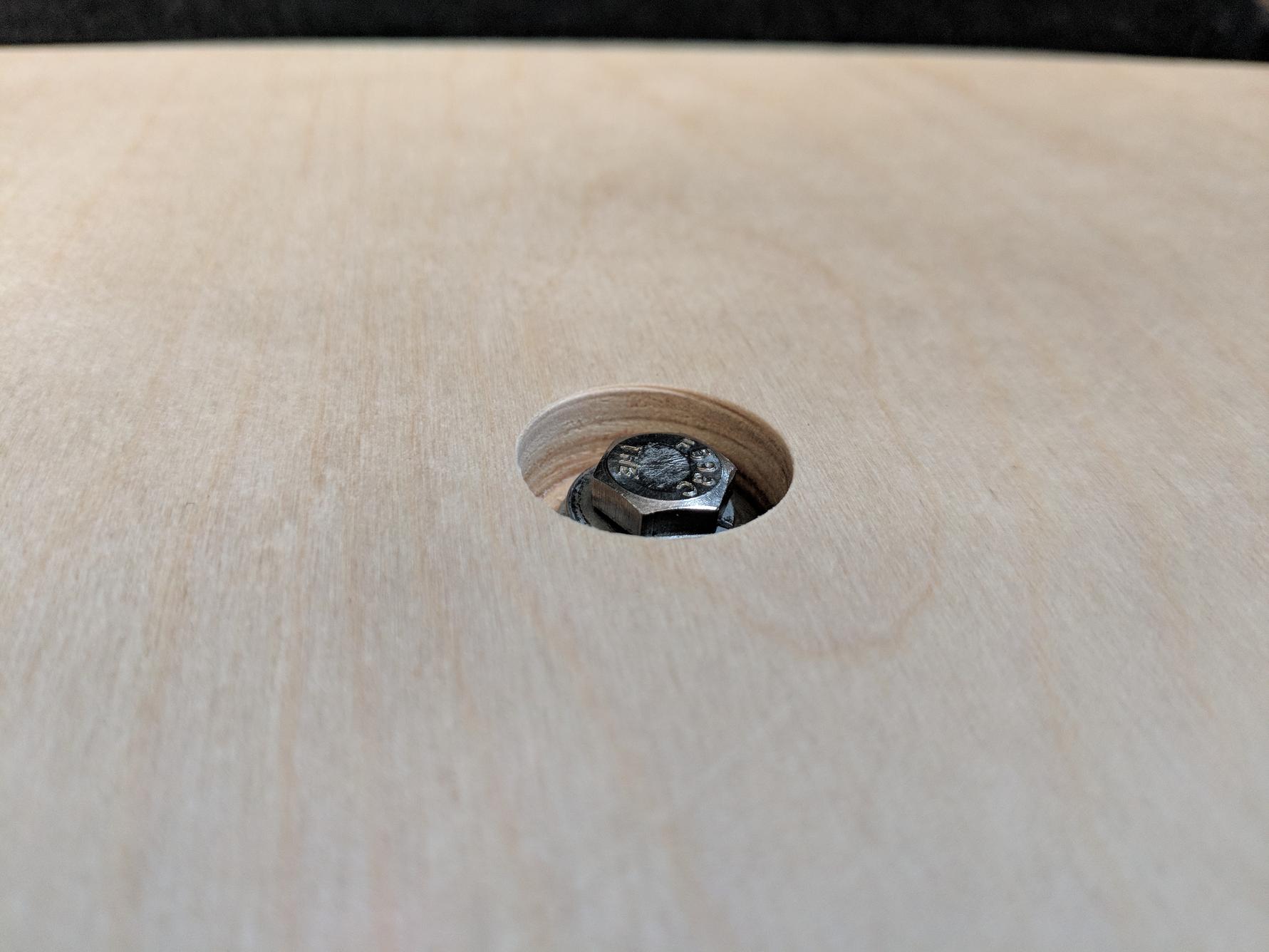

The platform is mounted to the rear cargo area using rivnuts. If you remove the carpet there are holes to insert some rivnuts. In the front there are some factory spots you can put them in and in the rear I lifted up the plastic panel and removed two of the white clips. Then opened up those holes with a drill big enough to insert 1/4-20 rivnuts. Drilled a hole over the top of the plastic trim enough to insert the bolts. I used some nylon spacers between the trim and platform to keep it level once you tighten the bolts down. Its solid, no movement, wiggle, or rattling.

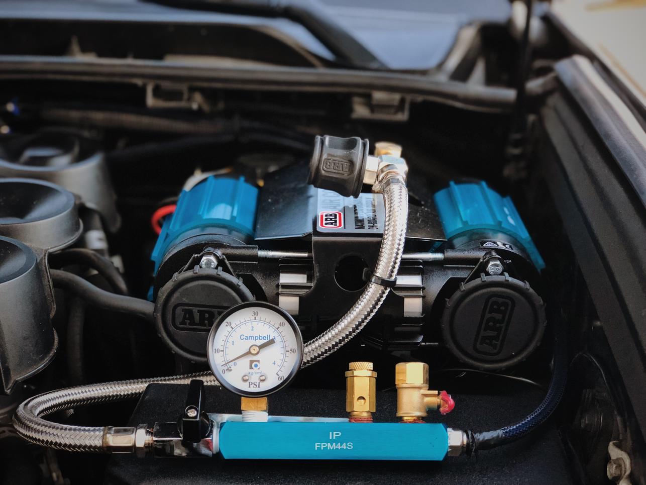

Put together an onboard air system. Saw that they make these for JKs so built one for my 4Runner. Hoses route from the manifold to all 4 wheel wells to inflate and deflate at the same time.
