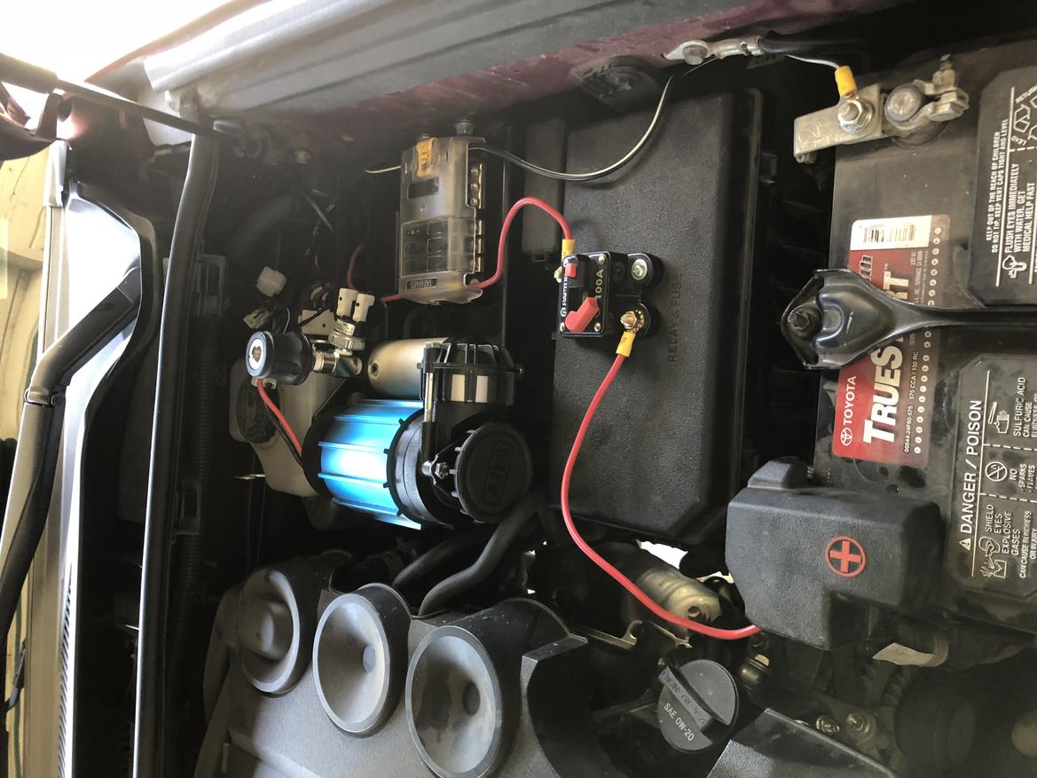

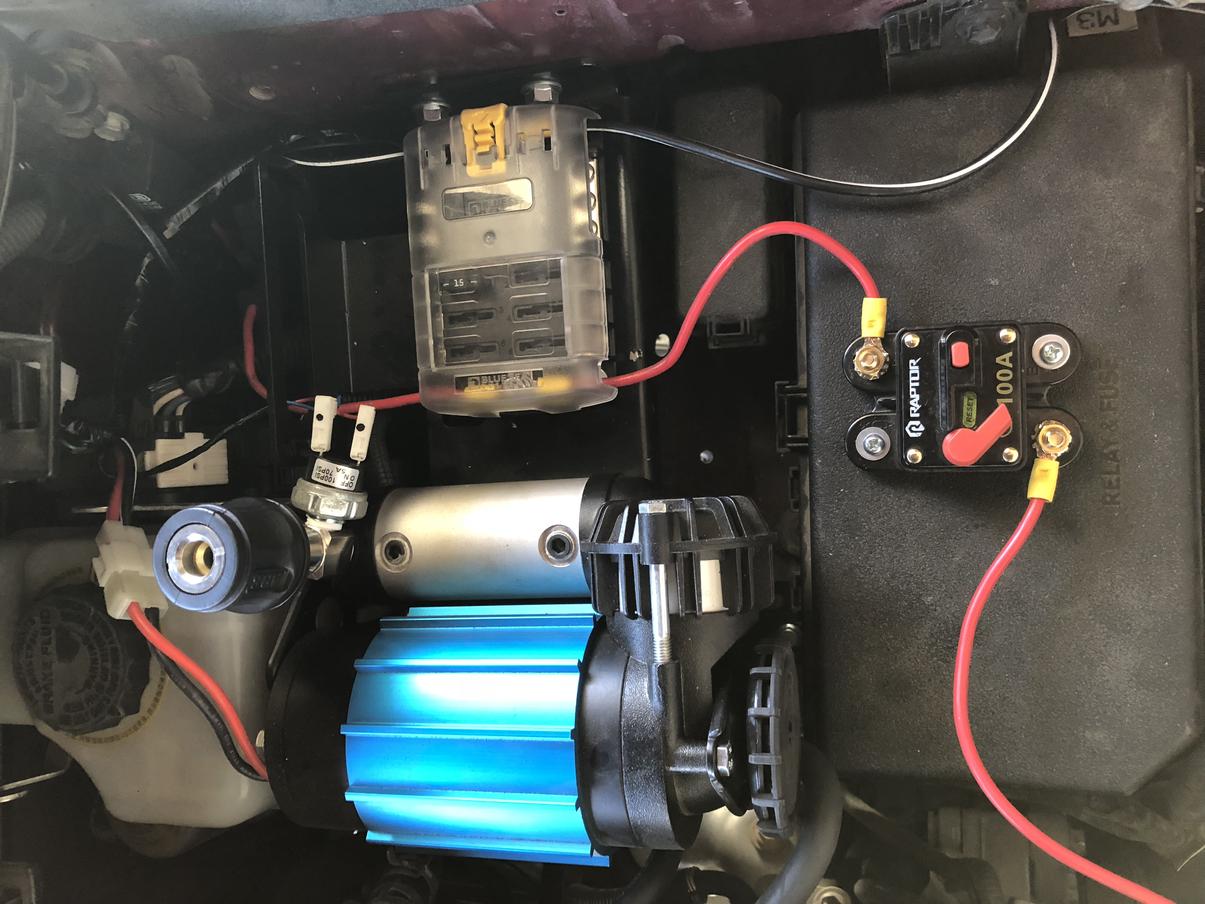

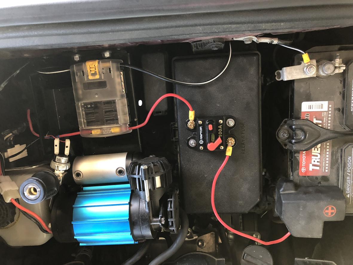

Just hooked up the blue seas fuse block. Decide to upgrade battery to a northstar 27f that will arrive in mail by Monday. I did the wiring today so when battery gets here plug and play. Going to run 35L dometic fridge and the ARB compressor of this. Let me know if you see any mistakes I’m no electrician just went of something I saw on here
What bracket did you use for your compressor install????
Why the 100 amp breaker on cable good for about 30 amps tops? That wire will be on fire long before that breaker trips. Either upgrade the wire or install the proper breaker for your application.
My buddy gave me the fuse block and the breaker like I said I’m no electrician what amp break should I get or what gadge wire should I upgrade too? This word I hooked up was from arb compressor wiring was to long so I cut it and thought I could save some money by using it for fuse box
If you don't know anything about electrical then I would either get a pre-made kit or have it professionally installed. Electrical is the one thing that you want to have done properly. Not doing it right could be disasterous because you could short out a wire and cause a fire. The wire you're running from the main battery to the Blue Sea looks to be a 16 gauge wire. There is no way in hell you can carry enough amps to power an ARB compressor and fridge running off that thin of wire. An ARB compressor is rated at 25A. The dometic uses about 3A. Add more for any other accessories. A 16g wire can handle about 12 amps total. You do the math, it doesn't add up. Learn and it do it right or have it professionally done. Unless you want to cook the 4R, yourself, or your family.
Thanks I did see the amps it uses. The wiring harness that comes with compressor has a big yello fuse and it’s a 40 that what number is in the fuse.
That wire from the harness it came with I just cut it and wired up to fuse box so I’m guessing since the wire has a 40 fuse maybe it can handle the fuse box also. Do you think ot will be ok if I change the 100 amp breaker to a 40 amp would that be ok I’m not going to run anything else other than the fridge and compressor?
No because the wire you're connecting from the main battery to the Blue Sea ST Blade is embarrassingly thin. You can keep the 100A breaker and upgrade to a 6 or 8 gauge wire going from your battery to the ST Blade. Do not reuse wire from the ARB kit.
Also what is that other wire that is hooked up to the main pos/neg connector of the ST Blade? Where is that coming from?
Will upgrade wire then I have 6 gauge wire just need to buy the tips to connect the battery to fuse then fuse to fuse box
I connected the air compressor to the negative and positive of fuse box since I thought the compressor needed more power the fuse box
