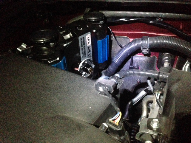

Added oba! :bounce: Currently tankless, we'll see it is stays that way. I ditched the second battery idea for now (stupid 2013 clean air thinga-ma-jig in front of my air box is pissing me off) and when with this, where I wanted to drop a second battery. Built a bracket, soft install, wired, and tested. I need to tighten it all up tomorrow, tuck the wiring, and decide where I want the switch.
You know what that OBA setup is begging for? an aux battery :bolt:
Pix of the bracket if you don't mind sir! This is my next mod for sure because spending an hour to air up is getting old quick :tape:
Sure, I have to pop the compressor off tomorrow I'll snap a pick or two. It mounts to two of the factory studs.
LOL man I have beat myself up thinking where to put this so I could fit a auxiliary battery (even considered under my seat), there is just no room in the engine compartment since they added that stupid air thing. When my current battery gets closer to death I'll just drop in an Optima 31 deep cycle, and keep my jump pack in the back. I know I could benefit from the extra juice, I keep it in mind for sure, after suspension upgrade comes bud built hidden winch mount and a puller. :)
