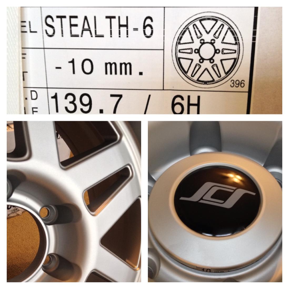

Didn't really do this in my 4Runner today but it's for my 4Runner!
These won't be on until closer to the end of summer, but here are some pics. I can't say how great Vin ([MENTION=88453]SCSPerformance[/MENTION]) was while going through the ordering process. I only wish I could throw these on sooner!

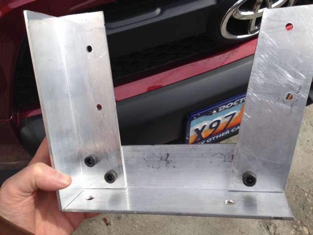

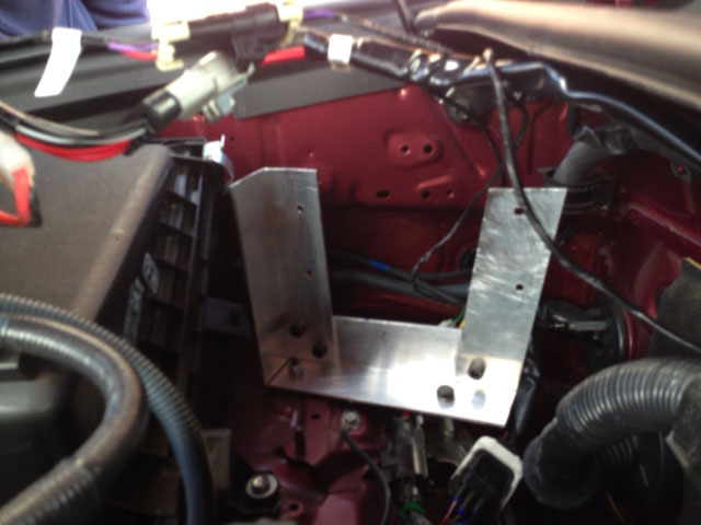

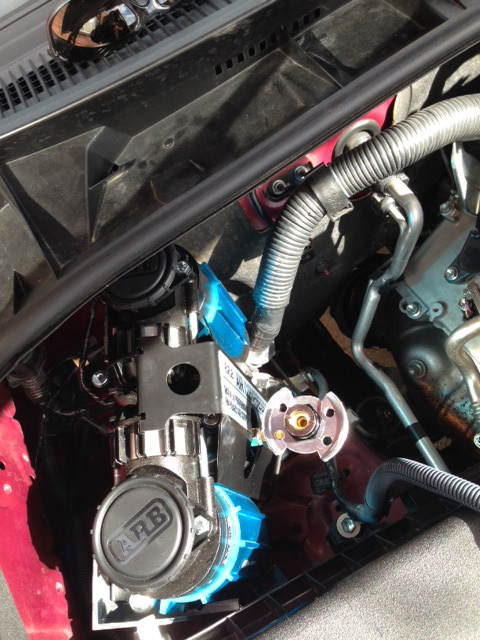

Finished today, tightened it all up, plumbed it a bit more user friendly, wired to only work with ignition on, setup up a switch in the engine compartment. Man getting a lead through the factory firewall grommets is a bit of a PITA init. Sorry not shooting with a nice camera, it is what it is :noidea:
You know what that OBA setup is begging for? an aux battery :bolt:
Pix of the bracket if you don't mind sir! This is my next mod for sure because spending an hour to air up is getting old quick :tape:
and Bracket pics...
NOTE: Not shown but I actually elongated the bottom compressor mounting holes to get a little bit of leeway, making bolting the compressor on blind a bit easier.
