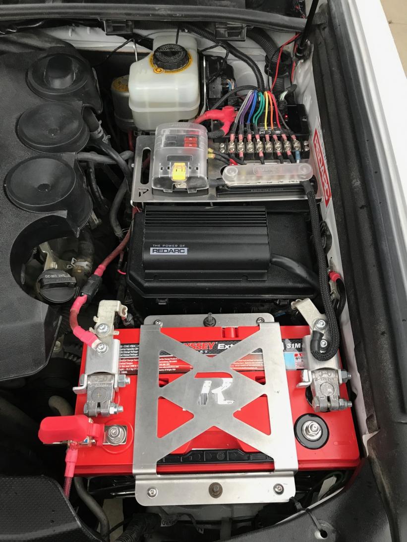

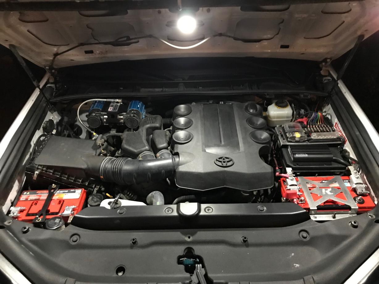

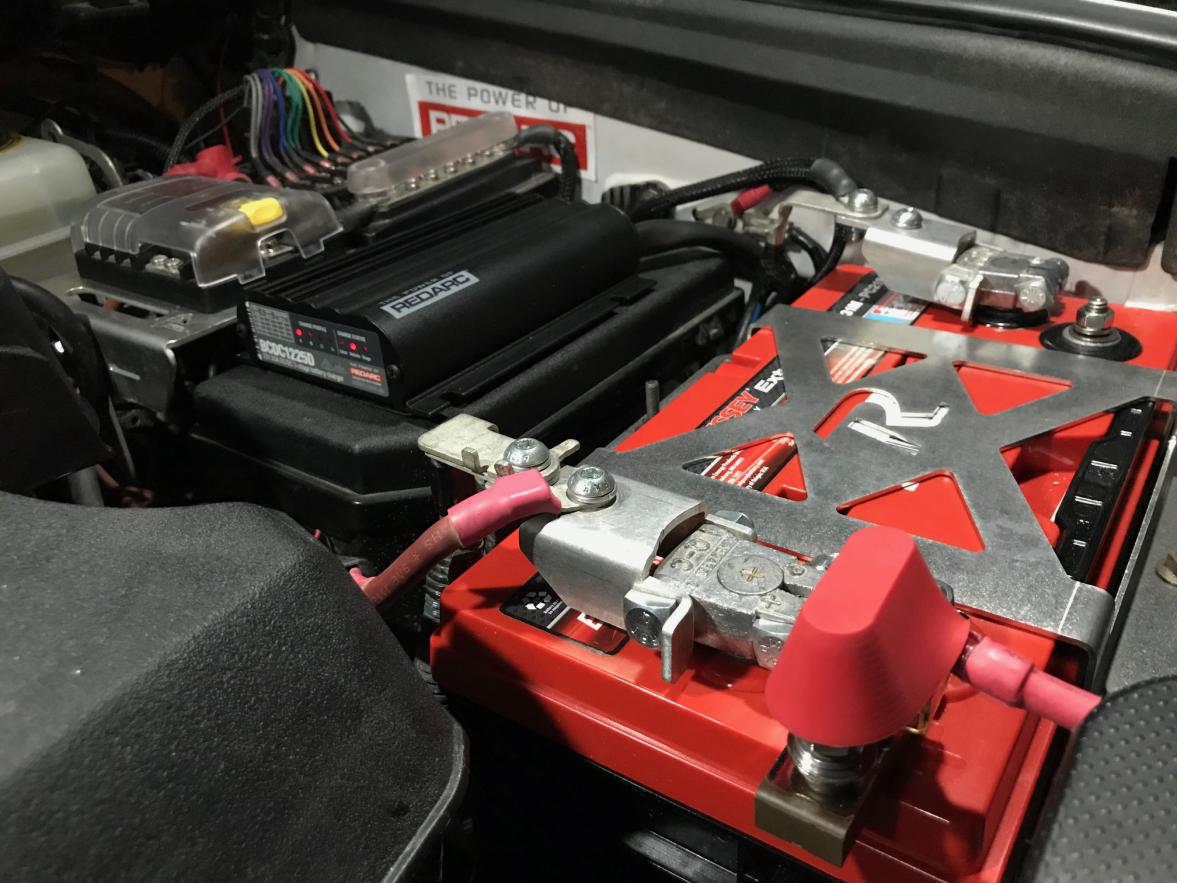

Not today, but finally installed my dual battery set up. Pieced together parts based on my needs. I would have gone with an offgridengineering setup, but decided to tackle it myself and learn something. Bought a few crimping tools and built my own wires. Definitely learned a lot about electrical sizing and capacity.
Still need to clean it up a bit and finish wiring the fridge and inverter on the inside. Solar is in the near future. Probably do a fuse block in the back cargo area to allow future expansion (ham radio, other electrical needs). Big thanks to fellow members for all the help and inspiration. :yo:

I can’t tell for sure from the photo, but it seems like you installed the auxiliary battery in the same orientation as the primary one. That is, the positive post is on the left side of the battery case. If so, that’s not a good situation because it’s next to the frame (electrical ground). An accident or jolting during off-roading could possibly shift the battery toward the frame and cause it to short out making a bad situation worse.
It would be better to rotate the battery 180 degrees to place the negative post next to the frame.

Just confirmed aux battery posts, (-) on the left and (+) on right.
Thanks for looking out!
What did you use for your terminal post extensions? Those look nice!
The battery terminal extensions are from Slee Offroad. They're sold separately from their dual battery kit. These are a bit pricey ($50) but i thought it looked cleaner and was way easier/safer (IMO) than trying to redo the engine wiring.
