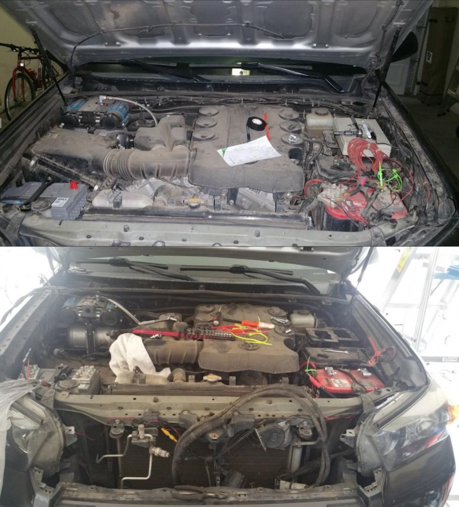

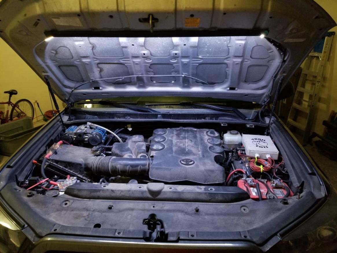

finally finished up some much needed rewiring under the hood after I added the second battery. All accessories are wired up and re routed some items and installed the ML-ACR and the OffGridEngineering Switch harness.
I am pretty happy with how it all turned out. Pictures below go from start, to middle, to end.
*Only recommendations that I have are 1) to buy the blue sea gear from OGE and NOT amazon (I ended up wasting an entire afternoon troubleshooting an amazon dud THAT ARRIVED USED) and to plan to get the wiring laid out for ALL future mods to avoid doing what I have done and adding along the way only to perform a major tidy up reroute at the end of it.

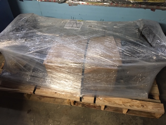

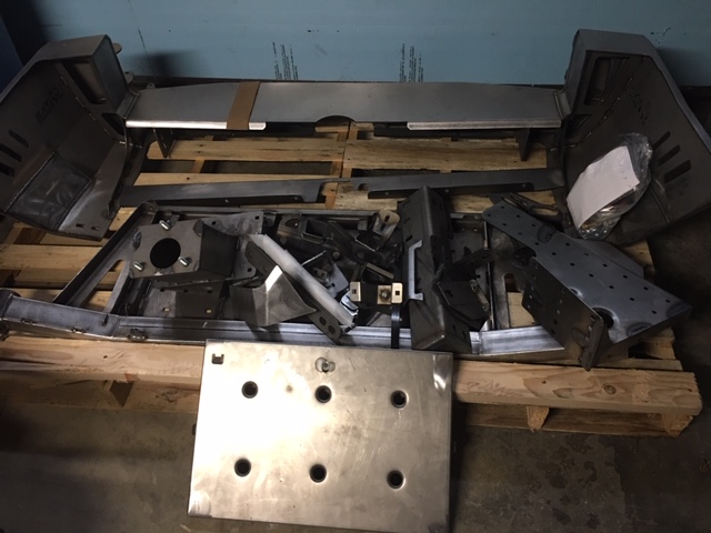

My C4 FAB rear swing out bumper arrived, I unwrapped it to marvel at the craftsmanship, now off to get powder coating

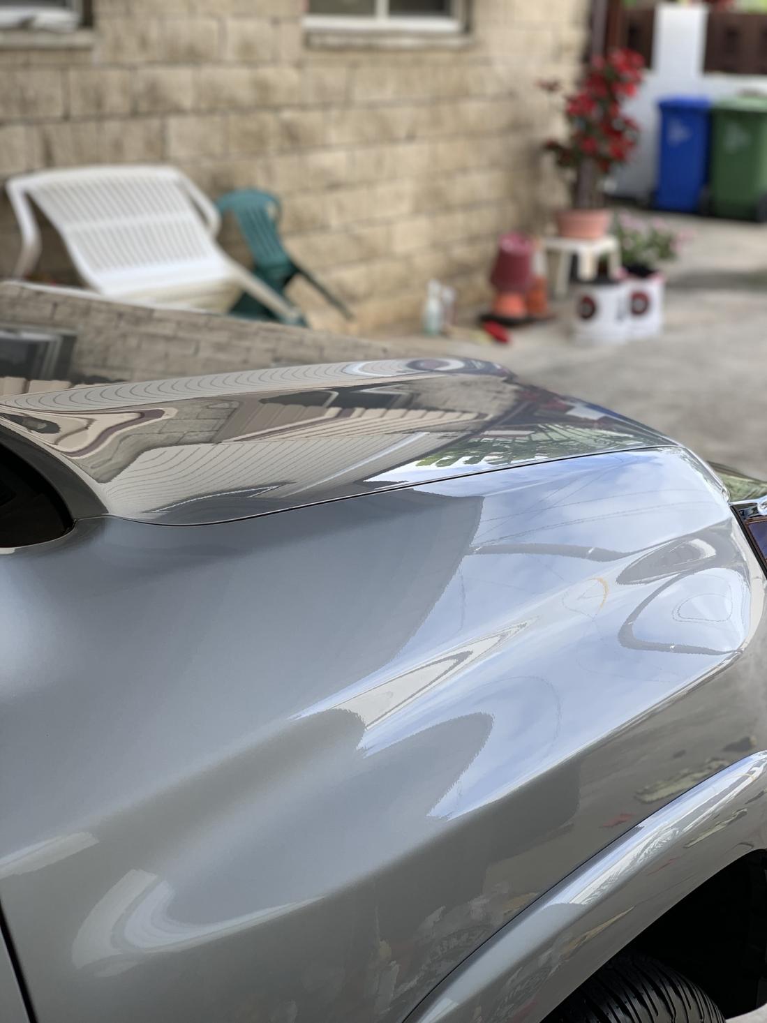

Ceramic coated the 4Runner today. Only pic I was able to upload tho. Made coat with Kamikaze’s Miyabi followed up with their ISM. Two coats to the wheels with their stance rim, and used leather shield for the interior leather! Came out beautiful

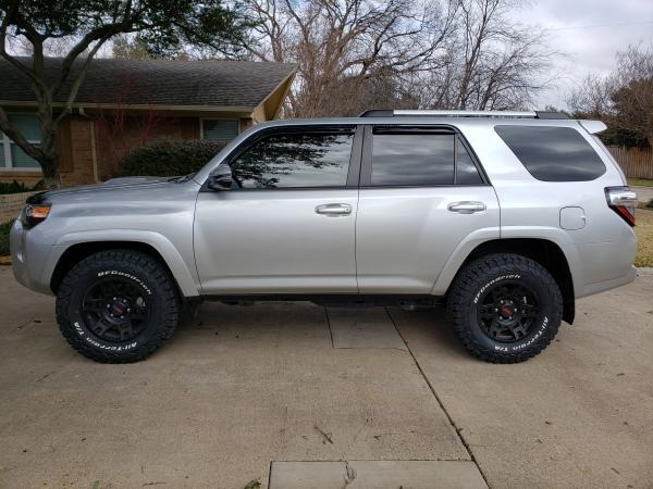

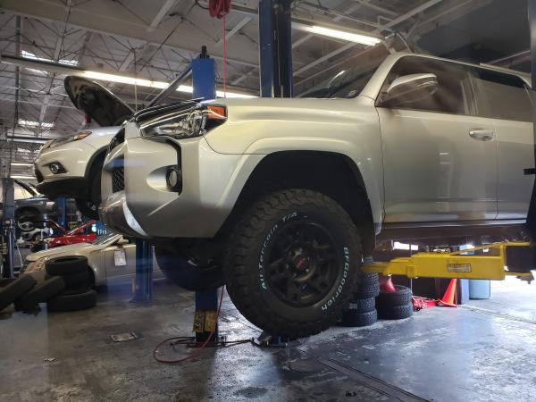

New Shoes (aka BFG's)
Picked up this certified used 2016 Trail Premium on Jan 12, 2019 - and have done a bunch of tiny things since then (see Garage link below), but this is the first I've done to it that really makes it start to stand out :)
-- Suspension coming next (not sure when since the Bilstein 6112/5160s are both on back order)
New BFG 275/70/17's installed today...

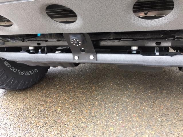

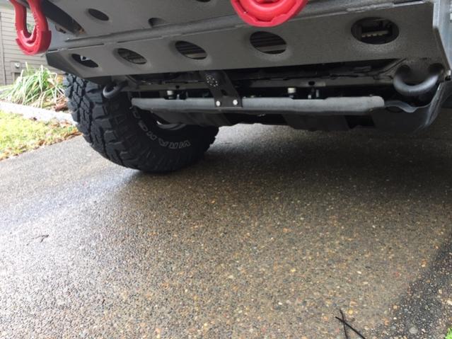

Installed a Summitview rock camera underneath front bumper so you can see over the edge of a drop off or rocks you might hit etc... running into the extra video input of my Kenwood headunit.
I went and bought some universal bracket at the local farm store, cut it down drilled some holes and bent an angle into it. I didn't wanna drill into my freshly powder coated bumper so i figured this was a good alternative. and easy to change or modify like when I get better skid plates later.
SummitView™ Rock Camera from Brandmotion

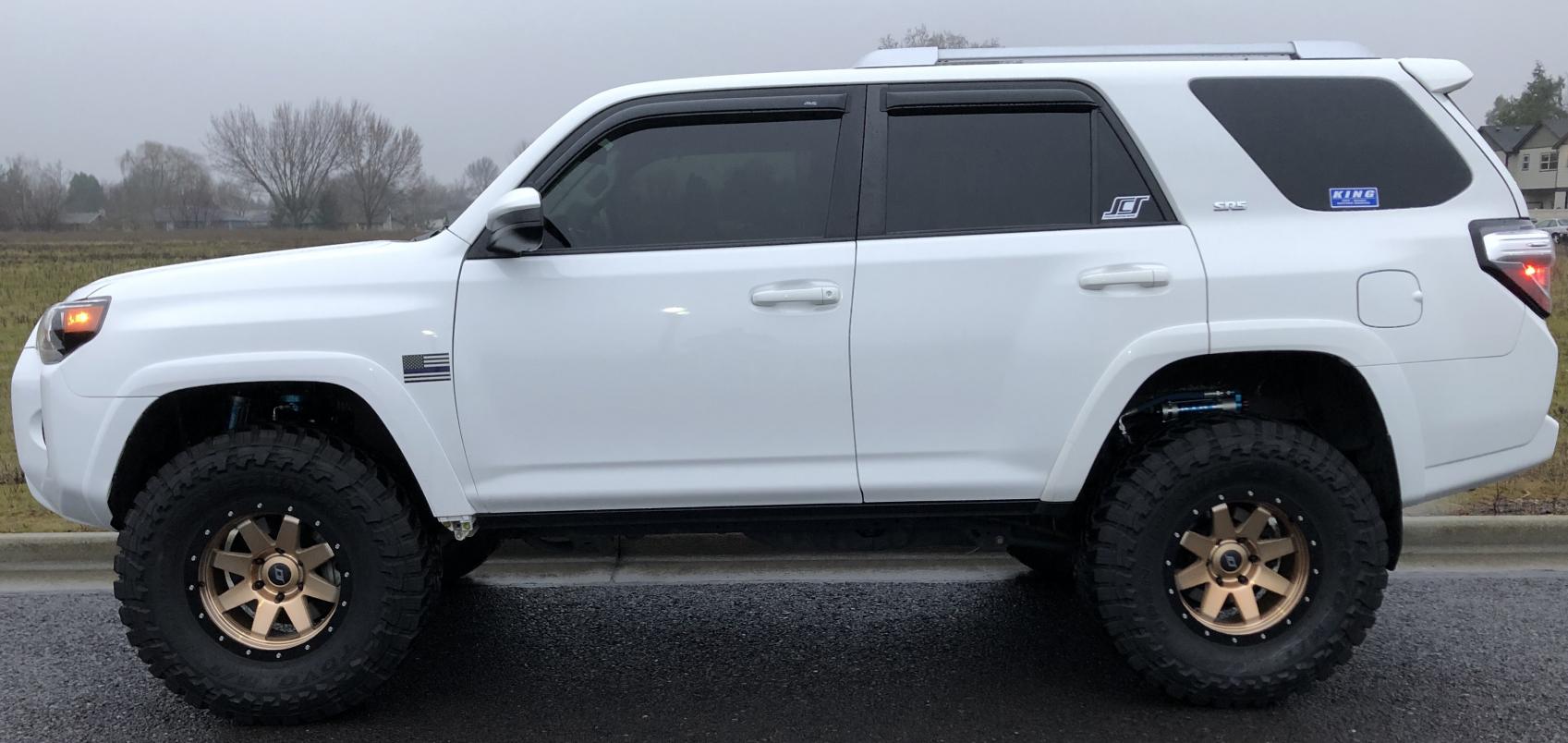

1.5" lift, 295/70/17 Ridge Grapplers which measure a true 33.5x12 on a 17x8 wheel. Fender liner mod, no BMC needed, no rubbing. Use the correct size bump stops to limit up travel. Your down travel is still there which is all you need. This is assuming you play on the rocks. If you play in the mud it really doesn't matter. Lower COG, better driveline angles, it's a no brainer.

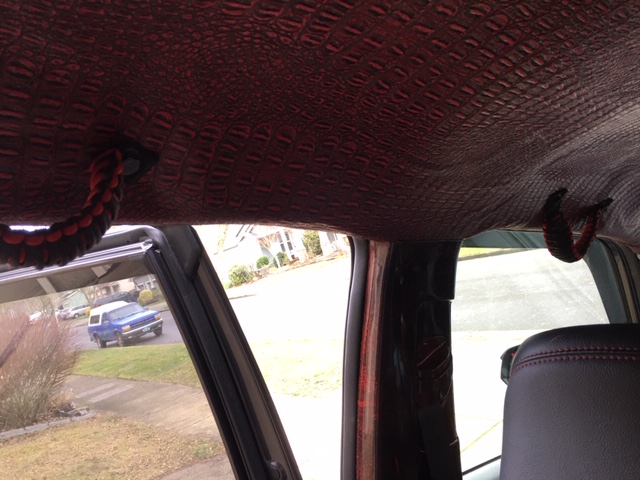

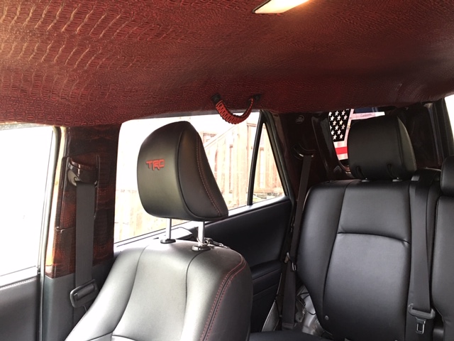

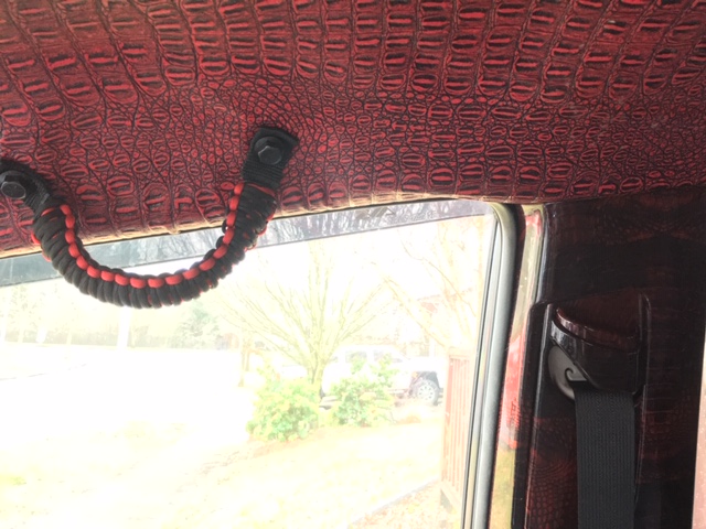

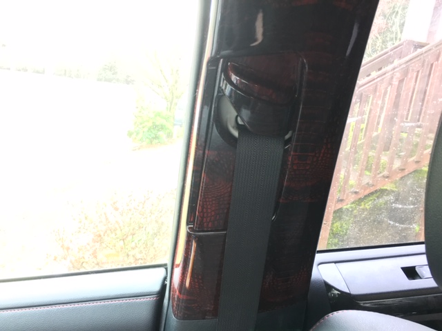

Interior is starting to come together, got some of the plastics back from hydro dipping and I installed paracord grab handles in place of the factory plastic ones. Love the handles they are so comfortable to grab onto. But those handles were the hardest mod I've done yet.
