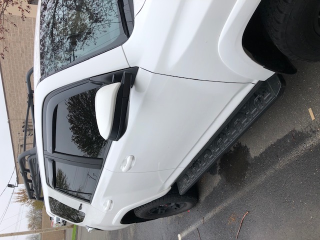

Nothing special, but put on the AVS ventvisor or window deflector...whatever you want to call it.
