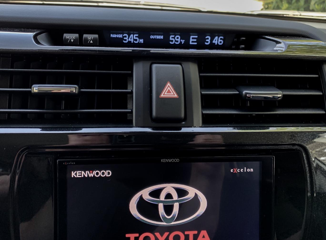

Did Old Red’s Accessory Meter Display mod to my 2017 Off Road.
This is great!

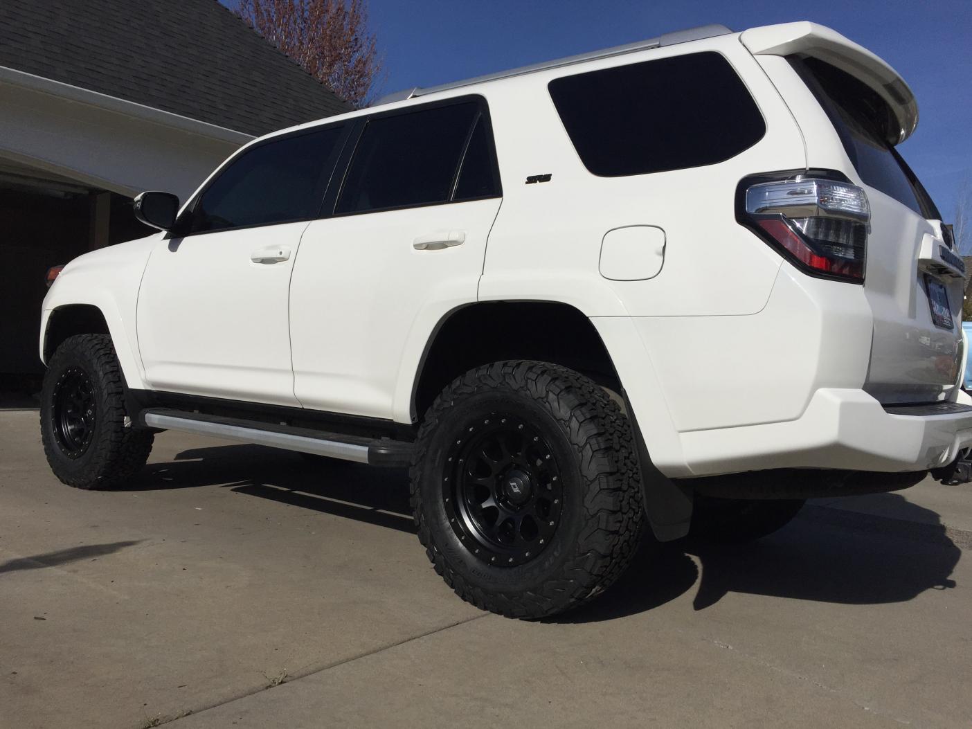

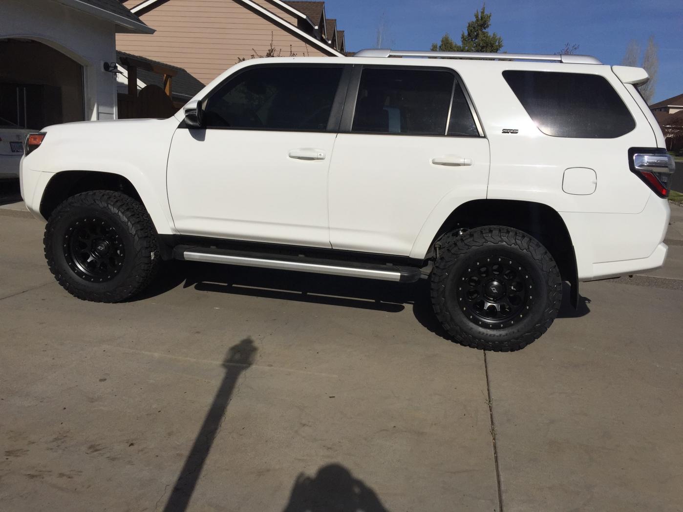

I installed Bilstein 5100’s (set to 1.75” of lift) all the way around and 1.5” Daystar rear spacers. 285/70/17 KO2’s will get thrown on Monday.
Installed Icon stage 1, spc uca, rays 10 and some 275/70/17 ko2’s. Rear needs to settle then I’ll check the rake and adjust the front still a little if I need to. Going to drive it a week before alignment. Only a slight rub on the mud flap at full lock in reverse and I’ll wait until after alignment to deal with it.

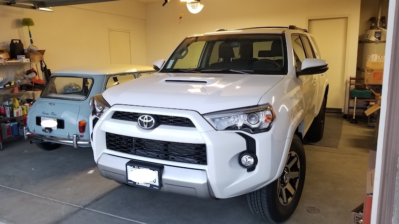

I brought it home from the dealer and tucked it in the garage for the first time. Let the games begin!
How does that affect wind noise on the highway and around town?
I ran it 24hrs without the wind deflector and it HOWLED above 35-40mph. Installed the wind deflector and now I would almost swear it is more quiet with the sunroof open than it was stock.
