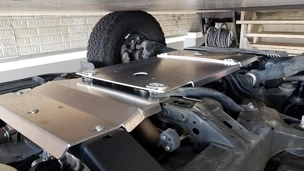

Did my skid plate install...seems like the tranny is a little louder than before, did you notice the same thing? Here are my pics of the install. Not entirely sure as to why they're upside down...will have to post new pics tomorrow.

You didn’t install that correctly in the pics. There shouldn’t be a gap

It's installed wrong. The transmission and transfer case skid should sit flat with each other. You installed the crossmember support brackets between the two which is why there is such a big gap. It should go transmission skid --> transfer case skid --> crossmember brackets. Probably the answer to your noise.

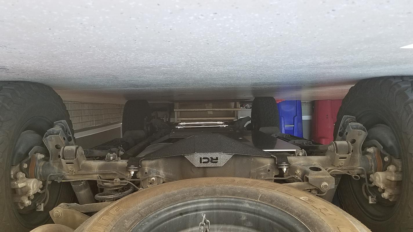

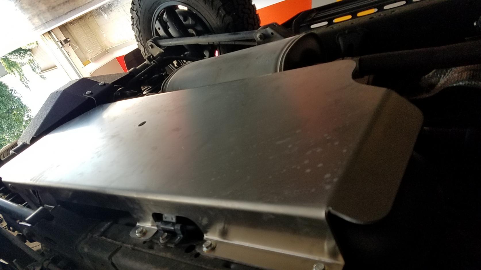

Speaking of skid plates - I banged the hell outta mine this weekend. The boat launch at Takhlakh Lake was hella busy and I was more watching the 13 cars all moving around me and less looking at the *GIANT* rock directly in my path. I managed to high center myself on it and had to have a friendly camper give me a yank. I sure felt like a pretty big idiot. The 20 people standing around watching were pretty impressed with the lack of damage - any other car there would have lost a bumper and cracked an oil pan.
I'm slightly concerned the new bump in the front skid is going to interfere with the KDSS sway bar. It seemed to ride fine on the highway. I may have to pull that front skid and beat that hump out or, alternatively, pick up those RCIs I've been eyeing. Oh Darn! :D
