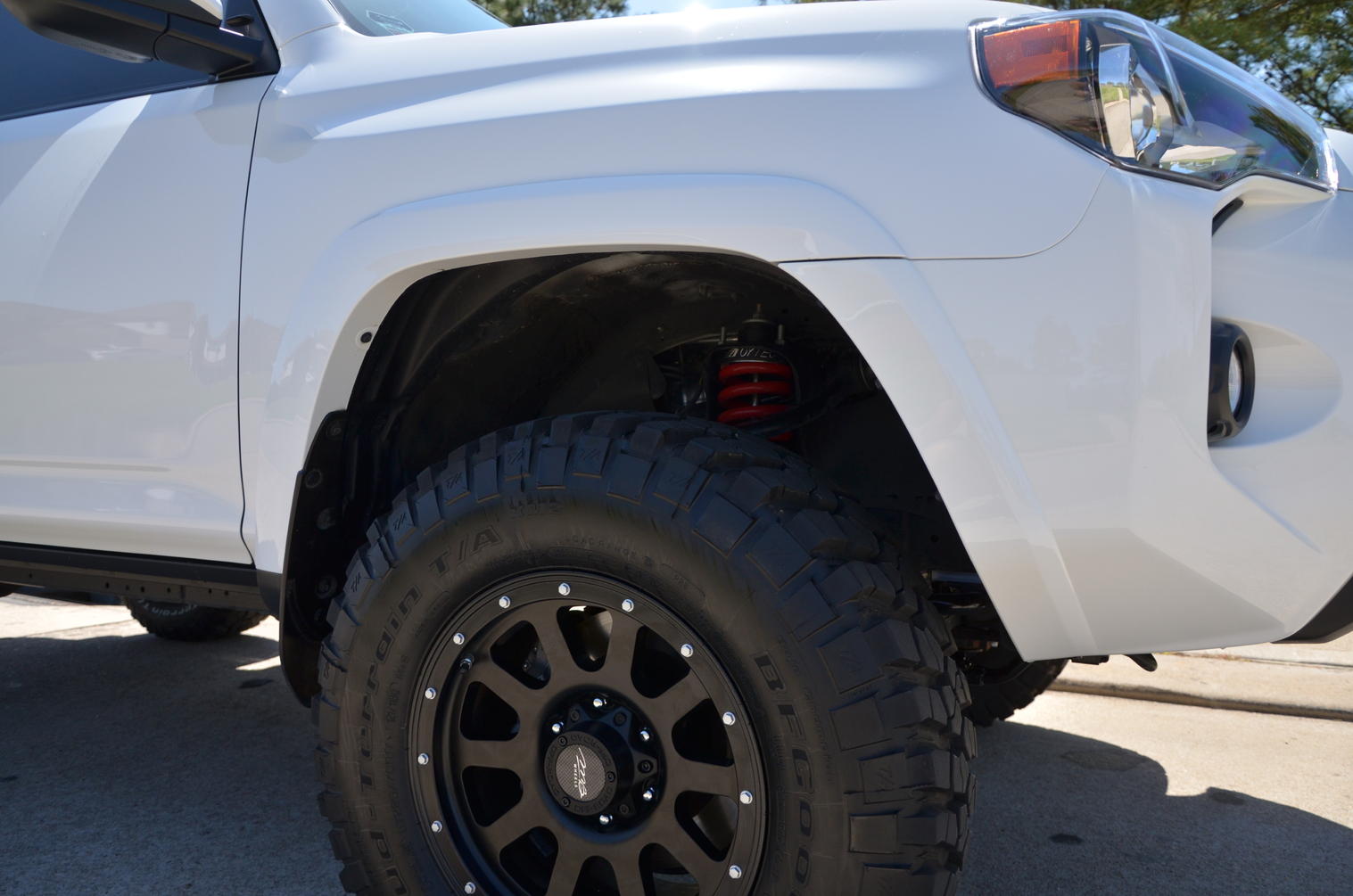

Just turned 6000 :) this weekend a buddy started my speaker upgrade...and I got my Boss c/o 's installed
Wow I love your wheels tire combo

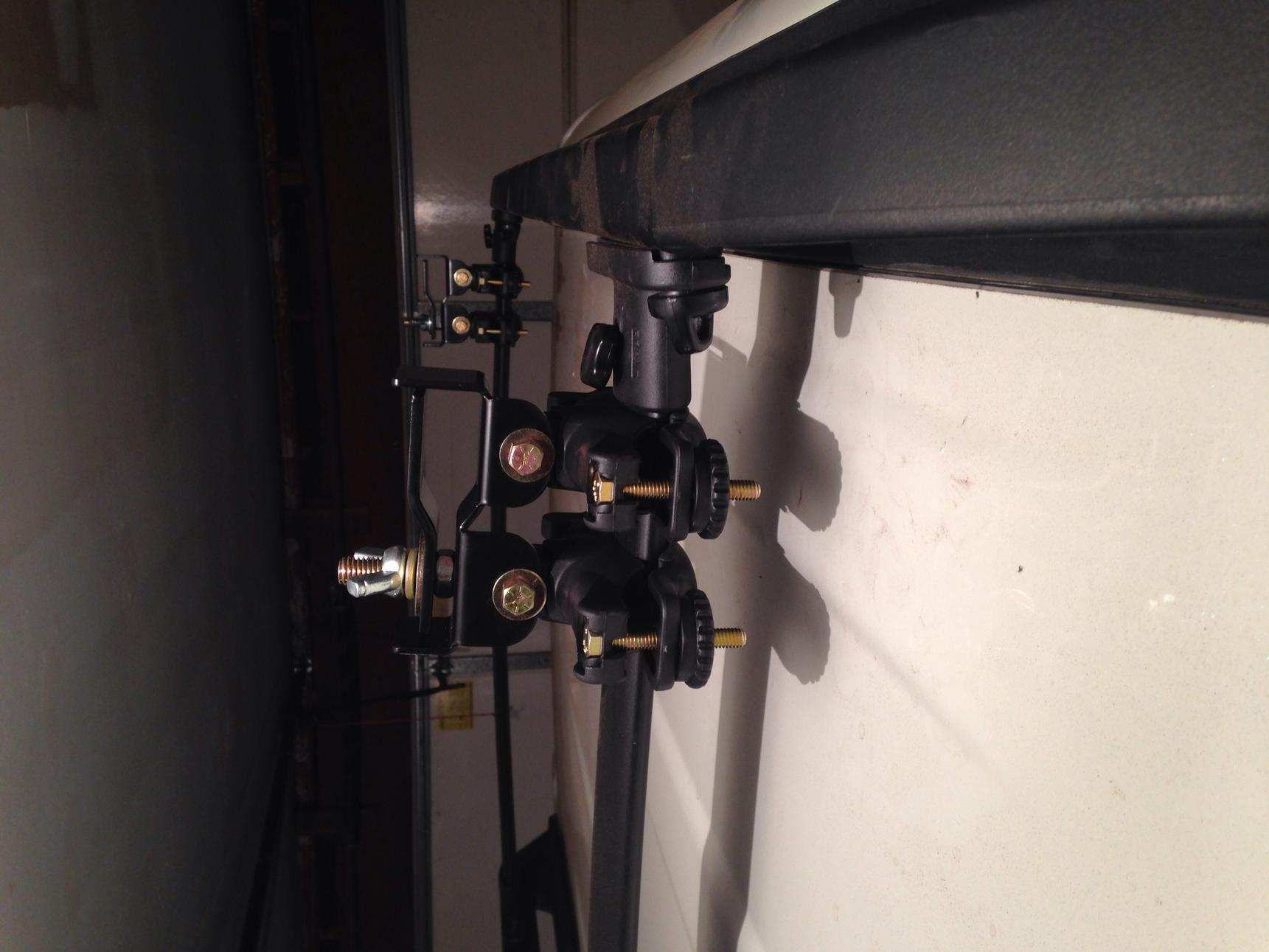

Installed Yakima Mighty Mounts and the Slee Off-Road Hi-Lift jack adapters. Pretty pleased with it for an easily removable system.
Its not a good long term solution if you plan to leave the hilift on there. The lock nuts On the crossbars will vibrate loose pretty often, it will rattle badly over bumps, and eventually wear/bend the side rails to the point you can't keep it from rattling any more. I had the same setup until I switched to a Bajarack about 6 months ago.
It helps to keep it closer to with sides to minimize the flex in the crossbars.
ETA: by lock nuts, I mean the plastic screws on top of the crossbars and the plastic screws securing the fore/aft movement in the side rails.

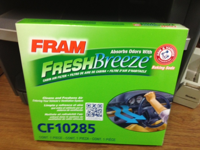

Getting ready to do the first cabin filter replacement @ 20K. Not sure if it needs it or not, but I'll change it even if the original one is okay. Been using the a/c alot here in socal lately. I think I'll just replace it every 20K from now on.
