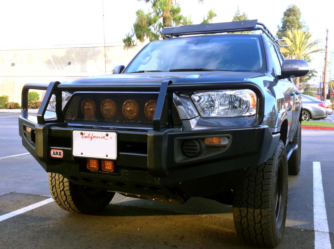

Installed an ARB front bumper... was a bit of a pain in the **s to do - just ask [MENTION=47340]Titanpat57[/MENTION]
(also thanks to [MENTION=68685]Ducmonsta[/MENTION] for answering some back-and-forth questions)
In case you're wondering...ignore the space under the wind fairing...getting ready for light bar placement. (you can see the blue tape where the tabs need to go [MENTION=68079]drabbits[/MENTION])

I couldn't agree more...ARB doesn't make it easy at all...looks awesome though..good job!

Likewise! What did you end up doing with your front skid since there was nowhere for it to attach on my rig...ended up just sandwiching it between the RCI skid and frame. Also had to buy some bolts...even though I was left with a ton...and don't get me started on the whole washers debacle...I ended up just adding locktite to everything as some of the lock washers were spreading once torqued to spec.
It looks soooo much better when you don't follow the directions for cutting the factory bumper.
There were multiple different lock washers. If you don't pay particular attention to which ones, too big of a washer will spread. I'm sure you guys came across the slightly different length bolts too. Some were only 3-5 mm diff.
And for the record, DRL will not light up with the parking brake engaged.

Ugh, forgot to mention one other thing to you and [MENTION=47340]Titanpat57[/MENTION] that I learned recently. The signal light housings are pretty mickey mouse and water will get in them and short the bulbs. Get some good replacement bulbs (same as the stock bulb 1157A I think) put those in, then when you put the housing back together run a bead of silicon around the gap. Also wrap some tape around the wires where they go into the housing. Not sure if I got water in mine from a water crossing or just from the car wash, but either way my original turn signal bulbs didn't even last a year.

I used the smallest washers for the specific bolt size and it still spread. Trust me...I tried all sort of stuff and then just lathered on the loctite :wink2:
Not all bolts had this issue. The best bolts were the pre-set one's with washer/locks on them already.
And for the record I didn't have that many differences in the bolt lengths for the same size bolt - it was odd. They really need to put a picture of each bolt with the description. Not that you couldn't find the bolt but it takes the guessing out of the equation.

Don't panic when you don't end up using a lot of the bolts, nuts, washers, etc. One thing is there are a bunch of copper/brass coloured clip-on sort of captured nuts (if I wasn't at work I'd take a pic of one for you but [MENTION=68685]Ducmonsta[/MENTION] might have one handy or at least know what they're actually called) to bolt the three bottom skids in place. Keep those handy as the clips eventually bend out of shape. I've already had to replace a few of them now and soon I'll have to try to find more of them.
I confirmed the M6 x 1.0 cage nuts used for rack mounts work :-) I had to use one and they are exactly what are being used. Just search for M6 cage nuts on the interwebz...

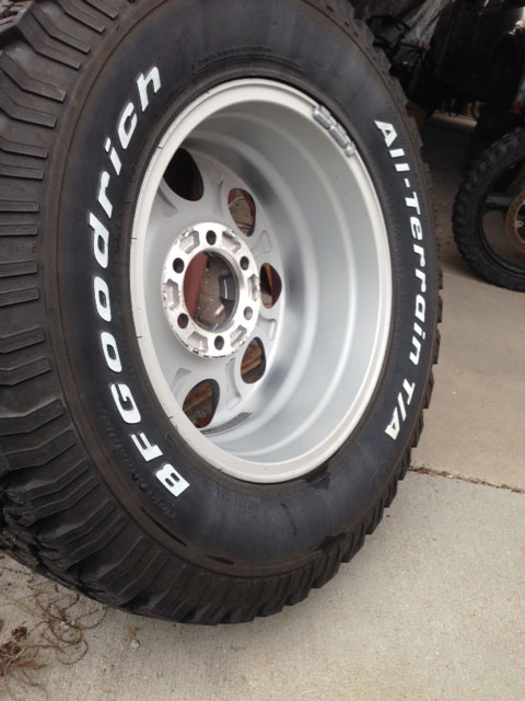

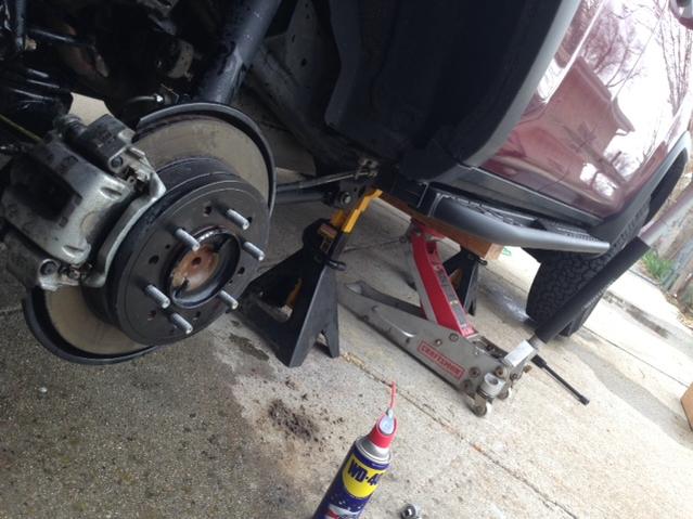

Finish with first 5k check, cleaned (yeah, yeah, I figure the insides only get washed every six months) and rotated tires, still need to grease a few spots.
Who would have thought the inside of the wheel could be that clean :shocked::der:
