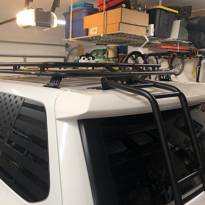

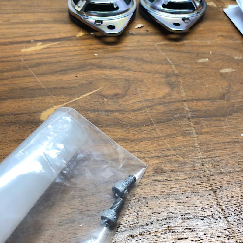

Put the GOBI on last night, + ladder and windscreen. Always fun to find hardware left over (not). I have enough projects going on simultaneously that it might not be a GOBi piece, but does anyone know what these screws are for (if it is for the GOBI rack)? Install was straight forward and I don’t have any holes missing hardware... I think these two screws held the aluminum pinch plate for the ladder in-place for shipping only...

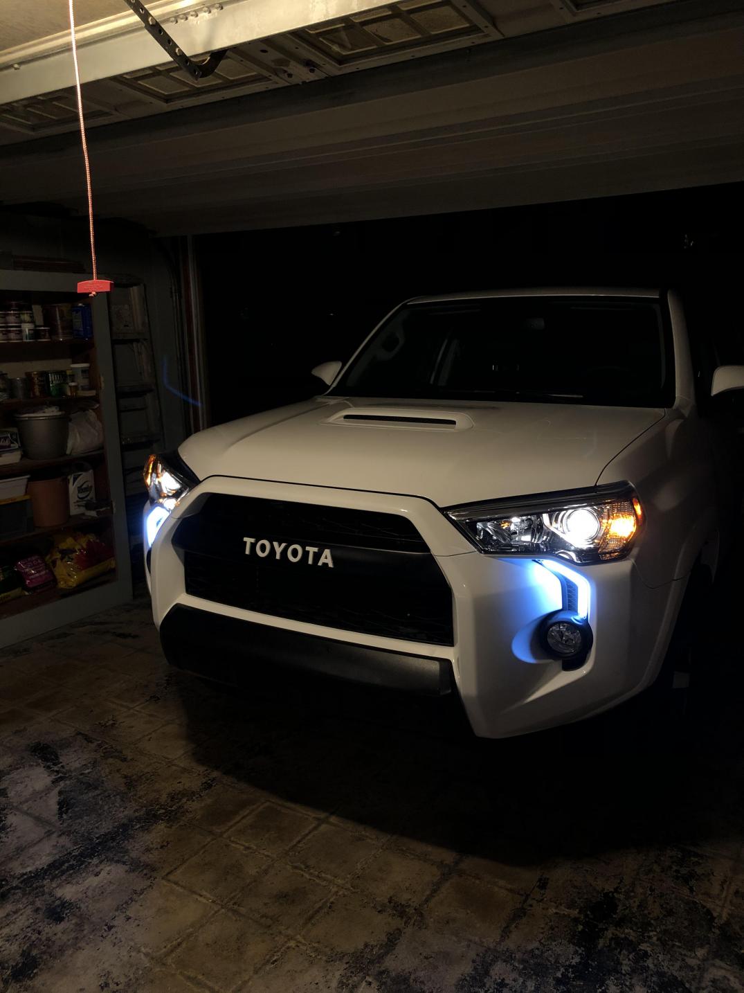

Installed: Pro style grille, plasti-dipped the emblams and front and back valances black, plasti-dipped the grill "Toyota" and back "4Runner" white. Installed the bezel lights. Excited how it all turned out. (sorry for the dark picture, the only one i was able to take after a long day of projects).

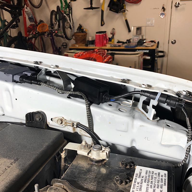

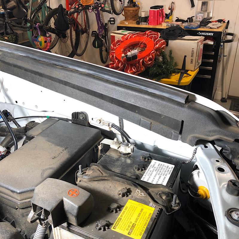

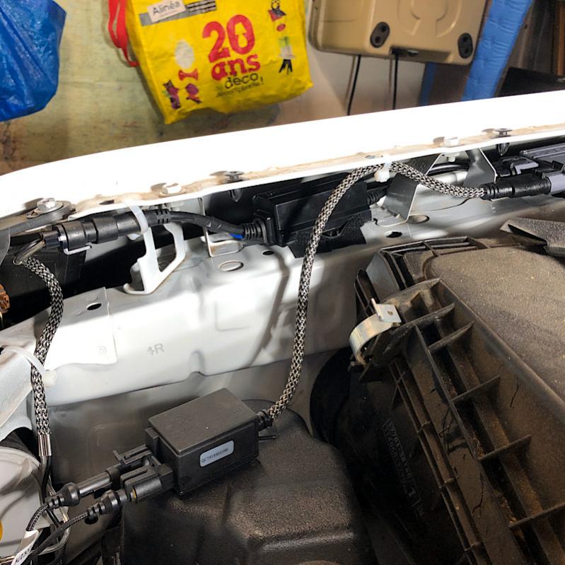

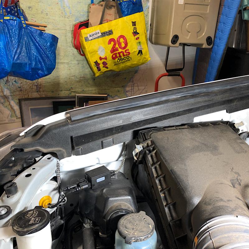

Was last week, but installed the Morimoto elite HID kit. I ordered the standalone canbus option (in lieu of the HD relay harness, which I have as a backup in case the canbus doesn’t work out). I didn’t want wires running all over the engine bay, and while the canbus harness is advertised as a fix for “light out” warnings in European cars, Morimoto confirmed it should be fine for 4Runners, they just didn’t have any feedback from users yet. My main reason was the fact that they plug directly into all factory wiring without a battery-fed relay, so I was hoping for a much more discrete install. I ALMOST pulled the headlights and popped out the factory gasket below the low beam bulbs in order to use this gasket entry point for the amp ignitor wiring (deleting the need to drill a hole in the dust covers and keeping it REAL clean), but alas I didn’t have the time prior to a trip to the mountains. That said, I know I can do this later and replace the dust covers I just drilled into.
Only complaint (and a small one) is that - for the canbus harness or HD relay both - the length of wiring from headlight to AMP ignitor is too short, severely crippling my ability to hide everything out of sight. The driver side is hidden by mounting it to the side of the battery, but the passenger side had to be mounted in plain view

Are the light bezels from AJD or aiden James design? If not, from who? If so, how long did you have to wait to get them?
Yeah, they are from Aiden James. I got them in less than a week after ordering, albeit, his shop is the next city over from mine so shipping was like a day once the order was confirmed and processed.
If you are thinking of ordering them, I got the switchback versions and his install video uses different T-Taps to splice into the turn signal than what is provided (not a big issue but drove me crazy at first because i am not electrically inclined).
