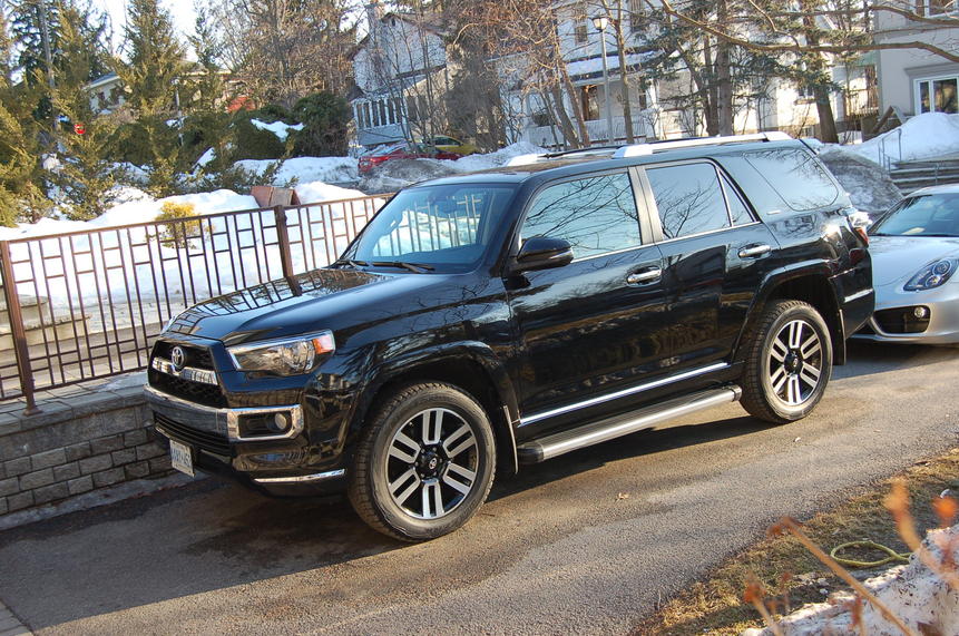

Looks great! Now you know one reason I traded my black SR5 for a silver TE. (hint: it wasn't all for the KDSS or the hood scoop lol)
