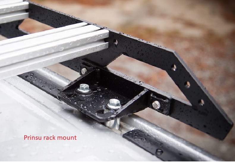

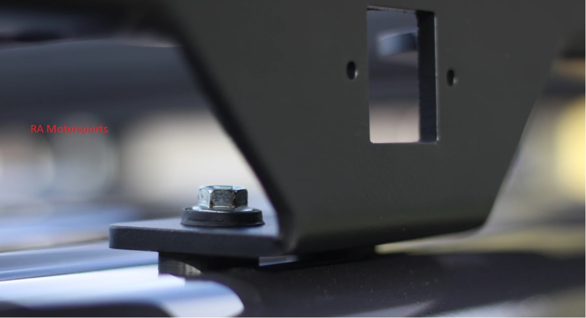

Interesting. How are the tops of the mounts sealed? Those slots may be difficult to cover.
It looks a lot like how yours is mounted -there is a just a bolt hole as opposed to a slot like in the prinsu (which I hate). The single hole (vs a slot) is easy to seal. On top is a rubber washer, aluminum washer, and then bolt. I'll be swapping the rubber washer out with a red silicone washer.
I think I might put down a good layer of butyl rubber on top of the entire washer/bolt assembly and then cover with a nicely cut piece of either vapor barrier or some form of black plastic to mate to the butyl rubber so that it doesn't get gunked up with dirty and debris.
I've attached a pic of the RA mount and the prinsu for comparison. You can tell the person that installed the prinsu in the pic used a butt-load of silicone.

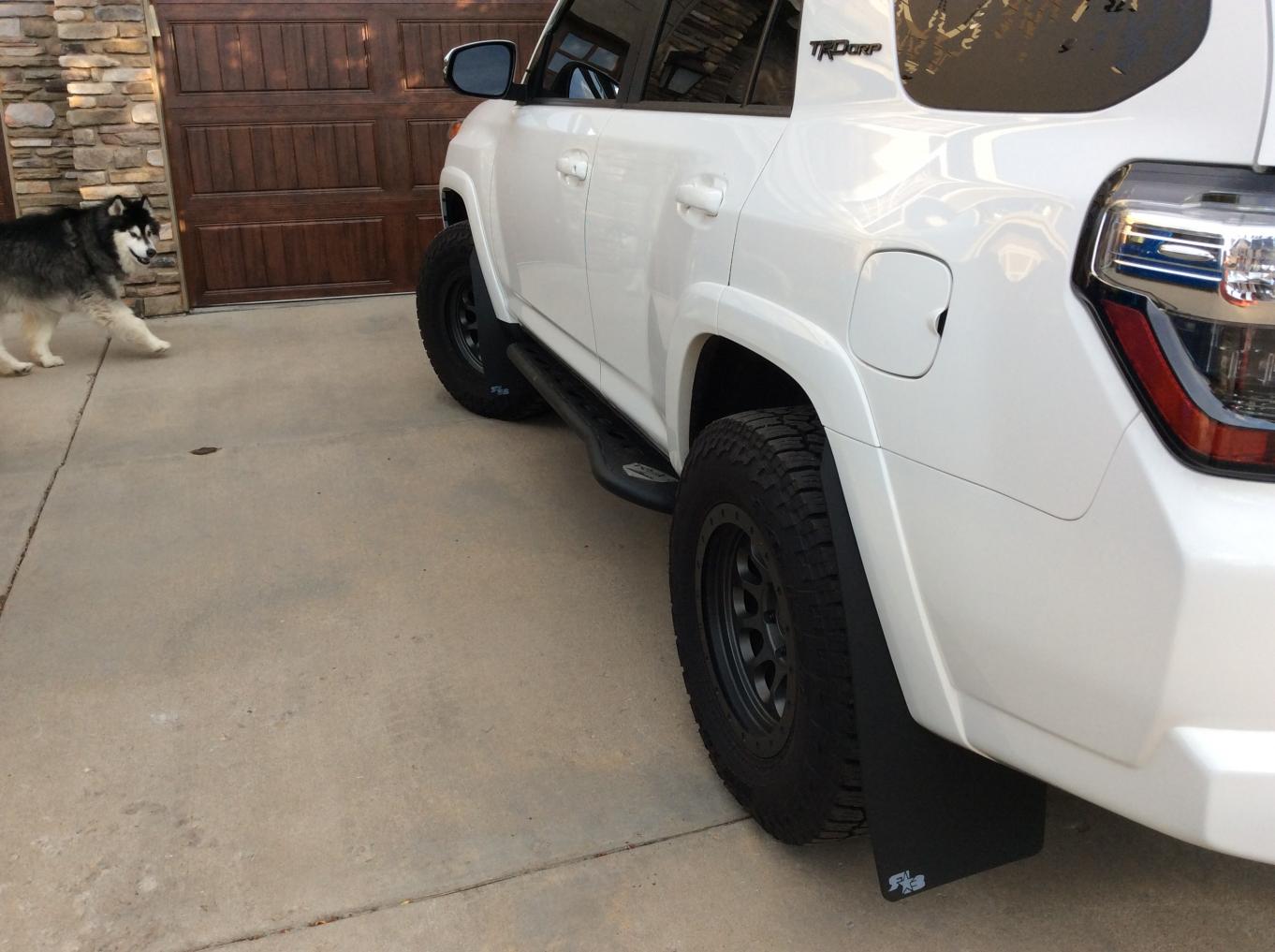

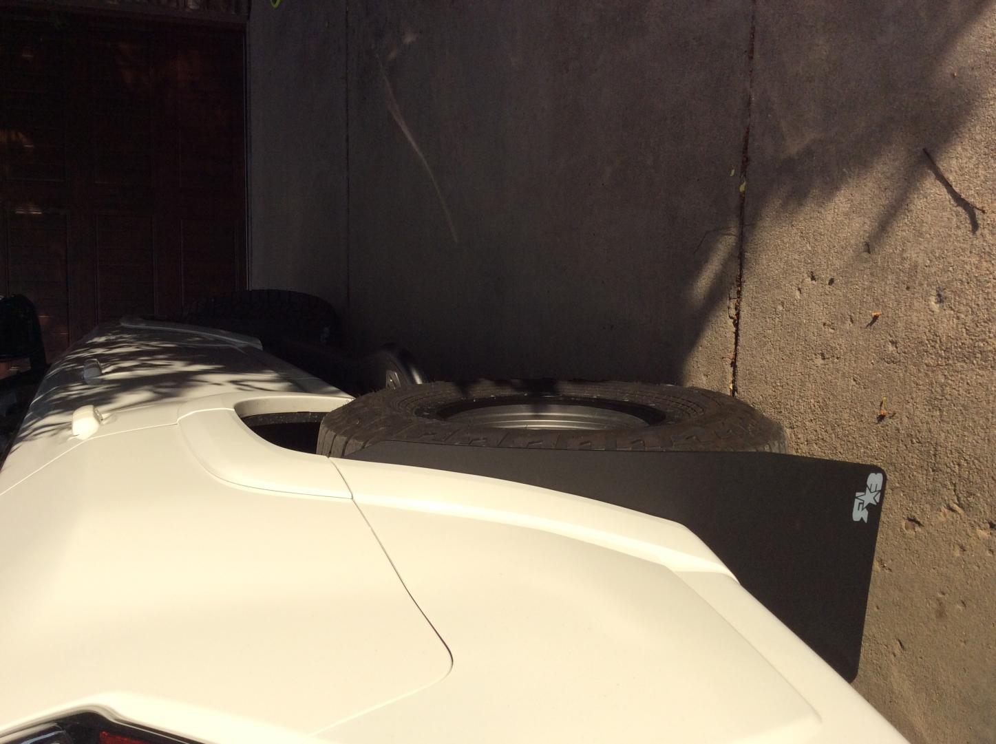

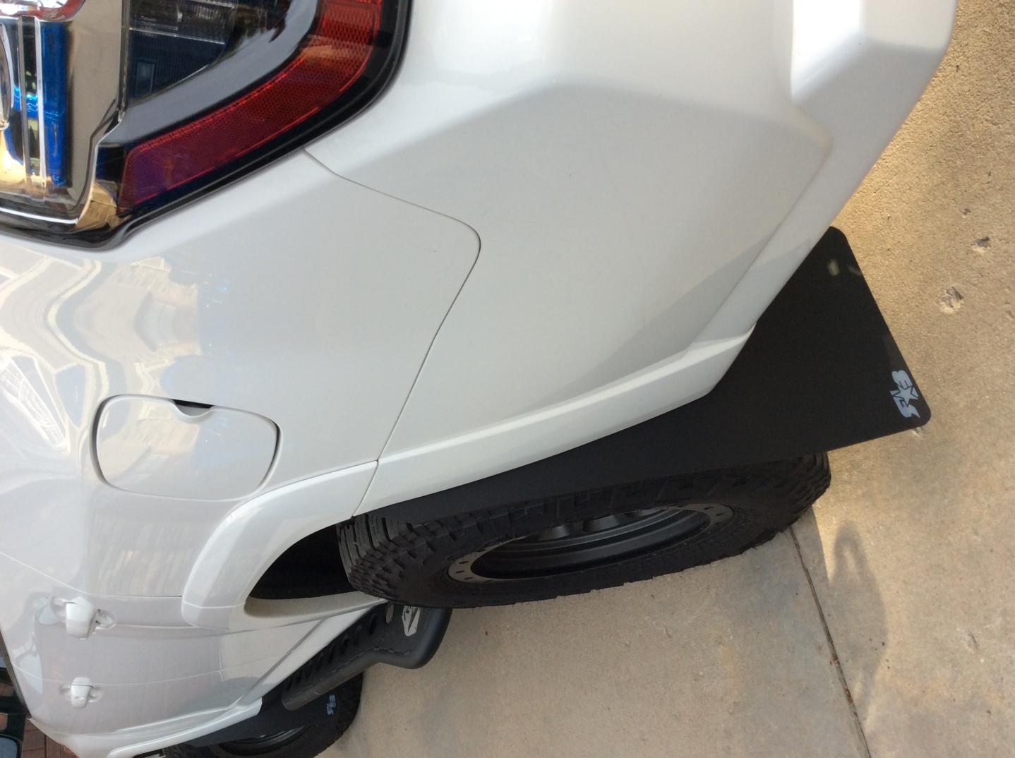

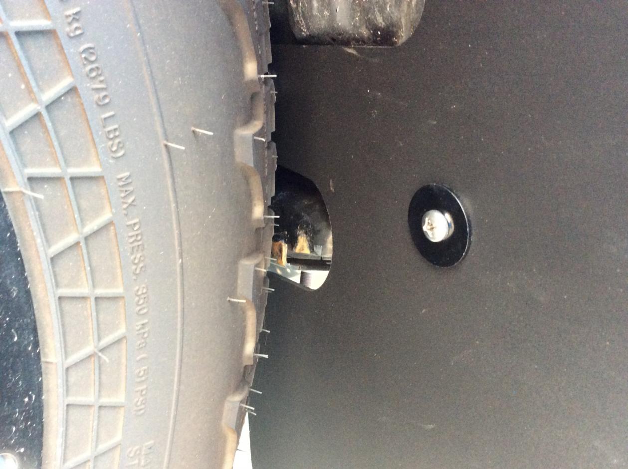

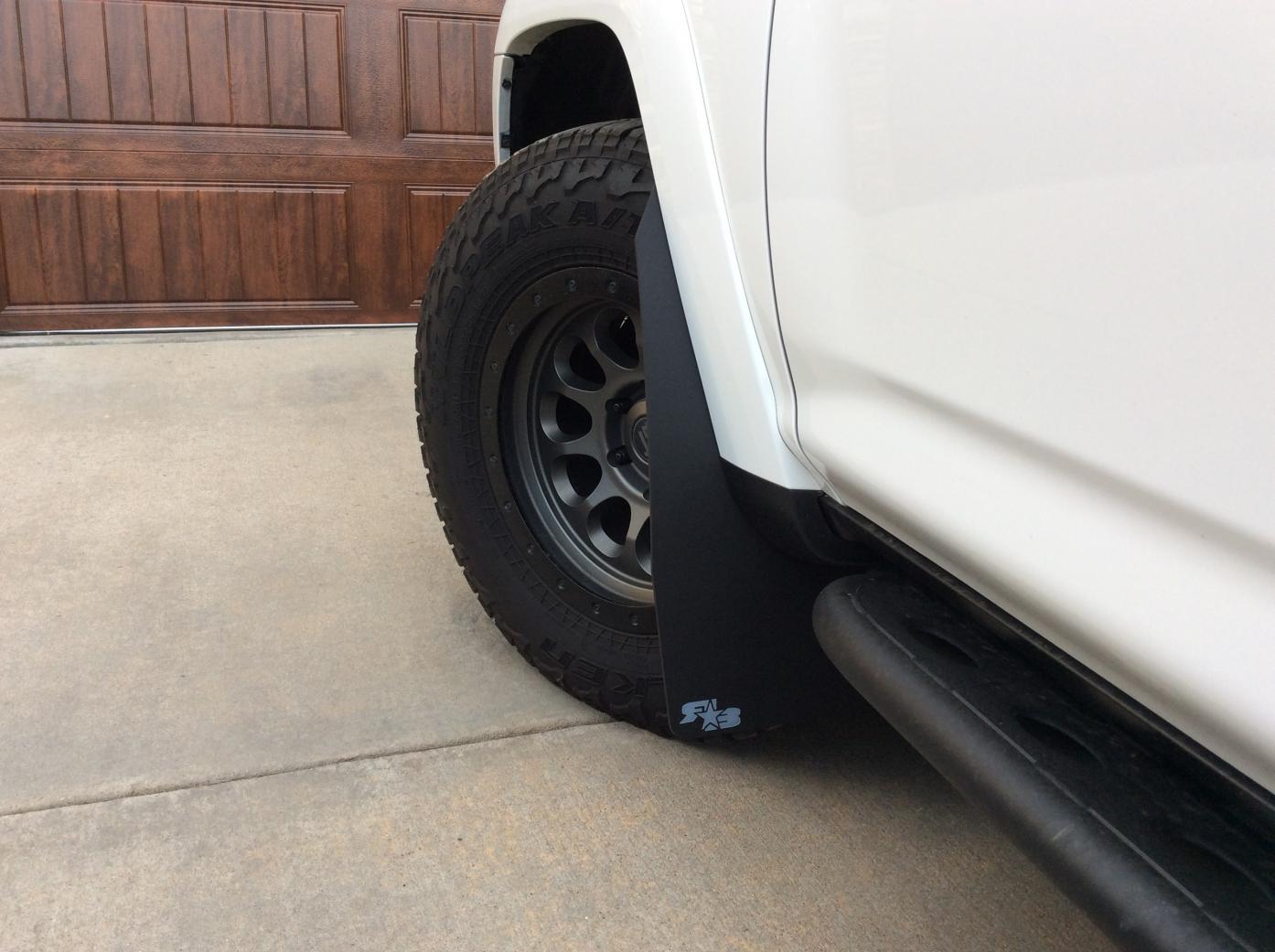

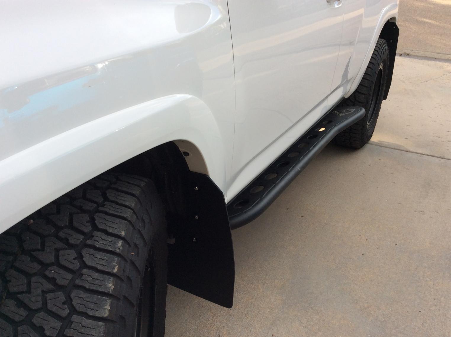

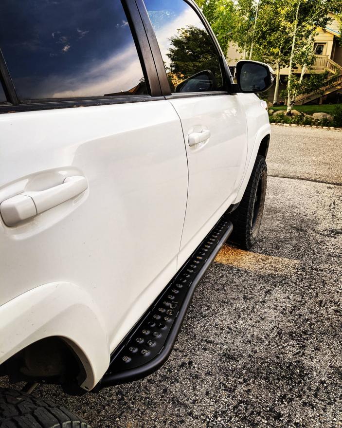

Installed RokBlokz XL mud flaps. Love them. Super easy install, great coverage on sides, not flappy flappy. But the biggest bonus is no more rubbing at full lock in front since they cut away around the body mount.
Here ya go

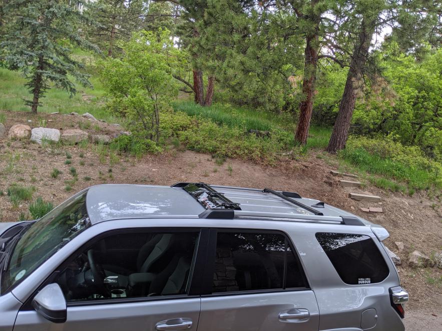

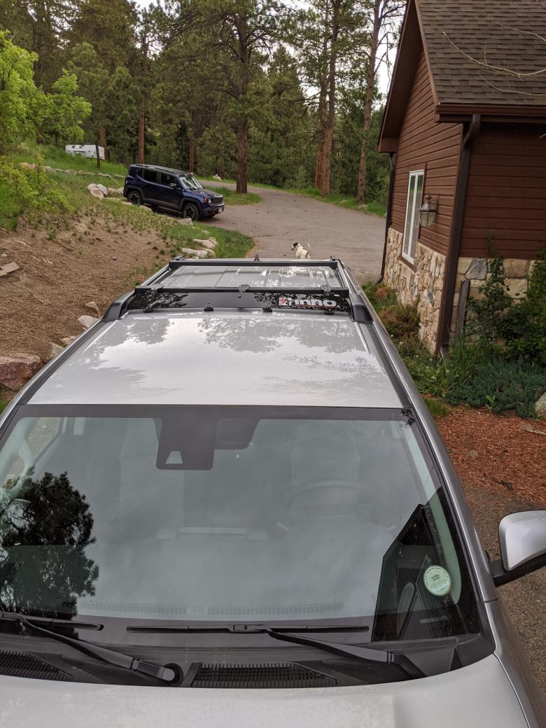

Installed the Inno fairing on my LFD crossbars. It works great to cut the wind noise and I can still fit my Skybox without having to remove it or use an extra crossbar.

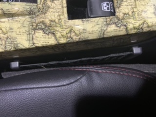

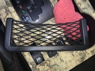

Installed these net pockets off of eBay by the front seats. Been useful for random papers and wife’s random stuff.

Those actually look really good! Any way to get rid of the logo?
Also, are you running spacers or is that the offset on your wheels (and what wheels are they? They look sweet!)?
edit: found them! RAY 10 – Stealth Custom Series™
Yeah I hear ya on the logo. I order gray, but it is much lighter than I thought. You can get a black logo which would be as subtle as it gets.
I removed Rally Armor flaps, they were not very good. The main issue is that they use metal brackets that are exposed that are huge ice collectors. Then the ice wraps around them...terrible. Flappy, the rears were 3 parts that also had major ice issues getting between the rubber flaps. Plus...a total pain to install. Then the fronts flaps and brackets went over the body mount causing rubbing even though I am running stock size AT3W tires (32”) which are a large stock tire but still!
The only option I wish they would offer is a small splash guard in front of the rear tires to prevent caking of mud and snow on rails or steps, especially with my added offset wheels. May have to design my own and cut up the old Rally Armors
We ski a lot, though the 4R is not the best ski car I have owned it is pretty good. Better in super nasty conditions though. But AWD with real snow tires is tough to beat in most cases. So having good flaps is a big deal to me with all that crud. I also hate to be that guy not sporting flaps and cracking windshields behind me. Been on the receiving end of that to many times.
Yup Ray’s 10, 8.5 wide version
I agree with you about the 5th Gen 4R needing a splash guard in front of the rear wheels. Something that will stay put, not contact the rear tire at highway speeds, and won’t flap against your sliders or steps.

I loaded some pics of the mount with their neoprene gasket. I figured some butyl rubber on either side of the gasket, all around, wouldn't hurt. Just snug up the mounts until the neoprene starts to compress much like you did the silicone gaskets and call it a day.
