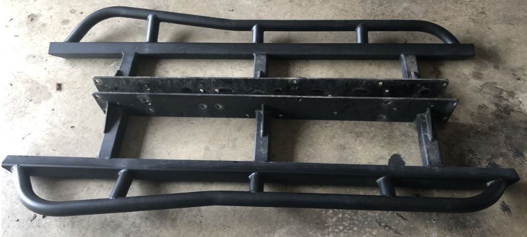

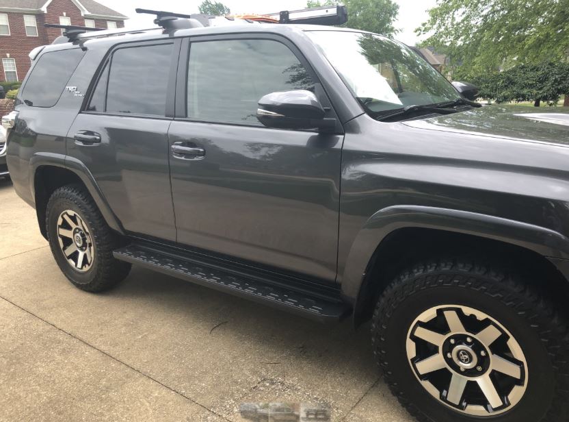

Removed my sliders, and installed a set of running boards.

Yeah, I know. Sliders were the first mod I did three years ago. My wife has hip issues, and has trouble climbing in with the sliders. The running boards give her a much larger, flatter step for entry.
I'm going to keep the sliders for now.
Right on - makes sense.
I don’t think those OEM steps looks bad at all. In fact, I’m looking for a set too.
Would be nice if they were like the Ford Raptor style steps.
