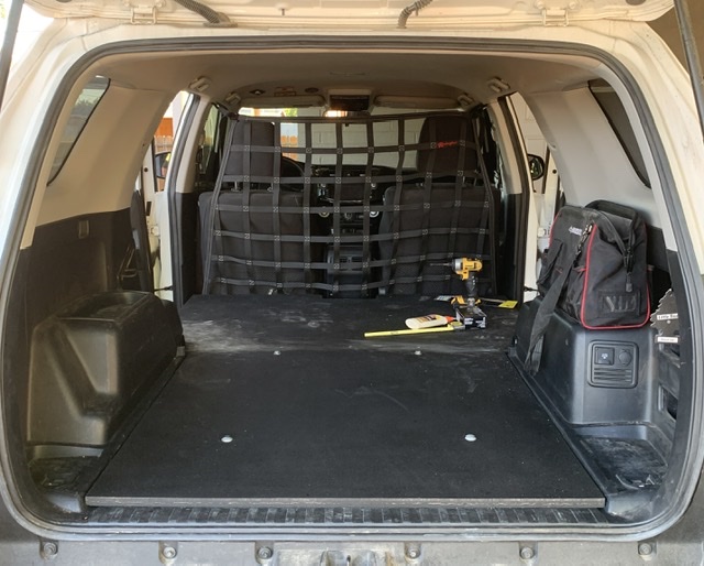

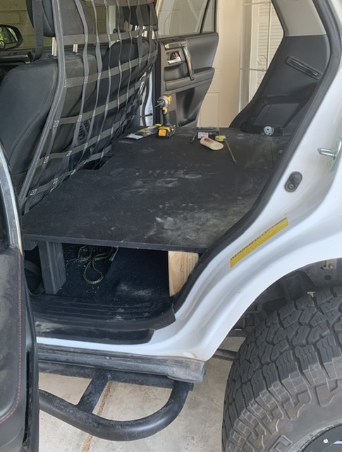

Put the net back in and added more bracing to the platform to eliminate flexing. It got painted black before installing figured it’s easier to show what I added in raw wood. There’s a long center support but those corners had a nasty flex.
Ran out of time to swap the the trans crossmember. Might do it tomorrow or save it for next weekend.

I wish I had the desire to install that net.

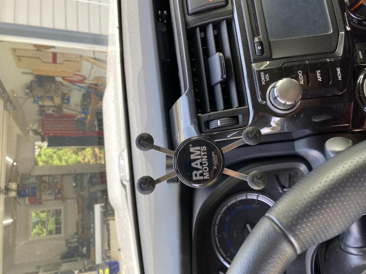

Installed a RAM mount in the dash. Super solid way to hold your phone for sure. It’s a 1/4” hole in a very inconspicuous spot if I ever remove it I have a couple easy ways to fill the hole.

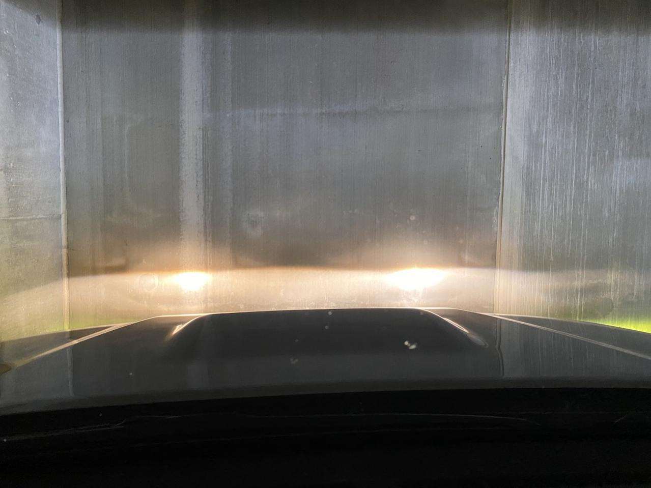

A little over 4000 miles and for the first time last Friday, I drove it at night. The headlights were as bad as I remembered from my old Trail. So I did the H9 conversion using Hella 2.0 bulbs. Headlight on the left is the H11 and the right is the H9. Definitely a bigger spot. The brighter and whiter light now competes with the LED fogs. Also, I was pleasantly surprised how much easier it is to access the bulbs with the projector housing vs. the old reflector housing.
