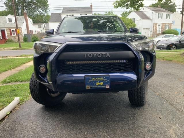

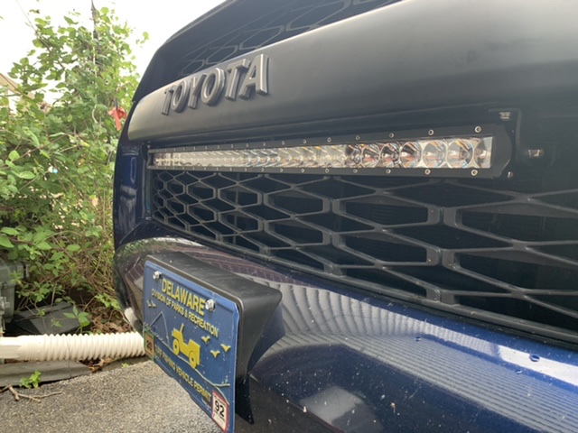

Installed the hertitage grill and added a 30” light bar

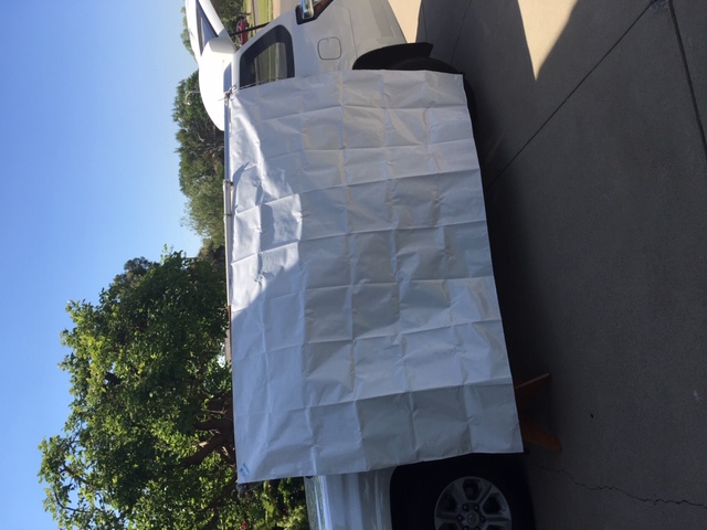

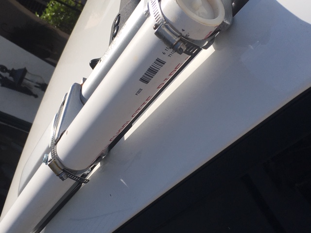

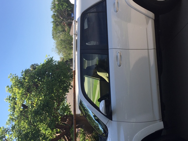

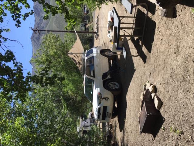

First camping trip with diy awning
I just returned from a solo 4 day camping trip to test my new awning. The entire camping set-up needed to be fully removable for my daily driver uses.
See my 2 part attachment to the factory roof rack. I mount the awning on the drivers side because my 4 leg cot 28" x 74" is set up on the passenger side, and I keep the driver side rear seat up for use in camp.
The awning uses 2 roof poles: 1) 36" of PVC 1-1/2" clamped to the factory rack with 2 homemade brackets and 2 hose clamps, 2) 72" of a Lathi cane staff about 1-1/4" dia. This provides 9-1/2 feet of roof mounting for the attachment of the tarp. The tarp covers both doors for rain/sun protection. I found a wonderful sun heat blocking light weight tarp 6' x 9'. It actually provides deep cool (10 to 40 deg.F) shade - Bushpro Silvicool 3 PC800 tarp from Gear up. I tie the tarp to the roof at 4 positions.
I remove the 72" staff for changing campsites, but leave the PVC attached.
I used a couple of old sectional tent poles 8' tall for this test use. But I am planning to fabricate adjustable aluminum poles by modification of painters roller poles. I see the pluses of easily lowering a corner for shade or rain protection.
I have 2 side wall tarps 7' x 9' for privacy that tie to the awning & tent poles if needed.
I can provide more details for my home made roof rack clamps if anyone is interested.

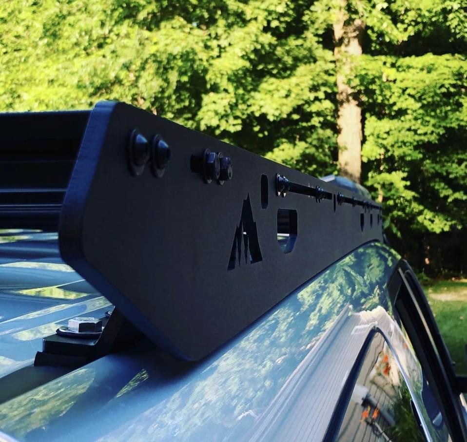

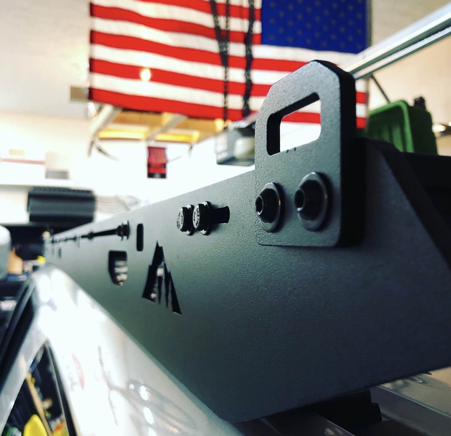

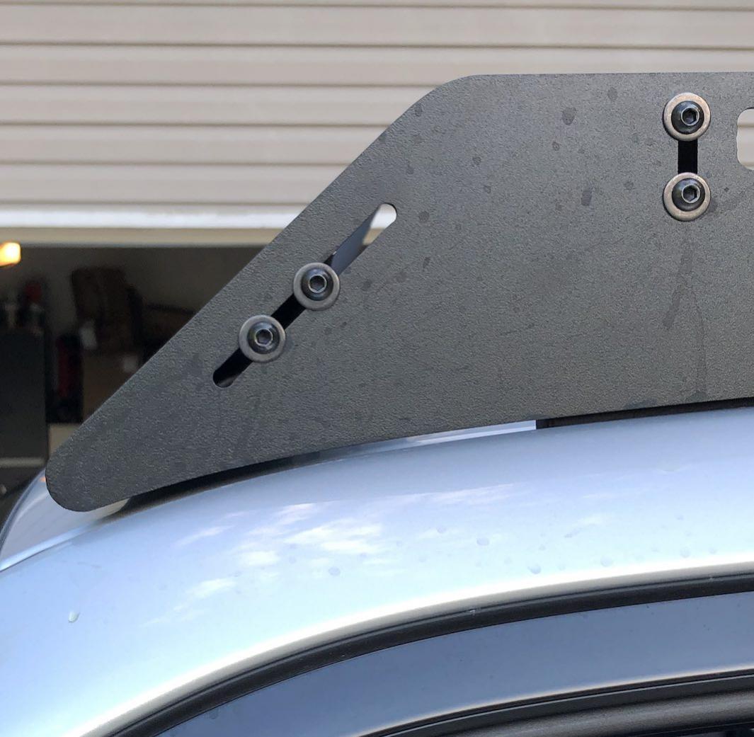

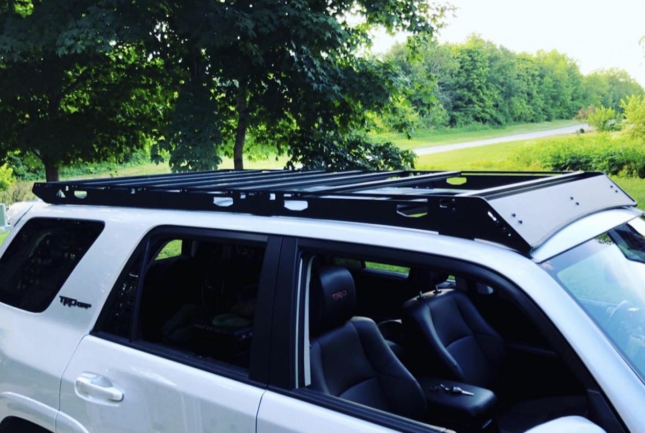

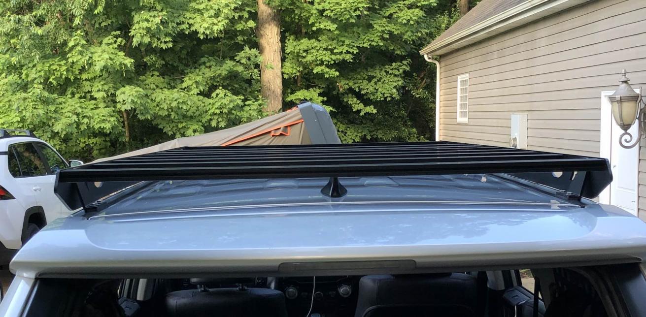

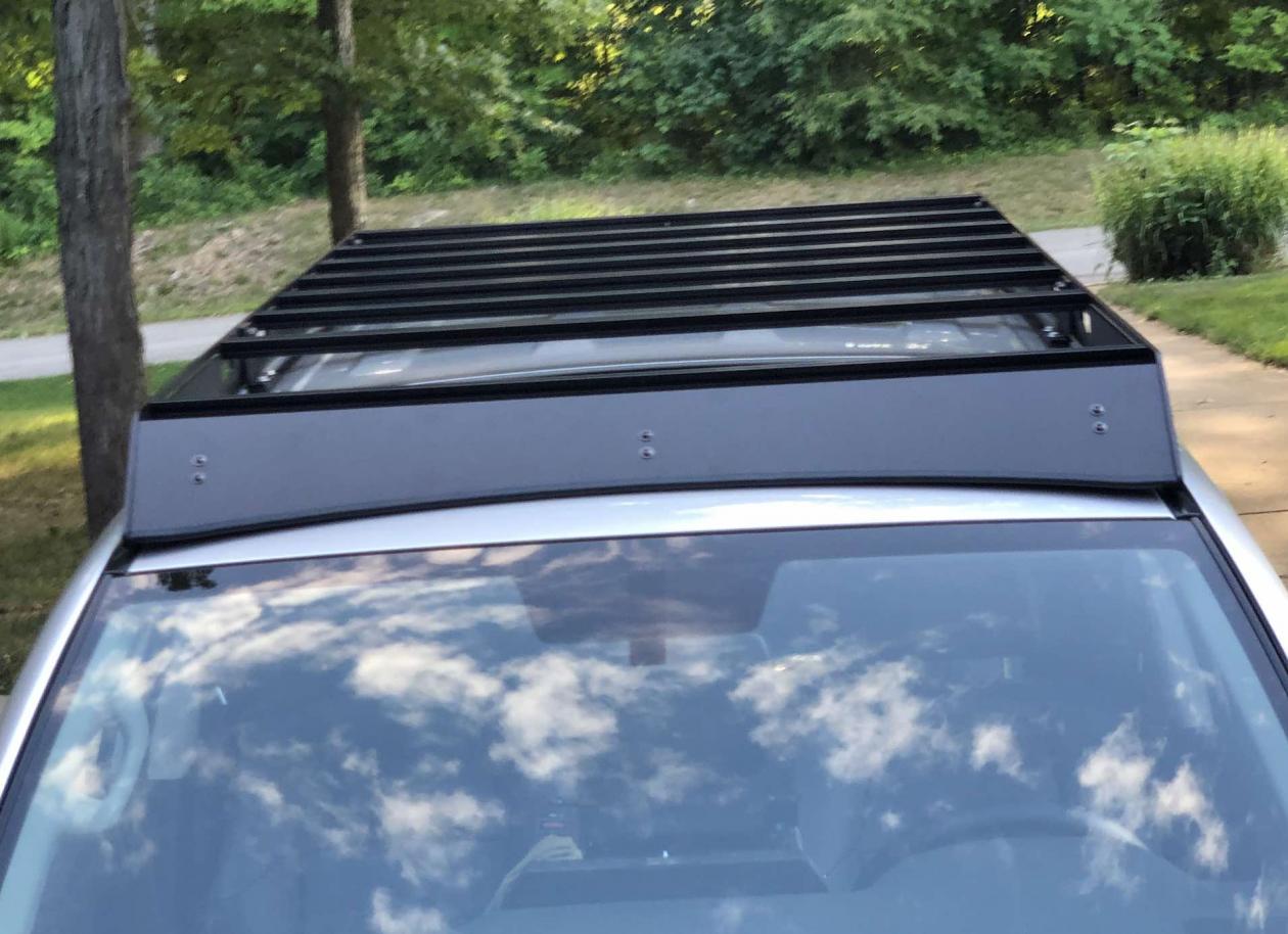

Sherpa nailed it with this rack. I'm crazy happy with quality, looks and ease of installation. It's insane how low profile this sits and how perfectly it follows the lines of the vehicle. Can't wait to get the tent mounted and start putting it to use. If you're on the fence about a roof rack and Sherpa Equipment Co. is one of your choices, you won't be disappointed.

Nice. Definitely going to be my next rack. Just waiting for the next sale!!!

That looks great! Addresses some issues I have had with my Victory, like the bars not being flush with the side rails requiring me to fabricate to get side mounts to work. And the thicker side rails I am sure flex less. Looks like a better overall fit as well. Very nice
