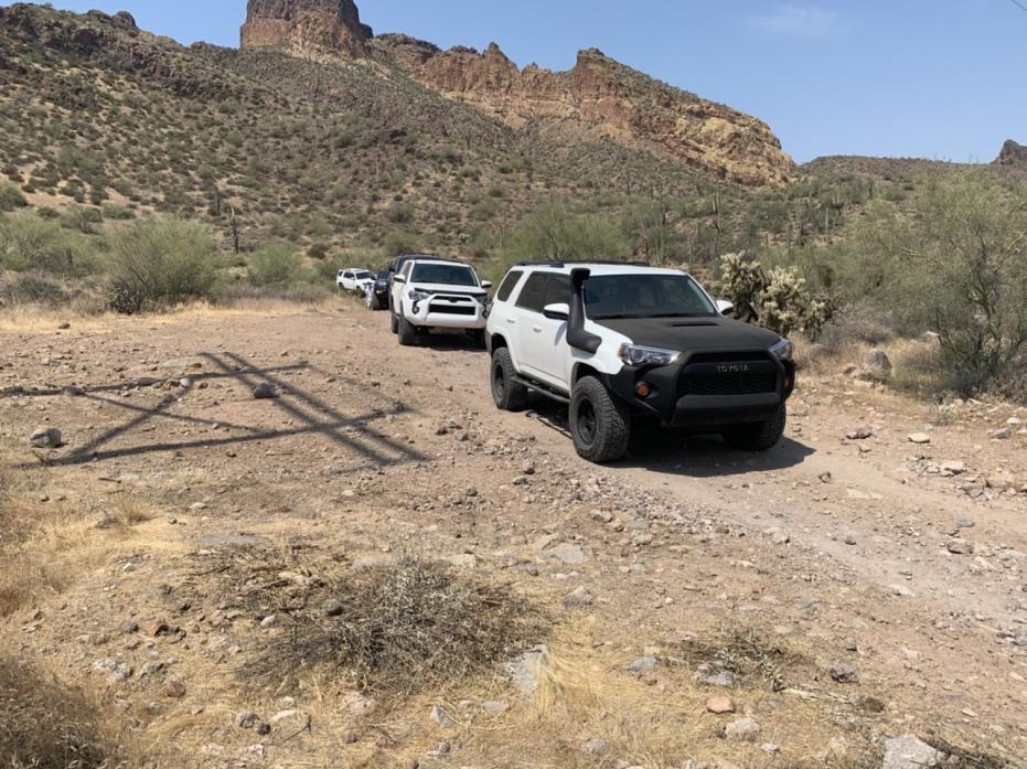

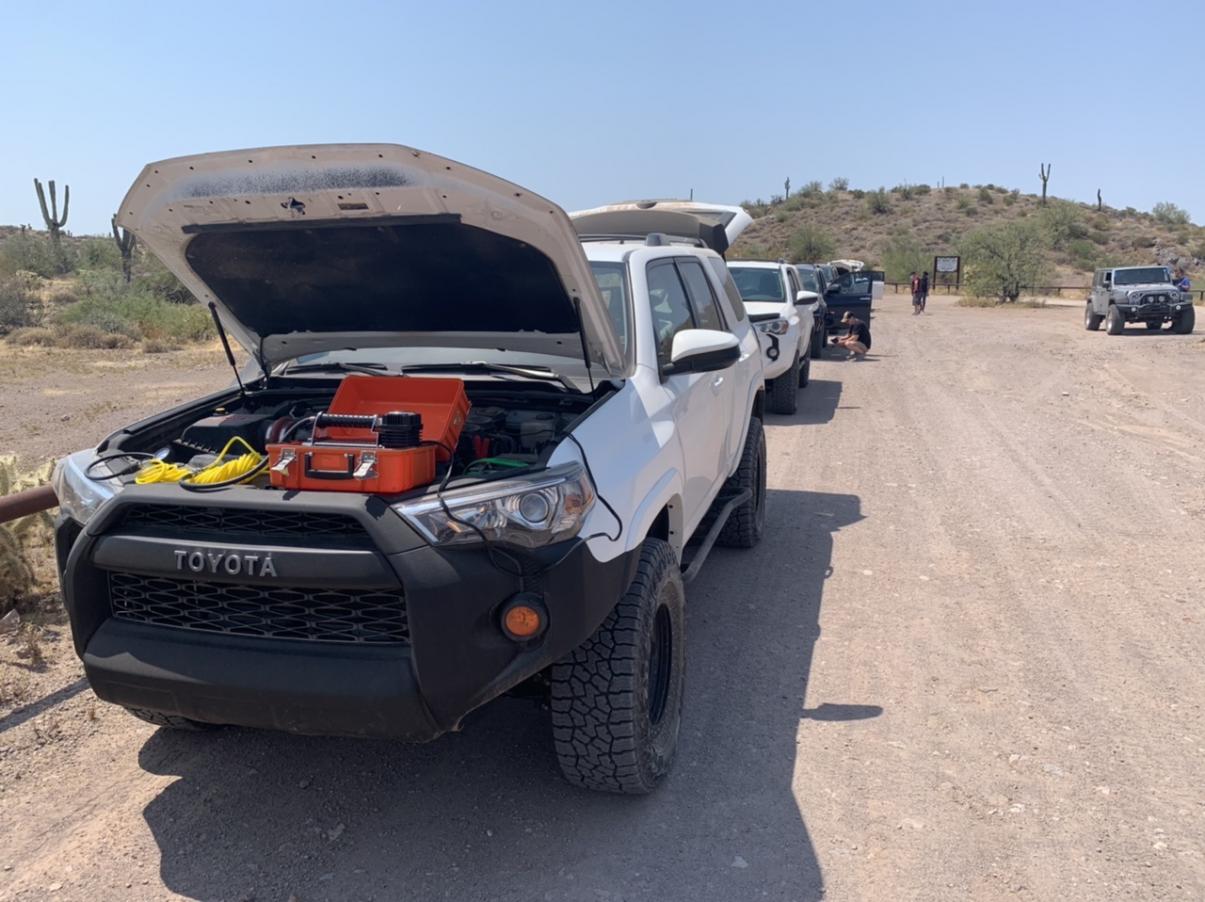

Last weekend but yeah. About 4-5 hours cutting across the desert with East Valley 4Runners.
Followed by an oil change, rotation, tq check, and greasing. Need to get around to changing on the gear oil.

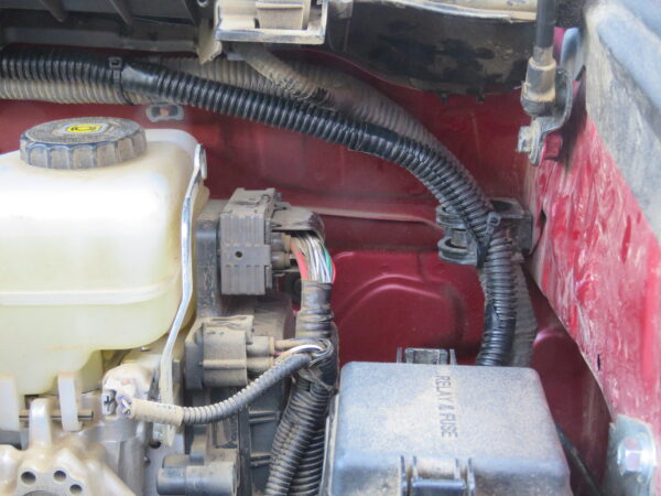

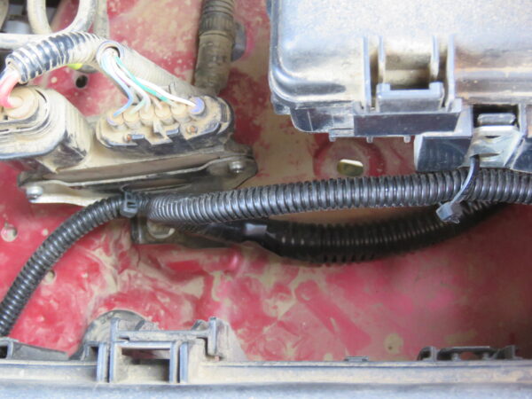

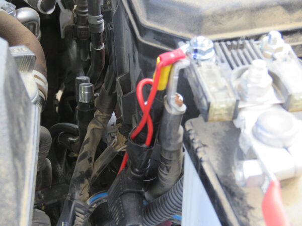

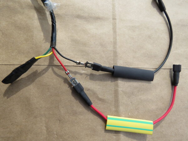

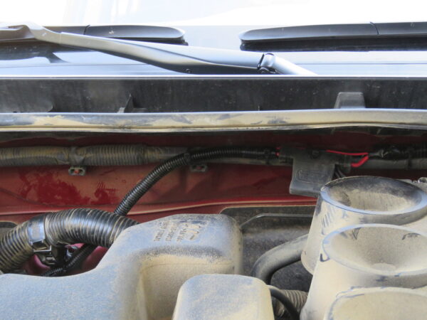

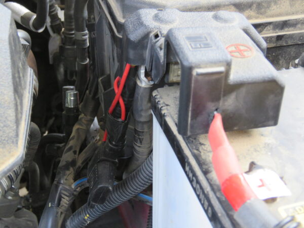

[MENTION=507969]PaulC4[/MENTION] can I ask, where did you tap the power for the ARB switch?
I currently have my compressor setup on the driverside and i'll be moving it over to the passenger side soon.
This is bit more than what you asked, but in case this helps with your wiring decisions.
I kept all wiring internal to the engine bay, since I'm not operating lockers, and the hood has to be open to use the compressor. [For now :)]
I made up two short stubs of female-to-female disconnects to use the ARB harness, which I coiled and zip-tied under the tray, and connected to the switch on the tray. I ran 18 gauge wire cut to the same length as the ARB battery cable, then put a 3 amp inline fuse on the end of that. I connected both the main battery cable, and the in-line relay fuse directly to the battery.
This is not a system that is controlled by the ignition being turned on. Not optimal, but I'm OK with this for the moment.
I used 1/2" split-loom to wrap all the wires. The original ARB battery wire length was just (barely) long enough to be able to bring the wires around and make a turn just behind the fuse box. I separated out the positive, and negative at that point, running the positive underneath a bit of the fuse-box, and up the side of the battery
When I add in my auxiliary power distribution system, I'll connect the switch power to a circuit that is only on with the ignition on. The switch wire that currently goes to the inline fuse can be shortened and still used for that purpose.

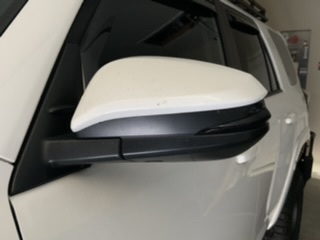

Followed other’s recommendation on the Runnin 4 Tacos side mirror turn signals.
I like the look, brightness, and wide range the signal is visible compared to stock. Having technical difficulties uploading the video.
How bright are the blacked out signals? Trying to decide between smoked and blacked out.
