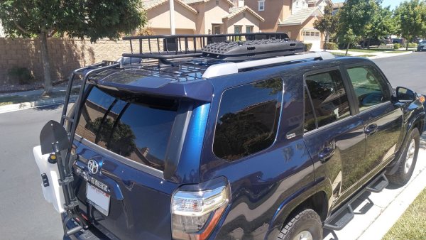

After 7 months, my Gobi ladder finally arrived. I installed it and all the other toys I've gathered up over the past several months from random places online.
I like the half cargo basket with the recovery pads on top, I'll be loading it up with some wood and chairs soon once I go camping. A bit too hot lately, but I can smell it... fall is on the way soon...

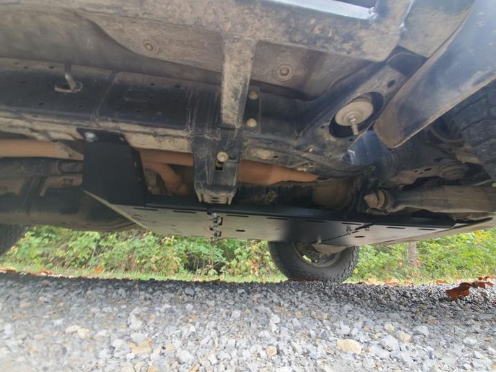

I bought a set of TRD integration skid plates from Shrockworks during the last group buy. They have been sitting in my garage rusting for months and months.
Finally took them to Springfield Powder Coating and had them PC'd Hammertone Black. Was charged $60 total for all 3 skids which included sandblasting and powder coating.
Saturday evening I unbolted everything laying on my back under the truck. Then said screw it - I'll see if a local shop can bolt them on for me. This would be so much easier on a lift.
This morning I went over to a local tire / repair shop. They charged me $50 to install them. I tipped the 2 guys working on it $10 each. I helped out with the 2 PITA stick nuts.
We were able to get 3 or the 4 allen screws in and gave up on the 4th.
I may redo those 2 bolts that are pointed down instead of up.

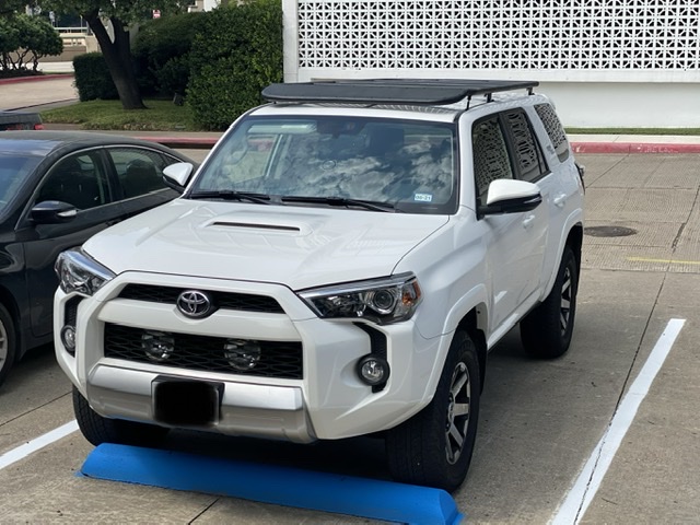

Homemade roof rack
Had to go back and add a wind fairing and some feet closer to the front. It’s finished for now until I decide it needs a floor.

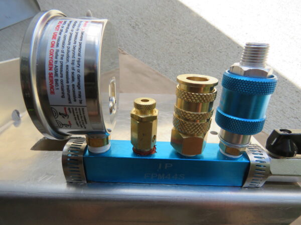

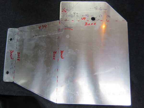

Today I finally finished up an On Board Air system, based around an ARB CKMA12.
I had originally wanted to reserve the spot in front of the passenger firewall for a dual battery setup. But then decided that's not going to happen for a while, so, like many, I decided to use that space for a compressor.
Work on this started about 10 days ago. I made an initial template out of cardboard (free), then made another template out of very light gauge aluminum ($5) to get a good check of the fit. I then got a 12" x 14" piece of 1/8" aluminum plate ($9) and cut and trimmed it based on the light-gauge template. I took it back to the shop where I purchased the plate, and they put the three bends in place using their large press (a bargain at $10). Given the time invested with this build, rather than buy decision, this only made sense because my time must not be that valuable...
Doing it this way did allow me to cut the tray to place items where I wanted them, without worrying about the cost of cutting up someone else's higher priced starting point :). And if I decide to relocate it in the future my investment was just mostly my time.
I used some information from this site as a starting point for decisions on the manifold: ARB Dual Air Compressor “The Wifey Air System”. However, I've changed out some of the components, based on my research of reviews.
Further, I've not gone as far as he did, with running air lines to each of the wheel-wells (at least for now). Instead, I'm going with the 4-tire air distribution system, similar to the MORRFlate (and others). Once the final parts for that I'll post some notes about it.
In the last picture, the gauge has been holding stead at 60PSI for over an hour. Re-tapping all connections whether they need them or not, plus Teflon tape is a marvelous thing...
I'll post a thread (or maybe I should finally start a build thread), with some of the design decisions/lessons learned.

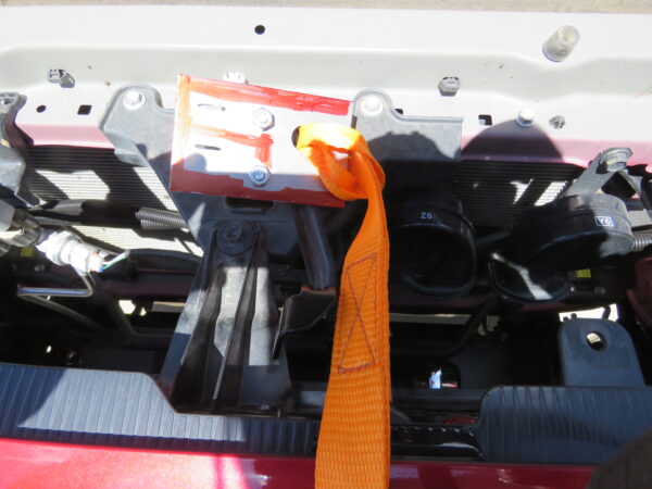

And another thing from today :). A project started and finished on the same day. Who knew that could happen?
This particular problem may only apply to the 2020 models since we get actual pressure readings, rather than just an idiot light. The solution may come in handy for other needs, though,
Did you ever install an air compressor under the hood, and want to check what the TPMS read-out inside the car registered? But you couldn't, because the 'hood open' warning screen on the dash won't let you see the TPMS screen?
U-Bolt + a bit of scrap aluminum + lots of color so that I won't forget it's there = problem solved.
