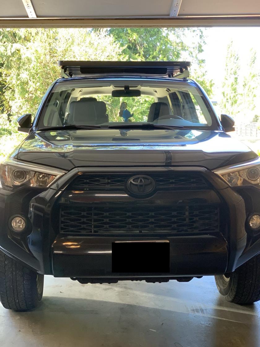

Made some crossbars to install a roof box. More info on my thread.

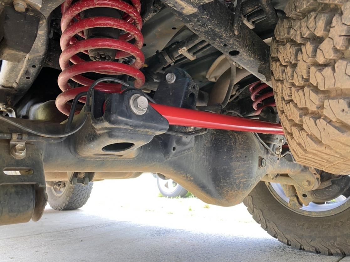

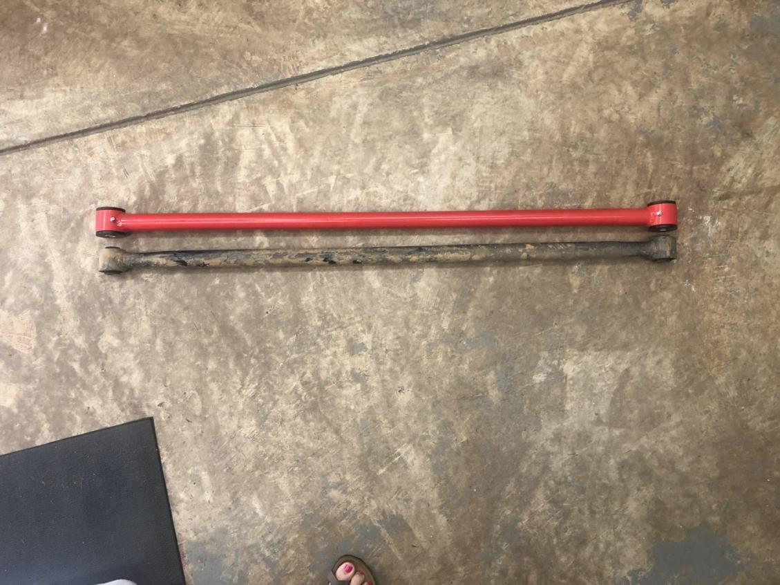

Longer panhard bar to correct wheel alignment. I went with this one because I do wheel my truck and adjustable that could need re-adjusting, no thanks.

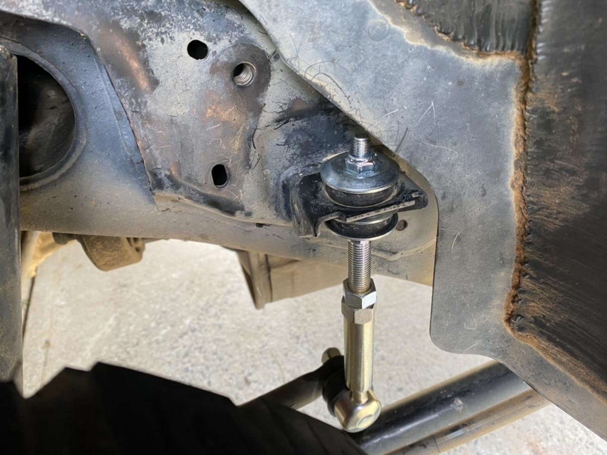

Dobinsons sway bar end links for the rear. These are adjustable and once I had the correct length they got red loctite (which I’ve removed before as needed).

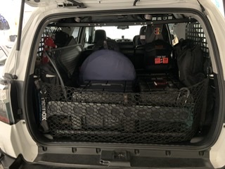

Older picture, but similar layout with a lot more bottled water, canned goods, and fuel canisters on the roof.

Which panhard bar is this? How much lift does your 4R have?
I’ve got a Dobinsons 3/2 lift on mine. It’s by ResZ Fabrication out of Ohio. Runs about $160 before shipping which is much less than most adjustable bars. Theirs are also made from thick wall DOM tubing too so very solid feeling.

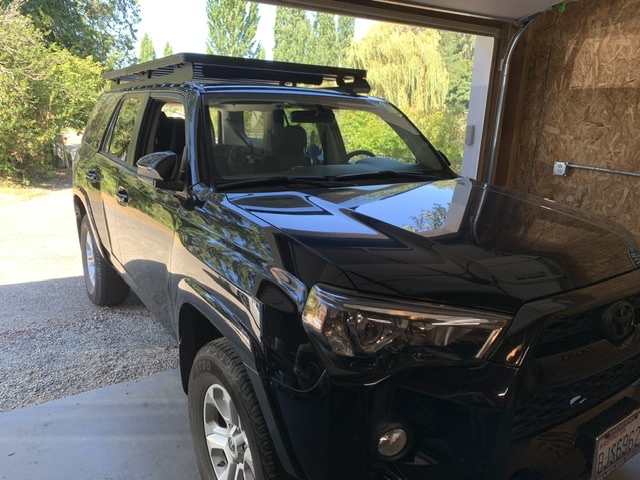

Got my front runner rack installed!
