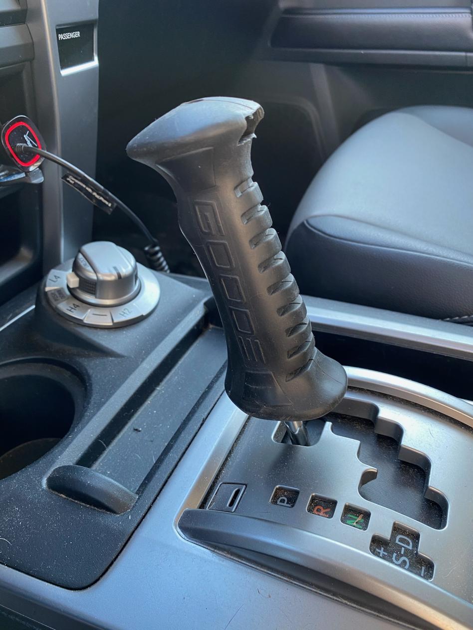

$1.39 Shift Knob
$1.39 for the coupler nut, grip was free- I have a pile of them after working for that peckerhead. Couldn't find the grips from my old Scott DH poles sadly.

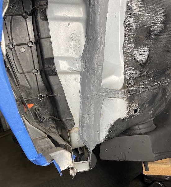

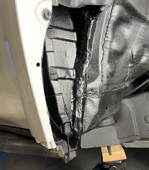

Smashed the pinch weld
After a year and a half of rubbing at full lock and articulation, I decided to take the leap on my 4runner and do the "BFH Mod". I cut a bunch of sheet metal and plastic and did the big "SMASH!, SMASH!, SMASH!" on the pinch welds. I decided to bend the welds outward into the recess to maximize the space. I covered the entire bent over pinch weld with 3M seam sealer and then sprayed 3M rubberized undercoating. I gained a ton of space and can finally take advantage of my BMC. I feel like I can make the jump from my 295/70/R17 Toyo M/T's to 285/75/R17 without much issue. Time to test.
