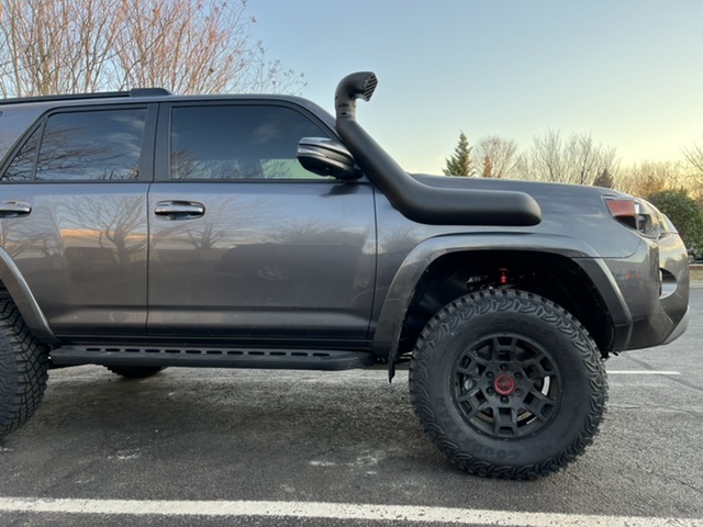

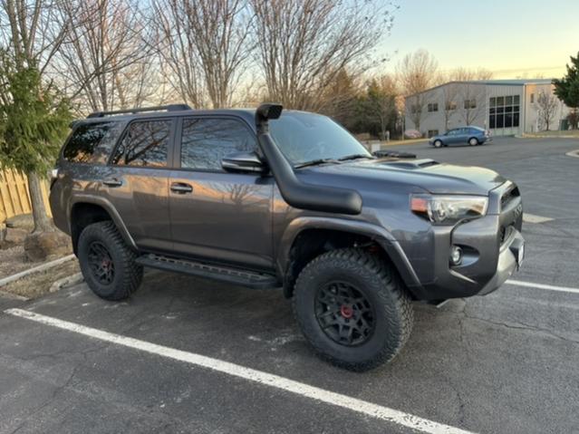

285 Wrangler Territory MT, Lift, UCA’s, skids, kdss spacers, rear track bar relocation tower, snorkel.
Came out great. 3” front 2” rear on the toytec lift. Spacers and kdss balancing worked as intended.

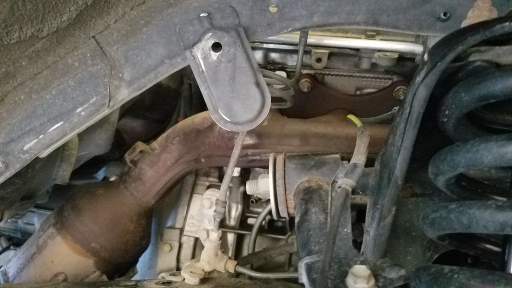

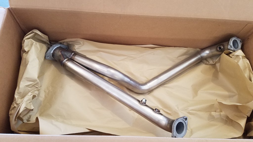

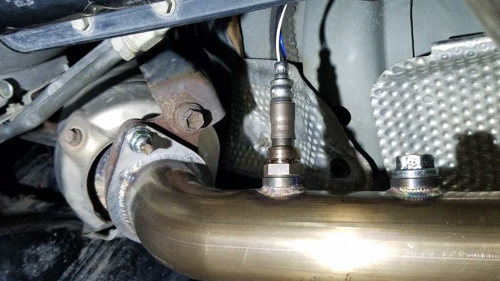

dang I got lucky lol. Bolted up as if it was on there from the factory.
Ha yeah that's what I was expecting but this truck is coming up on 200k miles so that's the way she goes. I was also driving around for way longer than I should be with one of those flexible exhaust repair pipes clamped on one side after a downstream cat was stolen (along with the o2 sensor) so I think that manifold probably warped a a bit.

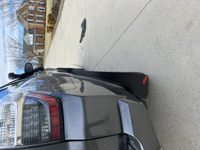

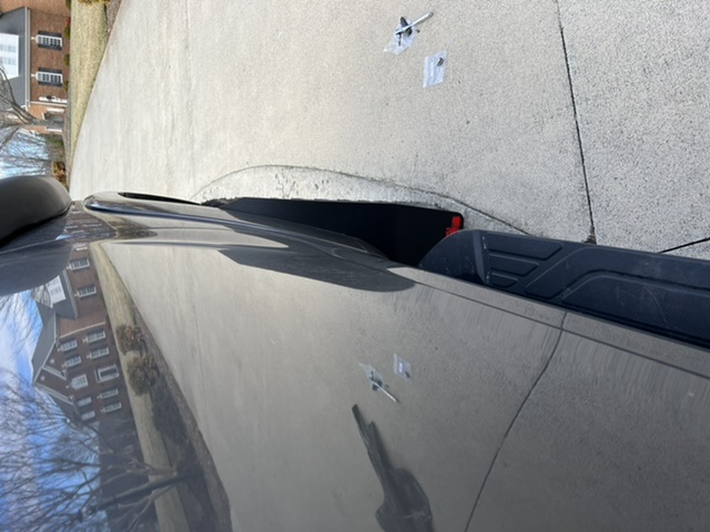

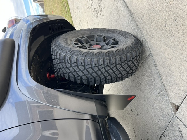

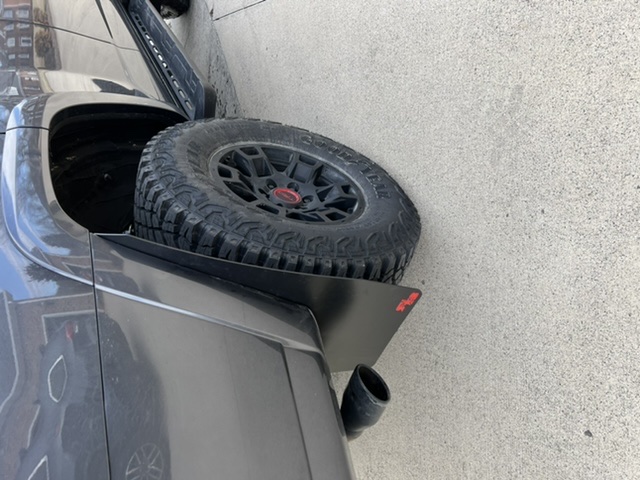

Installed Rock Blokz to get more spray coverage and take care of driver front mudflap rub.

Ordered a set of original size Rokblokz in OD Green. Viper cut and caster adjust and i'm STILL rubbing the mud flaps in full lock (275/70/17 and -10 offset). I want to go bigger, so I guess this has to happen. Don't really like the look of the Rokblokz but hopefully they grow on me.
