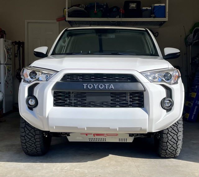

How do you like those tires? Been looking for someone with them on their rig
Only a few hundred miles in, but So far so good. I ended up with them by mistake, sort of. Duratracs went to 2 ply side wall and i ruled them out. Tire Rack told me these were 3, but when they arrived they are only 2. If that doesnt prove to be an issue i think ill end up liking them for a long time. Great on road manners dry and wet, and so far great trail performance.
You can also tell they are a 45lb/corner tire and not a ~60lb one. The truck doesnt have issues with drivability or pick up.

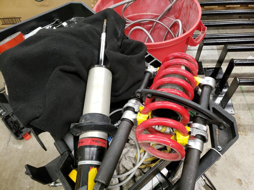

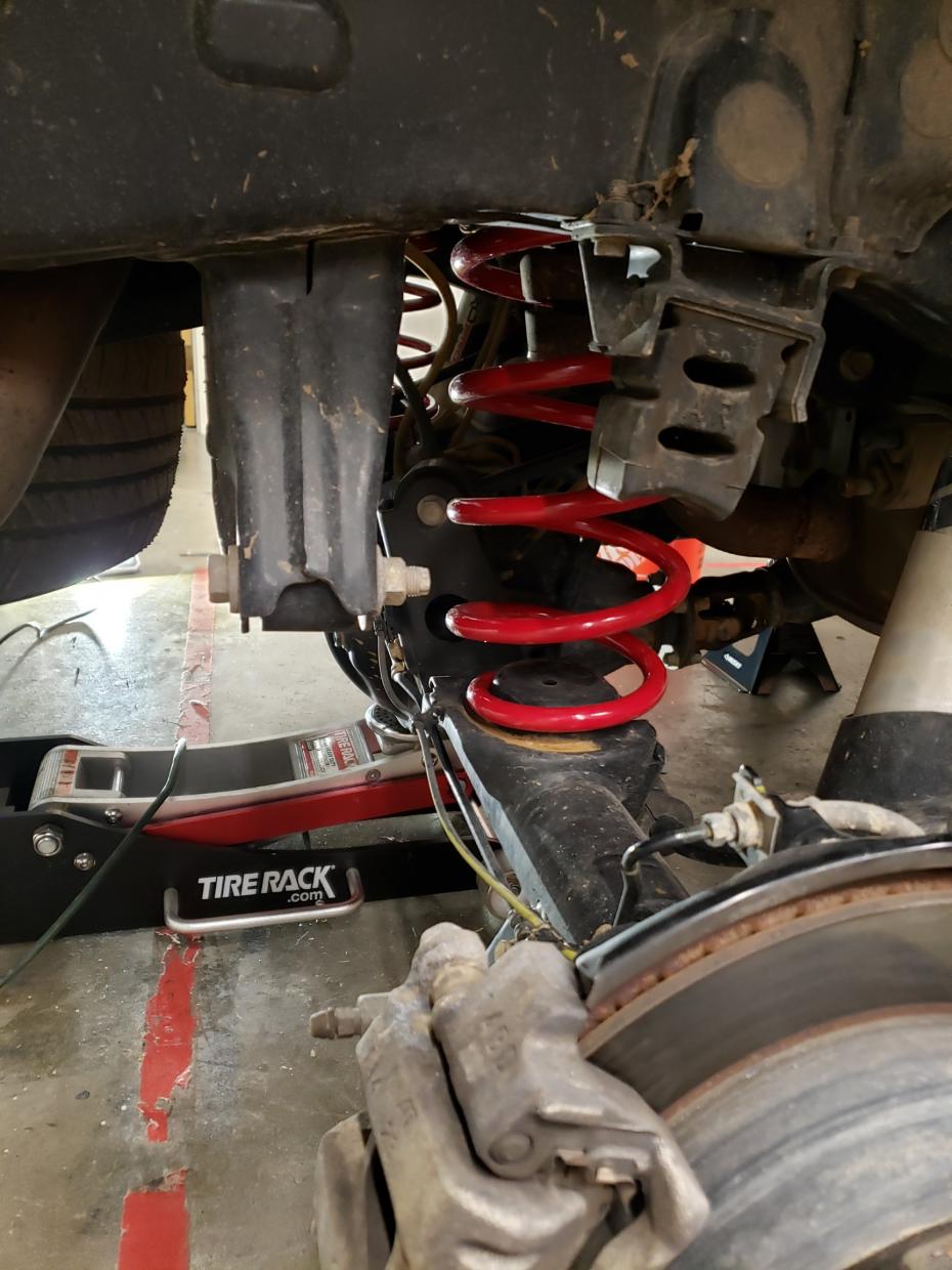

swapped out the stock TRD pro springs for the Eibach pro lift springs.
Pro tip...make sure you replace ALL parts BEFORE reassembly. One of the large washers that goes on the front strut, on the shaft below the tower fell off and i did not notice it. Found it sitting in cart as i was taking apart the other side. Anyways, had to do it twice. But I did get practice, and have the fronts down to about 30 min per side.

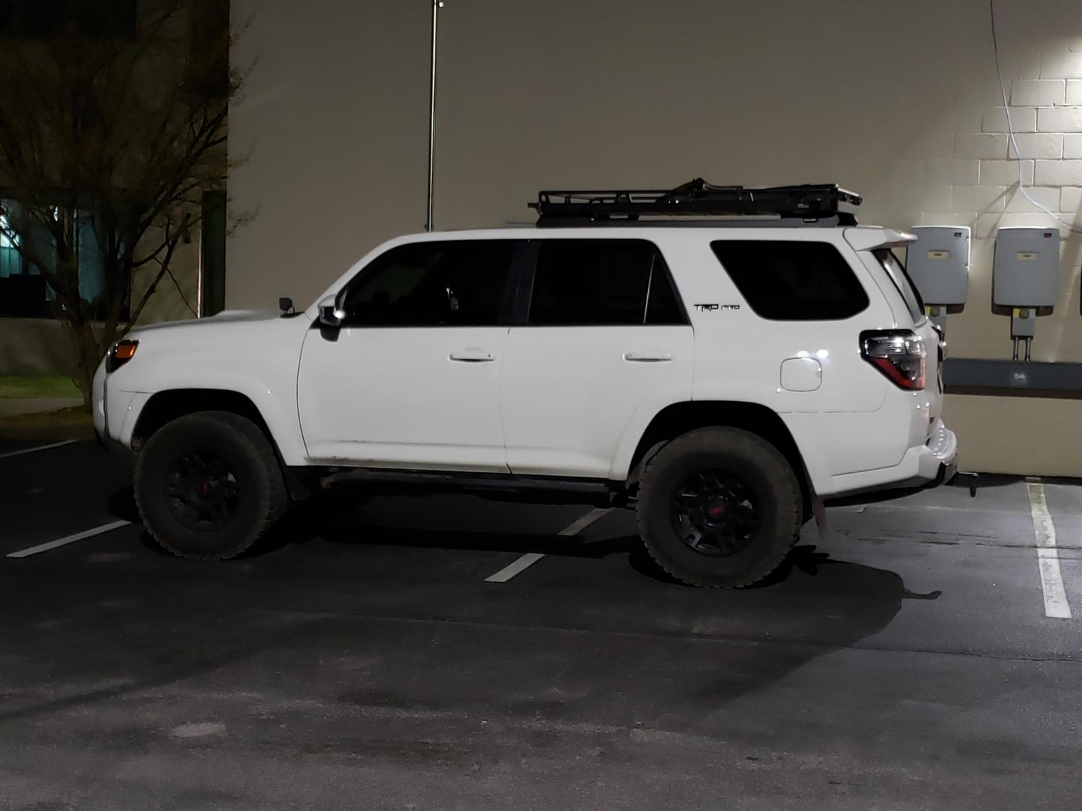

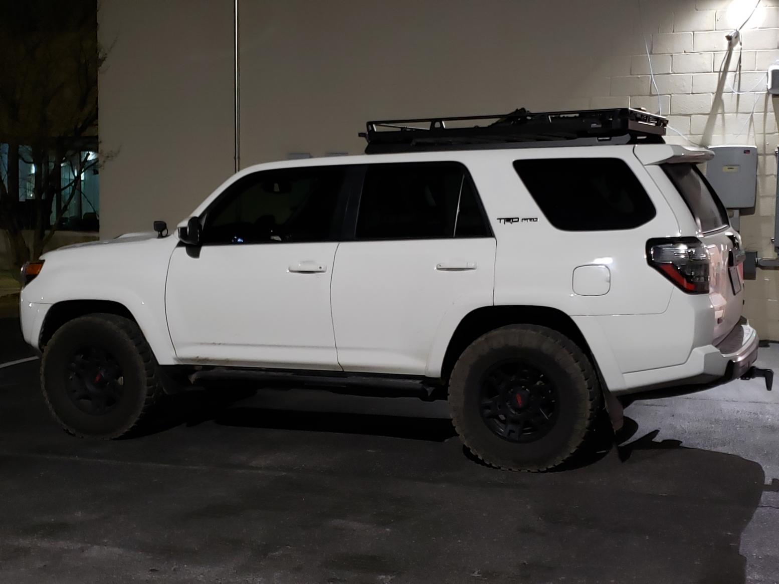

results....front end went from 21" to 23" from center of hub to fender edge.
rear when from 22 to 23 inches.
crappy pics, but it was late at night.

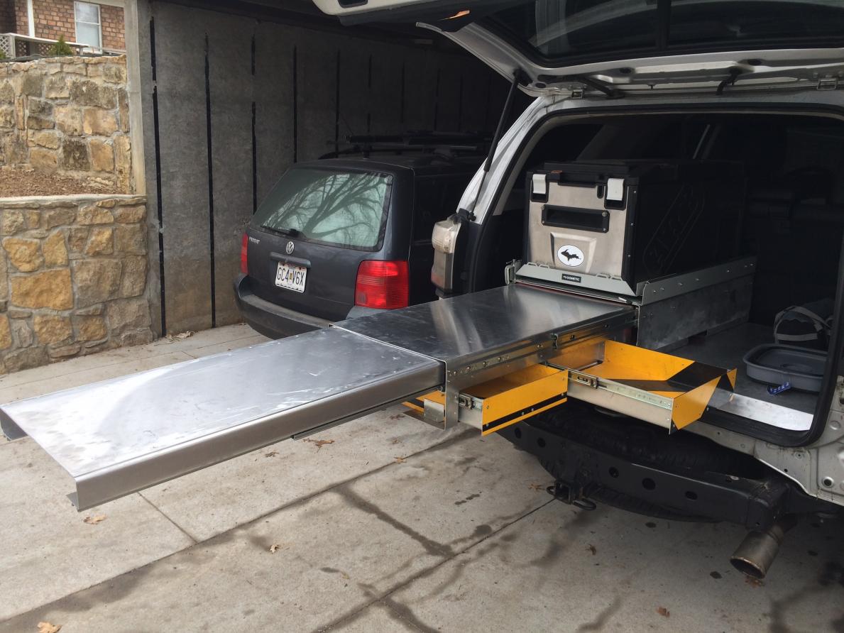

Made a pullout last night and tried it out today. Made from old traffic signs from the scrap yard.
