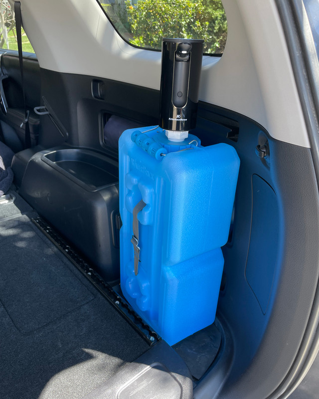

WaterBrick and Electric Pump
Set this up recently and now have 3.5gal of water with a electric pump faucet. This fits well in this space and stays in place with a single strap though the middle and around the cross piece on that plastic cubby space. Finally no more lifting 2.5gal grocery store jugs.
I've been using the 2.5gal water jugs from the grocery store for years because I couldn't really find a solution that fit with my setup. The 2.5gal grocery store water jugs fit nicely vertically in that space behind the passenger side wheel well. But they are flimsy and you have to lift it out, drain water into your Nalgene or pot, allow air in because of suction and then put it back when you're done. I liked the Scepter and pump setups but 5gal took up to much space.
I wanted something that occupied the space behind the wheel well as its nice and out of the way there in all the configurations I have the back setup in, fully packed up, arranged to sleep on one side, and all variations of empty once camp is set up or at a destination and doing day trips. This solution is exactly what I was looking for, sturdy enough and cheap compared to a scepter + $100 electric 12v pump setups I've seen.
Waterbrick on Amazon

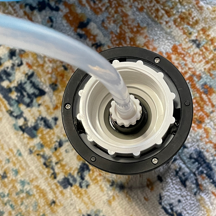

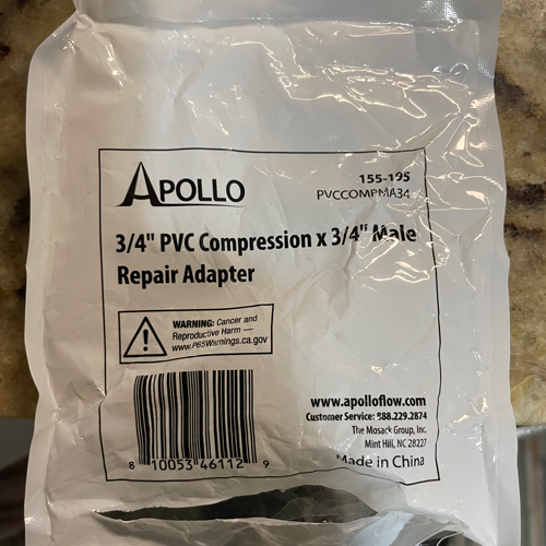

I just saw they now offer their own dispenser, a month a go when I put mine together they did not.

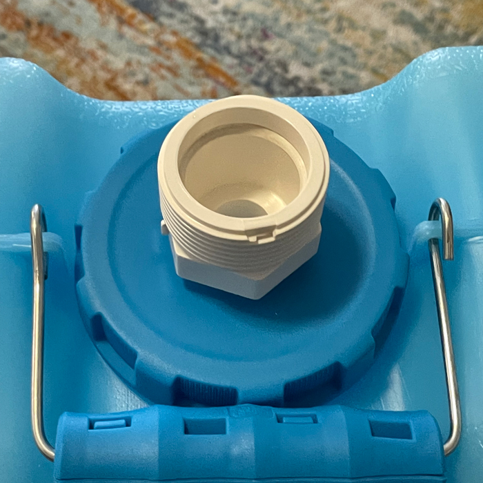

I made mine with a 3/4 inch pipe compression adapter.
One end of the adapter from Home Depot screws right into their spigot cap.
To attach the pump I used some plastic bonder and attached to the underside of the pump I got off amazon. I like the amazon pump because it has water measuring settings so I can set it for one touch to dispense the exact amount I need for my freeze dried meals or cup soups.

Very nice...do you secure it in any way????
Just a simple strap that goes though the water brick and around the center member of that cubby/pocket that's behind it. The weight keeps it down the strap is just to keep it from tipping when it gets bumpy. It's worked very well thus far.

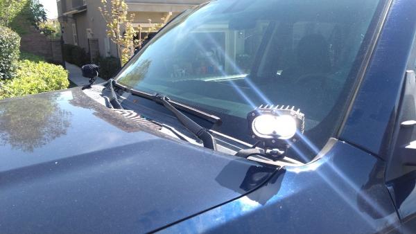

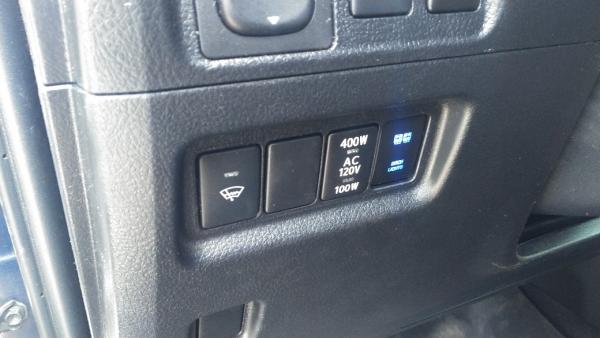

Continuing what I am calling my 'electrical update', I added ditch lights to the hood and wired the switch in the dash. Some ditch lights a friend gave me (might replace with smaller ones if I can find some). Cali-raised low profile mounts and a cali-raised ditch light switch-
I wired it to turn on the backlight only when on (so it can catch my eye if I ever accidentally hit it on (though not like I wouldn't notice if it's anything less than 100% daylight, those suckers are bright!))-
They don't look too shabby on the hood-
The only thing I had to do was shave some teeny tiny tabs on the inside of the switch space (see two 'whitish' spots inside the switch hole) for the cali-raised as the switch was not engaging to the on position due to them-
