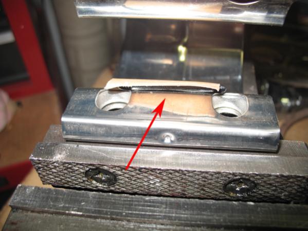

The one annoying thing about the Magnaflow Overland kit is that you have to mess with clamps. I couldn’t get the joints as airtight as I wanted. Tested with a shop vac (on reverse) and some soapy water, no matter how tight I got the clamps (actually snapped one by over-tightening), They all leaked a little. Ended up wrapping each joint in aluminum tape, and covering with a wider style clamp and that did the trick. Welding each joint would be the ideal solution. Might do that anyway now that I know I like the exhaust tone.

When using those clamps, there is a a rubber/tar type material that needs to be put in at the joint. Walker clamps have it. You can also buy a tube of it at Napa etc. Its exhaust black tar material. Nasty crap gets on everything if you accidently step on it, just saying.. ]
But, it seals the exhaust at the clamp joints.
