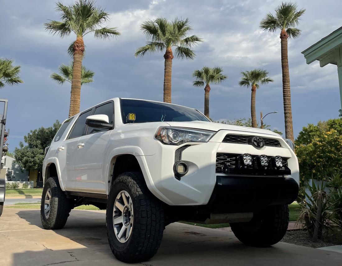

Sorry did a search and dont have all morning, where or how did you mount the the light bar for your lights on the front of your truck. Did you make that mounting bar? Are those Baja Design lights also?
Thanks titan, truck looks great for a white 4runner lol

so its rago fab behind the grill mounts, then i made my own mounts to extend from behind the grille, attached to a piece of aluminum extrusion from tnutz or whoever you prefer. stainless steel button head allen bolts to attach brackets to the aluminum bar. Carriage bolts slide in the extrusion, bolt the baja designs xl pro's to it.
I originally used the rago fab brackets they sell to go from behind the grille to in front, but theyre too short so I made longer ones (i think i used 1/4 or 3/16", just what i had laying around).
has a little vibration that can drive you nuts, so i added some reinforcement to the rago fab brackets. (they only bolt to the bottom brace, no support at the top, i added supports to the top that tie in to some of the toyota sheet metal)
the bar is anodized black, i have a raw one as well, since i ordered it first to make sure my measurment was correct.
wiring is baja designs 2 into 1 harness then into the normal harness meant for the XL 80's, which pull way more power. no issues with all 3 lights on one relay and switch, i verified this with SDHQ as well.

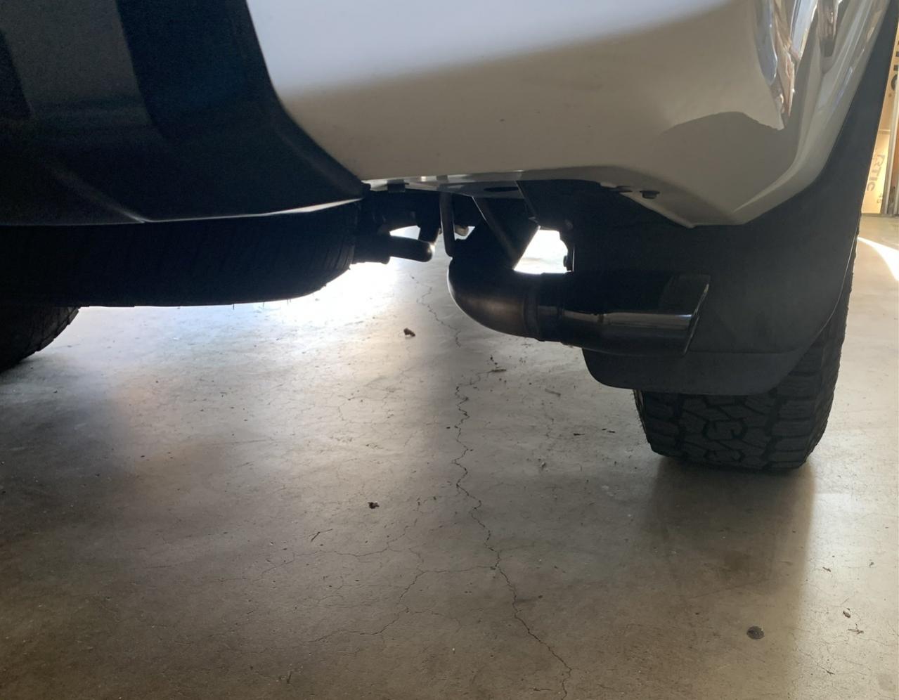

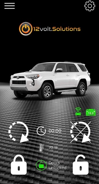

Added a remote start and TRD exhaust yesterday. The remote start is awesome but I'm iffy about the exhaust. It still needs to break in.
Oh man...the DRONING of the TRD exhaust...i replaced mine with the regular muffler and kept the side outlet trd pipe....
and as far as "break in"....I dont know why people always talk about that...I can understand break in of an old style glass pack type muffler......but modern mufflers and resonators are a series of chambers and baffles that are all steel and do not "wear" or break in. Its more of you just getting used to the drone than the muffler actually changing tone. Those are my unsolicited thoughts, but if anyone can explain muffler "break in" then I would love to be educated.
one final note....i could see carbon buildup over time changing the tone, but these are modern engines and thats not really a thing.
I'm still on the fence about it. 2K is where it's most noticeable but I don't get it too bad until I give it more throttle. If I ditch it some kid will buy it up quickly so that won't be an issue.
There's still carbon/soot as a result from the combustion process. There was carbon/soot in my stock piping.
