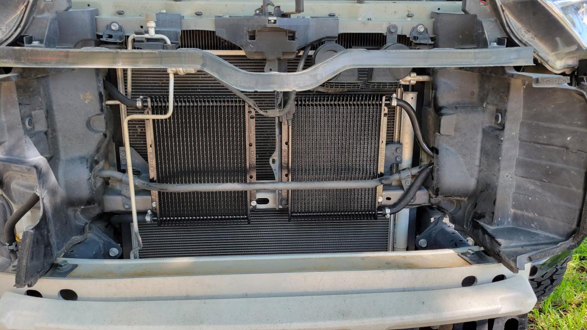

installed aux tranny cooler and aux power steering cooler in combination with my electric brake controller, timbren SES and WDH I believe I am ready to tow!

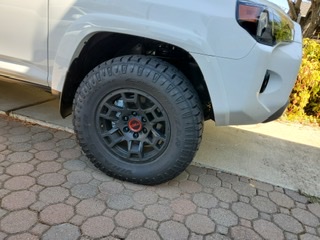

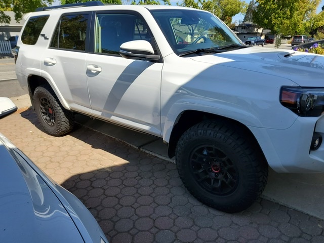

Here she sits with front Bilstein 5100’s, clip set to lowest setting, 1/4” Supreme Suspension leveling plates on each strut. I was rubbing at full turn on fast “whoops” without the plates. Front measures 21.0” fender to center of hub. Rear measures 22.25”. Drives great. Much better steering response and stability with the bilsteins.

With the new setup: Front measures 21.0” fender to center of hub. Rear measures 22.25”. Knock 1/2” off the front for the height without the spacers and bilstein height ring set to lowest notch (about 20.5”).

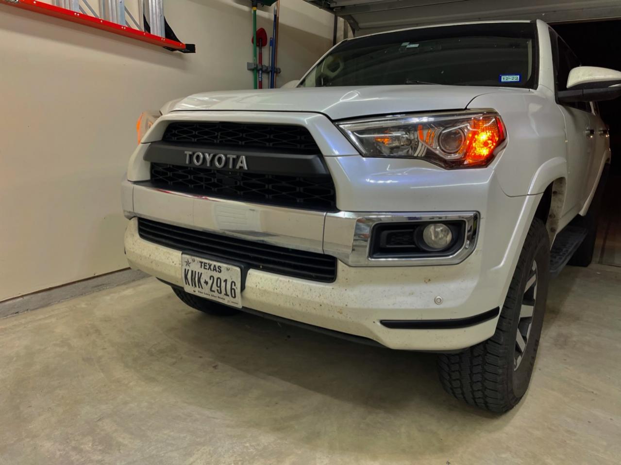

TRD Pro garnish on my limited! Perfect fitment without trimming. Very excited about this mod!

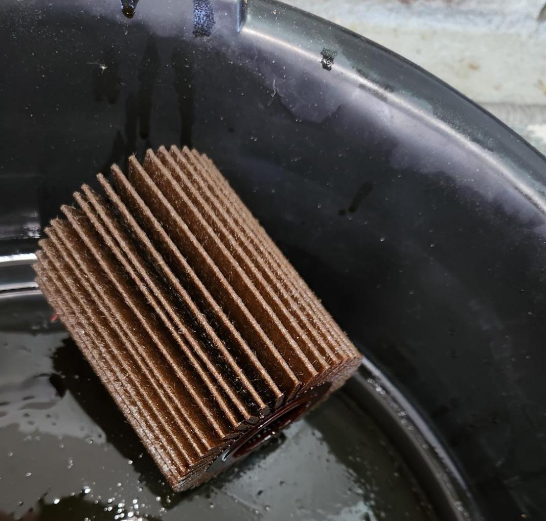

Here is filter at 6000 miles. Dealer did it prior to sale.
