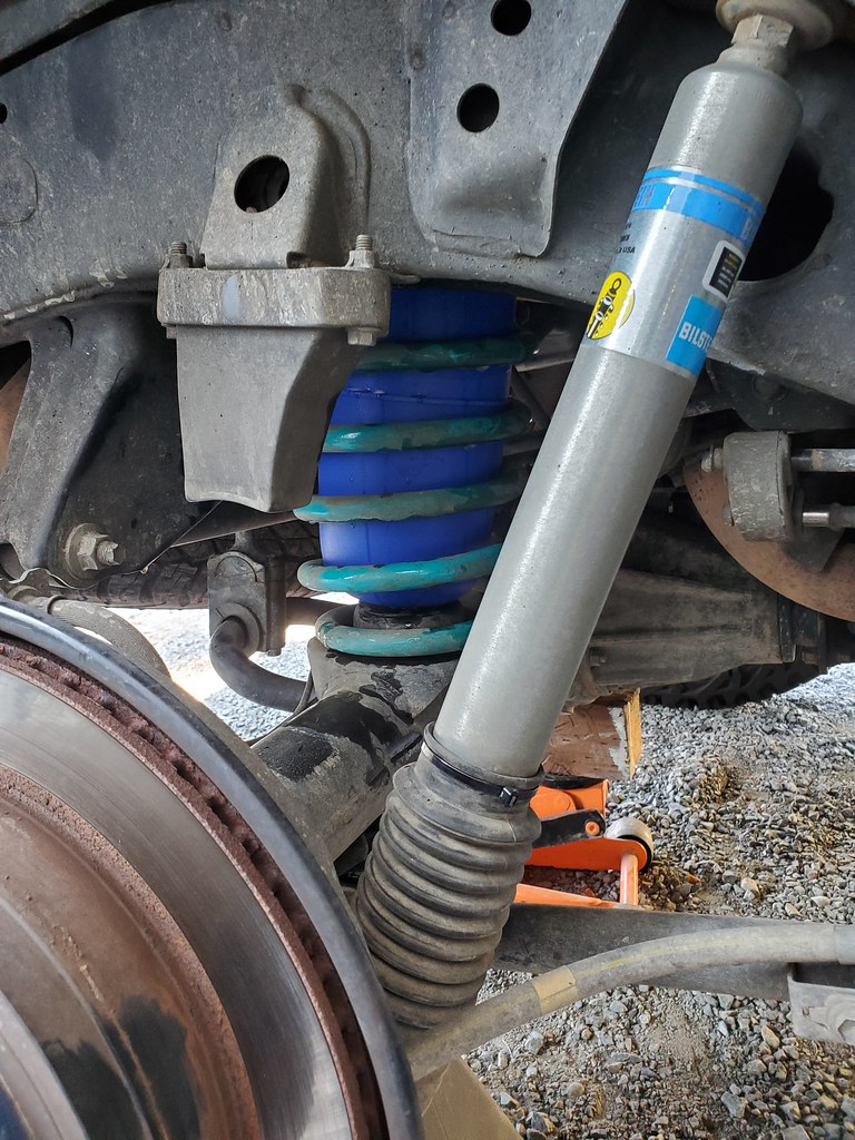

Installed Firestone Airbags yesterday. They were a pain in the butt. I had read how hard it was to cut the bump stop inside the coil, so I figured it would be easier to remove the rear shocks and pull the coils out.
It was not easier.
In other news, I am now intimately acquainted with the entire rear suspension.

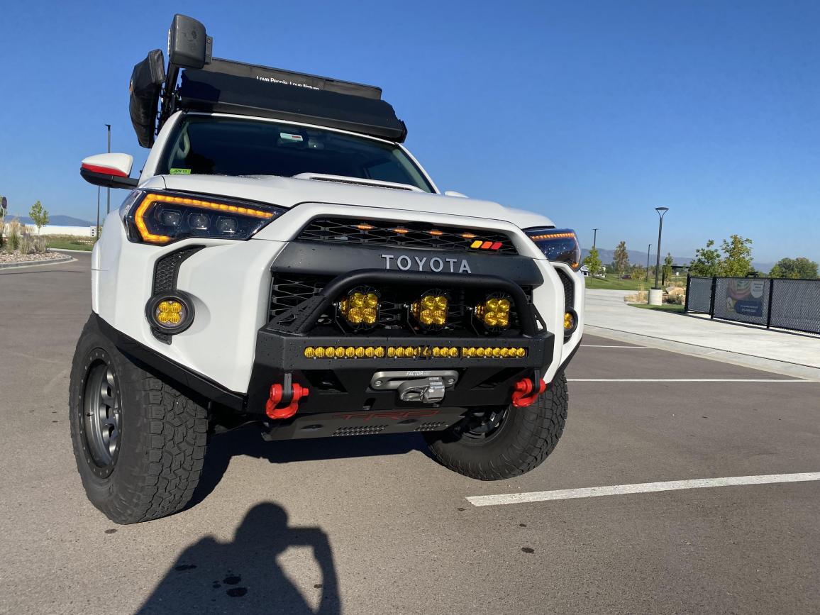

Recent Mods
Well not "today", but more like this month.

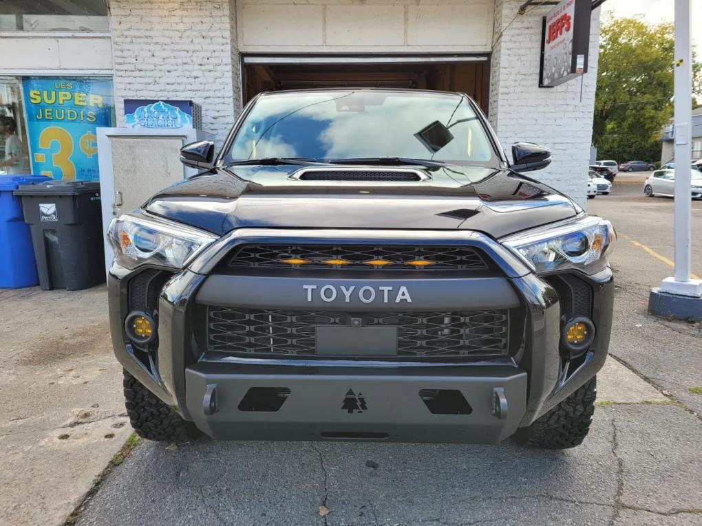

Before I had my C4 bumper powder coated I drilled holes for Baja LP4 lights. I have not seen this combo before. Function is pretty awesome!

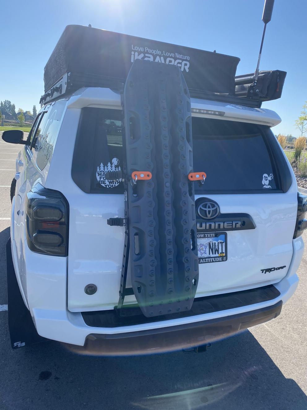

Second, I was sick of my traction boards being on the roof, even worse when I had to have them on top of my tent. I bought GP mounts with the flat mount kit, some stainless L brackets and hardware (anti theft) from McMaster to come up with this much better solution with my C4 ladder.
It was not easier.
The moral of this story is to Install Firestone airbags at the same time you replace the rear coil springs. Right?
lol yeah, if you are going to replace your rear coils, definitely do the airbags at the same time!
Agreed. The airbag install into the coil and running the air lines was a breeze. The cutting of the bump was a royal pain in the a**. I found a crappy knife and a propane torch to heat it up and it got the job done with a lot of cursing. I started with two rungs and that was "ok." The third rung was miserable, but got it. 4th would be impossible without removing the rear coils.

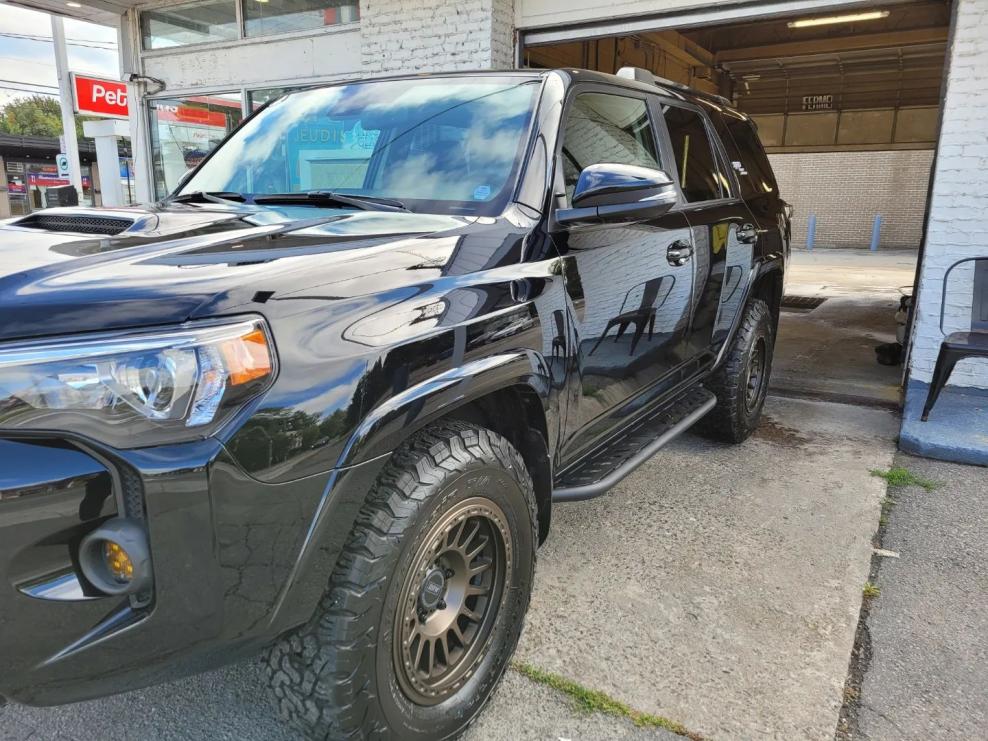

recently hit a freshly yellow paint line, cried a little inside, end result after a steam wash and a little detail.

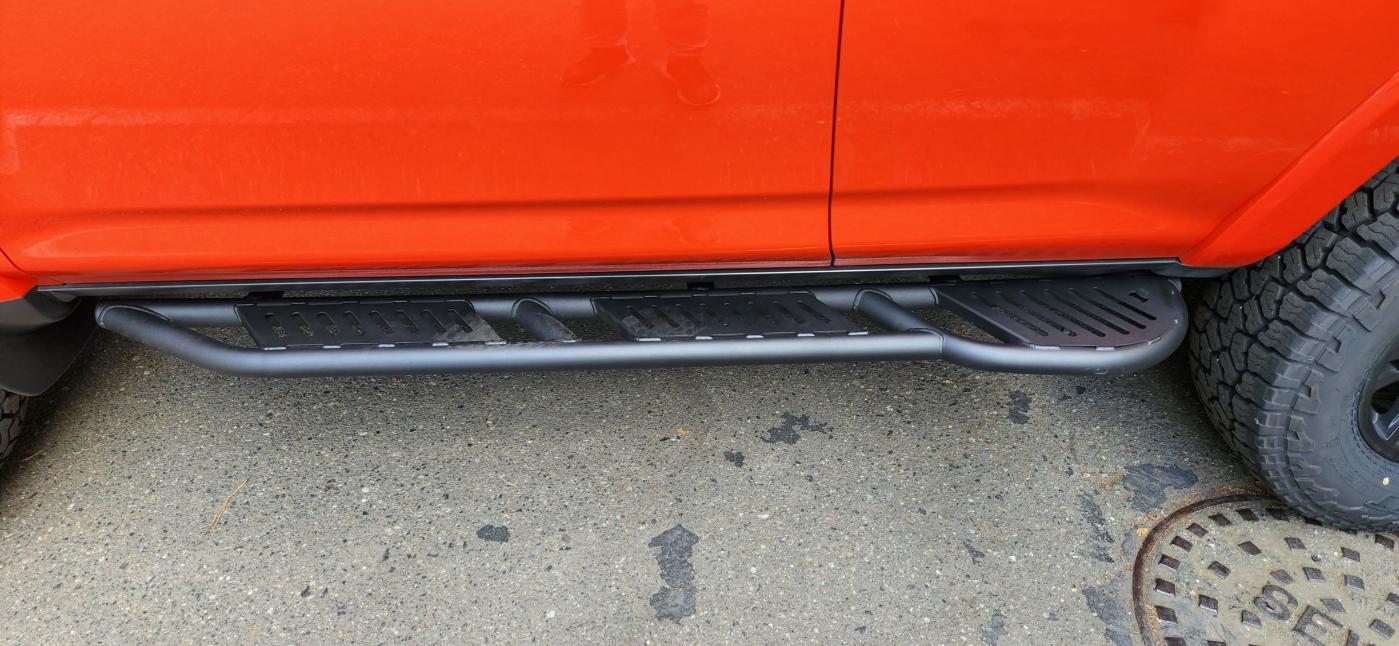

Westcott Designs sliders installed. Specs on them: DOM steel, MIG welded, 0 degree, black powdercoat, w/ top plates and kick out. They're super solid, fit and finish is spot-on, and made right here in the USA.

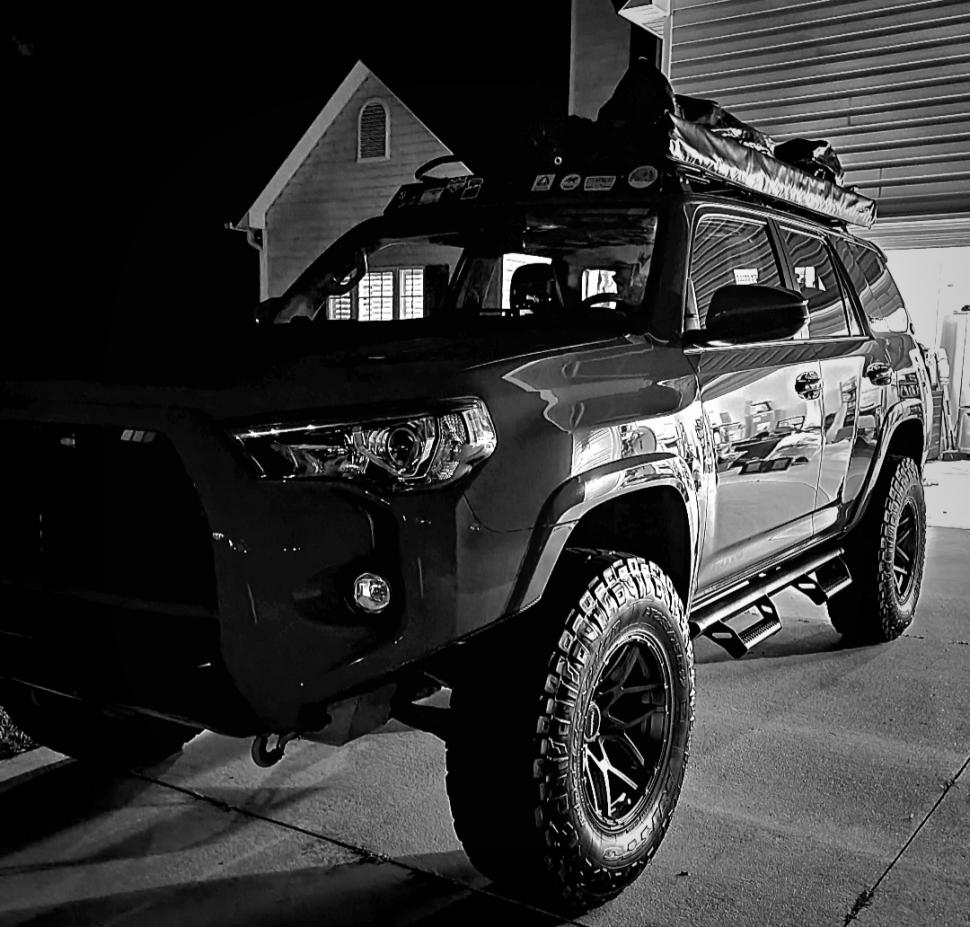

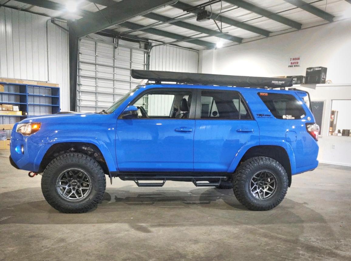

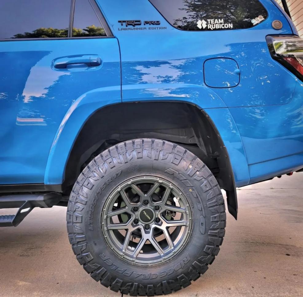

Not today, but late on posting

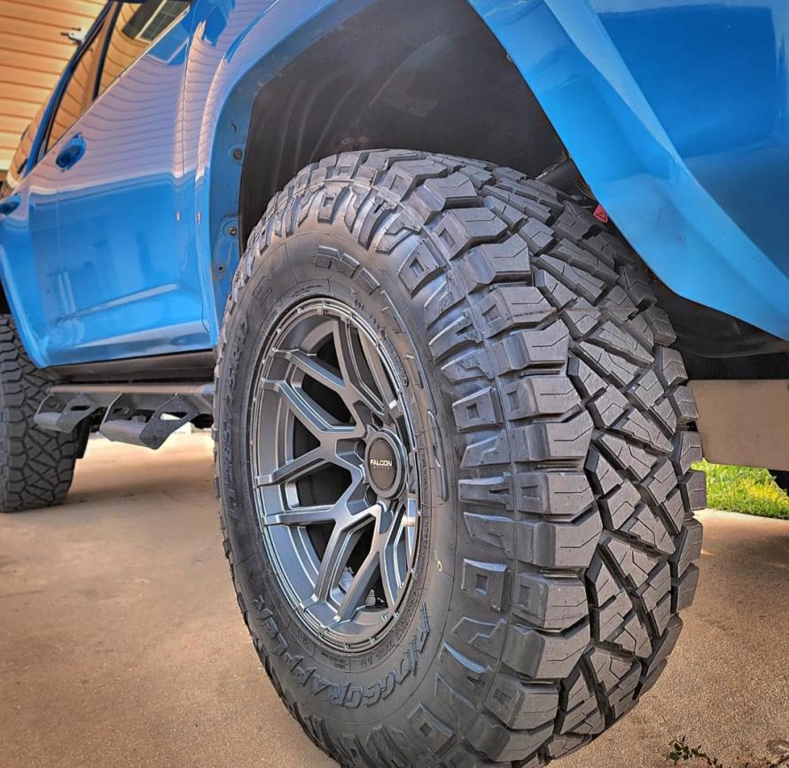

Been crazy hectic with starting a new job and getting a kid into college, but I finally got the OME BP-51, Nitto Ridge Grapplers and the Falcon Off-Road's installed. Not too big, just a more aggressive stance and meaner look.

So how do the bp51s perform? Initial impressions?
So I went on a camping trip up to Flagpole Knob in VA a few weeks after I got them installed, and I have to say I think they performed pretty well. I like how they handle on the day to day driving, it definitely has a smoother ride than the stock Fox I had on there. Now, on the other hand the "adjust on the fly" shocks for compression and rebound is supposed to be really easy, but I've found it is anything but. To make adjustments on the rear, you either have to take the rock guards off or the tire to get the spanner wrench or remove the tire entirely. The front you can kind of get to, but the coil over spring is in the way making it hard to get the spanner wrench on to make the adjustments. I did some research and had the compression and rebound at 1 for the off-roading/ mountain climb and that worked great, almost like the feel of making the ride smoother like airing down the tires. For everyday driving I have them set at compression 5 and rebound 6, which is a pretty smooth ride to me. I've just got to weigh on how the long the next off-roading adventure is going to be to see if it's worth taking the tires off to make the adjustments. I'll try to post some pics of the coil over and rear to show what I mean.
