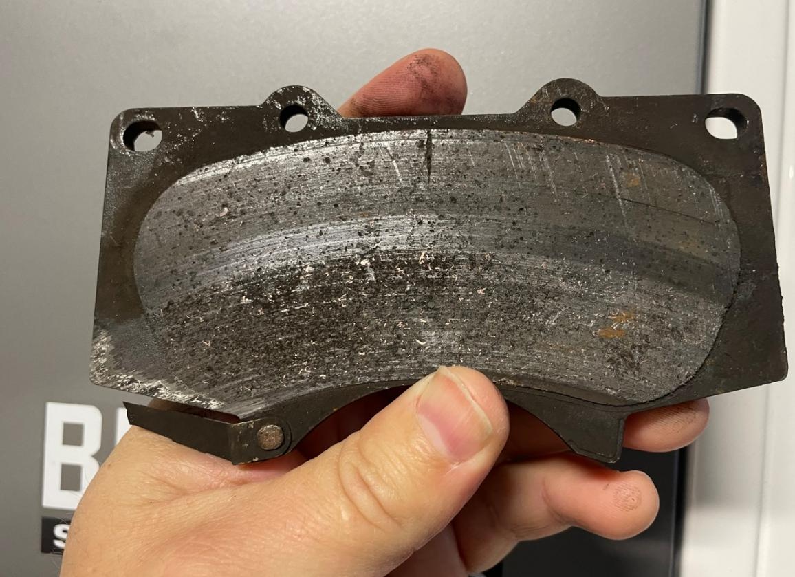

Just replaced the original pads and rotors after 78K miles. Went with Akebono pads and Wagner rotors. Feels great and stops on a dime now....not sure why?

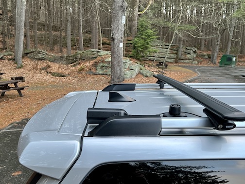

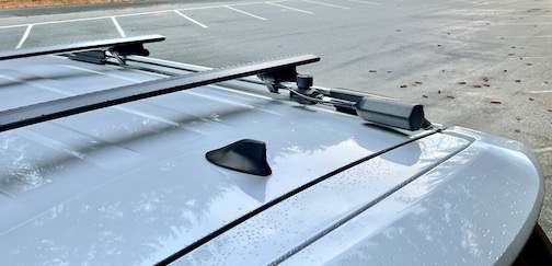

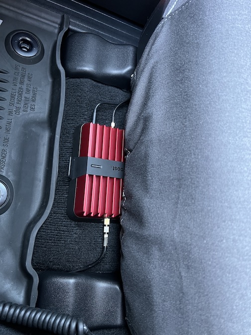

Installed the Weboost OTR Drive, so far (even without raising the antenna) have gone from the finnicky one bar spots to full 4 bars 5G LTE on the iPhone.
Used 2 KC Lites wire hiders to go through standard firewall spot.
Ram mount w t bolt in factory rail for antenna mounting.
Unit sits under passengers seat (forward so I can see the light easily when on)
With the Thule Cargo box on, antenna sits just a half of an inch higher.
Box shouldn't interfere w signal as long as it's not full of sheet metal.
And awning sits out bit and antenna is well above that.
Will have to do some more in depth testing w speed test apps, but so far almost double the speeds in certain areas. If there's absolutely no signal this won't give you a signal but there are plenty of times that no bars show but there is still a weak signal, this is where the unit really becomes useful.
Tried to keep the install as low-key but efficient as possible. (no giant mast and cables running through the doors)
