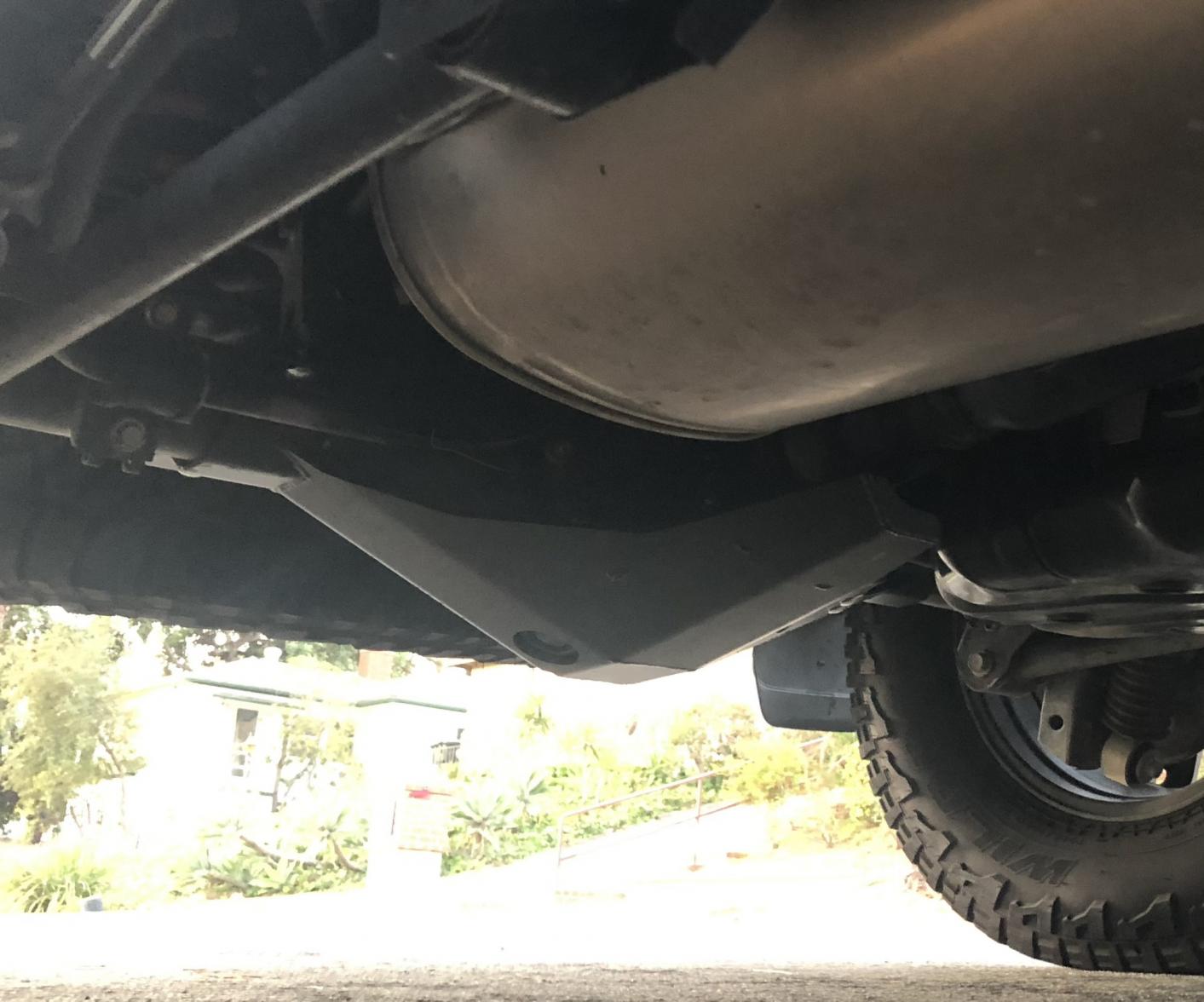

I stayed away from the Rago style shock guard with the angled wing for the same reason as Honda250 stated. I added the boots to my rear Radflo shocks as I sometimes hit speeds of 50mph through the desert. The FJToyman skids protect your shock bolts also.
I have a C4 diff skid, which I think is the best one out there, as it has a longer snout to better protect the u-joint and has a e-locker guard for ORP and Pro models with the rear locker. I also heard that it bolts up to the rear diff better than the other ones. Not sure about that.

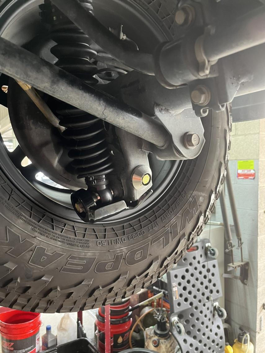

Added the sky jacker rear sway bar links (SBE702). I have about 1” rear lift and these worked perfect.
You can see the links are exactly 1” longer but could easily be extended to 2” with a shim below the bottom washer.
Maybe it’s the placebo effect but the rear end feels like it’s been freed up. Almost like the sway bar is more willing to flex and let loose. If that makes sense….
Bonus pic of some light testing. I wanted to see the angles of the links and to see if anything was making contact. Didn’t get pics of the links at full flex but everything looked healthy.

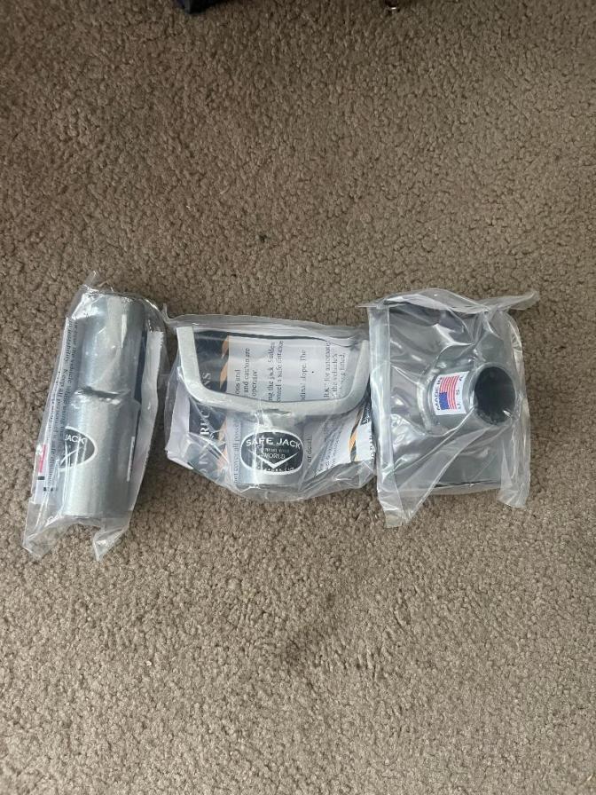

ditching the hi-lift and going with the safejack accessories and a block of wood.
Bought only the accessories, tried to modify OEM jack, it did not work. I have to buy a bottle jack now.....oh wells..

Just switched as well that’s why my hi lift is for sale. You need 09111-35150. Then drill out the cap
DOOOD YOUR AWESOME, yeah i wasn't paying attention to what generation 4runner jack i needed....thanks broski!!!
That’s why we are here! I would also consider making a platform for it for sand and mud. It fit perfectly in the hi lift base so I just drilled that as well and threw some bolts, threw it in a harbor freight case. Done.
im trying to find a way to bolt the base under/outside of my dual jerry can holder, but it has to be inconspicous, so i got some idea's in my mind.
i have my hilift base around and some wood. I just need to figure which hides better in the truck..lol.
