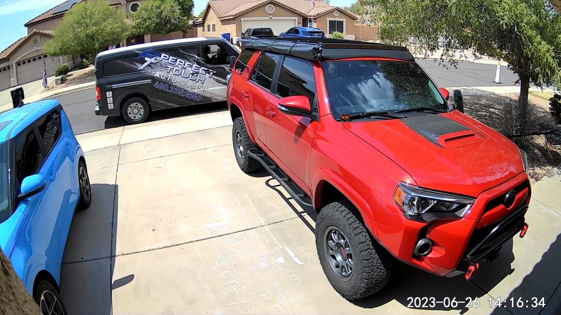

Nothing too interesting replaced the windshield and did full windshield tint. Hoping bumper gets here next week to install

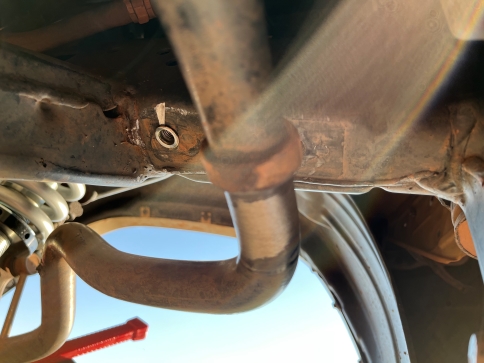

Last week I replaced the Bilstein shocks with Eibach. The Bilstein's were shot...
I removed the sway bar mounts to make it easier. One of the nuts inside the frame rail broke loose from its welds. I had to cut the bolt.
I used a rivet nut in its place. Worked great.
