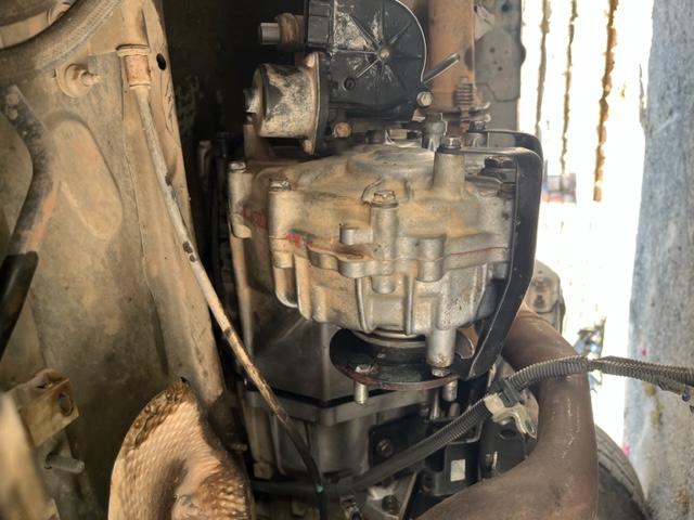

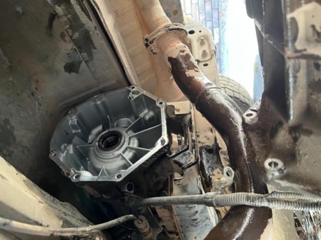

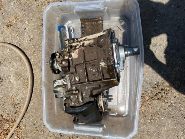

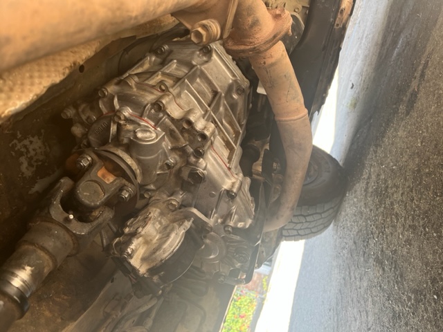

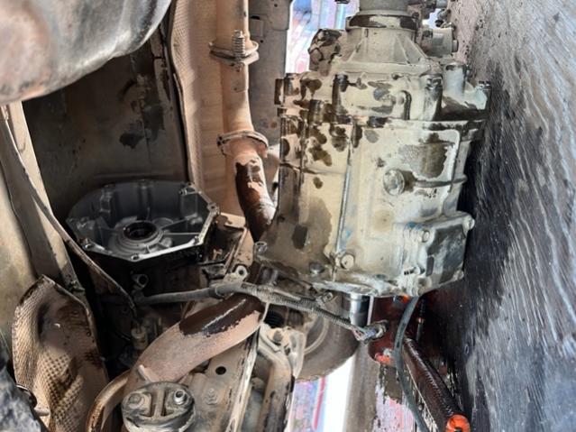

2014 SR5 with 336K miles. Transfer case input seal was leaking, so I pulled the transfer case. It dumped about a quart of gear oil when I split the transfer case from the transmission. Already purchased the transfer case input seal and rear housing seal, but when I saw the rear seal to the transmission, I knew that should be replaced while I’m in there. That seal will arrive Tuesday am at the local dealer.

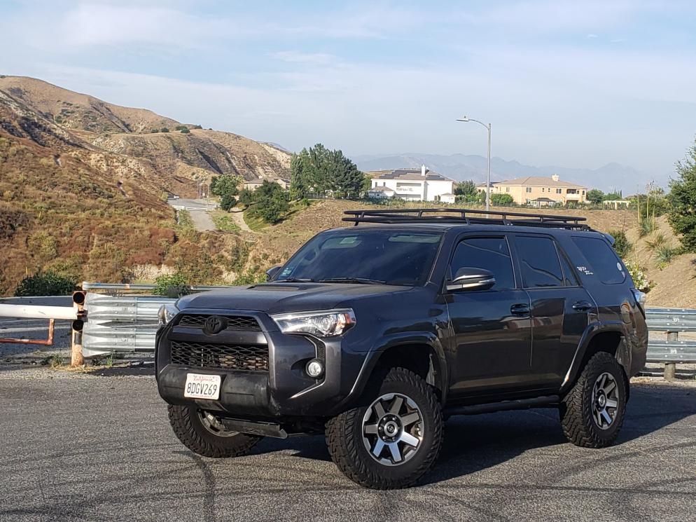

Went and switched out the 285/75s for 35x11.50s. Put it on the RTI ramp and everything clears so now just got to schedule a regear but torn between 5.29s and 4.88s. Nice Miami Vice style pic to commemorate
I am going to be running 285/70/17s and am carrying a ton of weight, and tow a lot... I was thinking 4.56 would be good, but you're making me think about 4.88... (famous last words) I won't be going bigger tires, so I can't imagine needing 5.29.
This is like the first "real" maintenance that I've seen on here in a long time. And look at that mileage! These vehicles are amazing. Makes my 191k mile 2011 look like a baby in comparison.
Do keep us updated (or start an independent thread), as some of us will need to follow your lead at some point.

Yeah I often joke about the lack of posters with mechanical ability on these forums, but it is largely due to the reliability of these vehicles. Instead, most of the posts here are about installing rock sliders, lifts, shocks, roof racks, ladders, roof tents, etc. If I need an internet fix from good mechanics, I visit TheTruckStop.us where there is a bunch of good 6.5 diesel mechanics.
This 2014 4Runner gets used for the purpose it was bought for: Mainly highway miles back and forth between home in SoCal and ranch in Montana, with some off-road driving for geocaching and exploration. It is my wife’s truck and she accounts for most of the miles and she does it alone most of the time, so I need the ultimate in reliability.
I’ve always worked on my own cars. As a teenager it was out of financial necessity. Now it’s certainly not due to financial necessity. Rather, I enjoy the work and it’s a diversion from the day job. I derive satisfaction and love the independence it affords me in that I am not reliant on anyone to keep my vehicles running.
I could have paid a mechanic in Montana $912 labor only to do this job. My wife could have driven her 2023 ORP to SoCal and the 2014 would have been done when she got back to Montana. He does good work, but I know from experience that he would have not cleaned all the grease off the transfer case or the transmission. He just throws the repaired greasy pig back in the truck. So I did this job over the weekend while my wife was visiting life long friend in Texas. It will be ready for her to drive back to Montana at the end of this week.

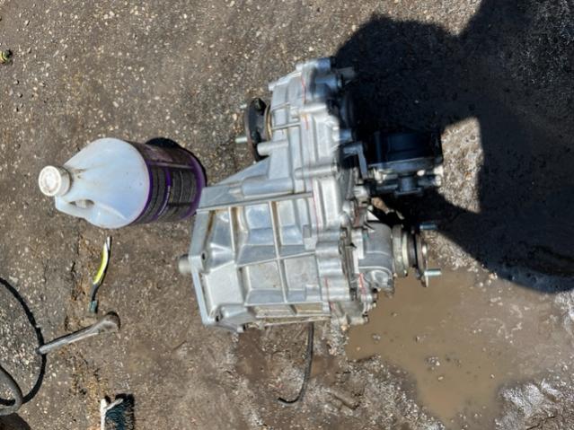

Had a break between meetings so I installed the transmission seal and the transfer case. Later on installed the drive shafts and filled her up with Mobil Delvac 75w90. Everything works great and it looks pretty clean under there.
