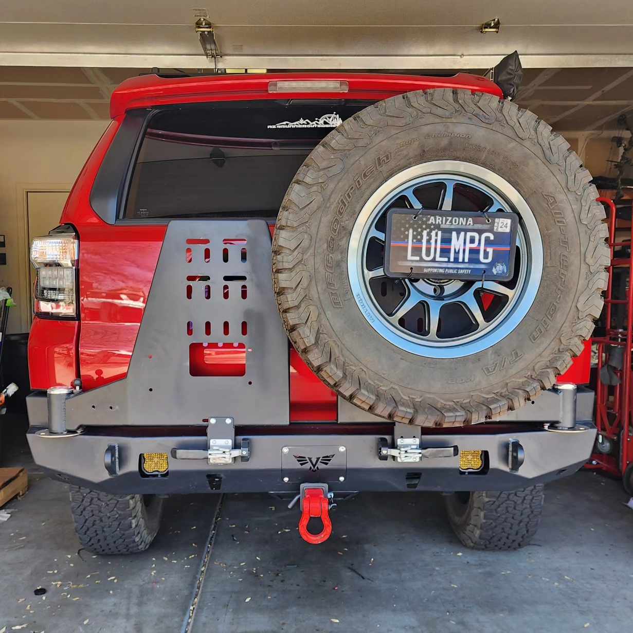

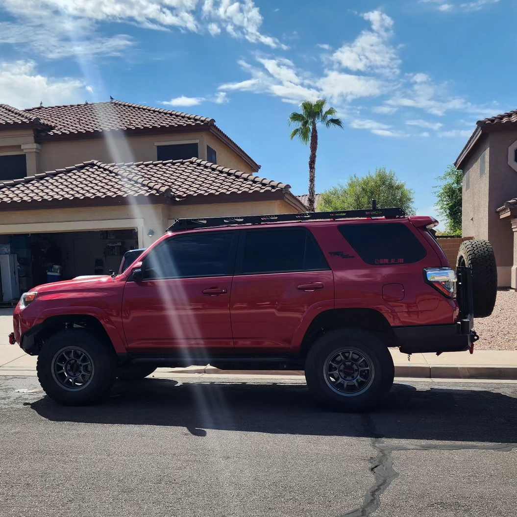

Installed my Victory4x4 dual swing outs and tire carrier.

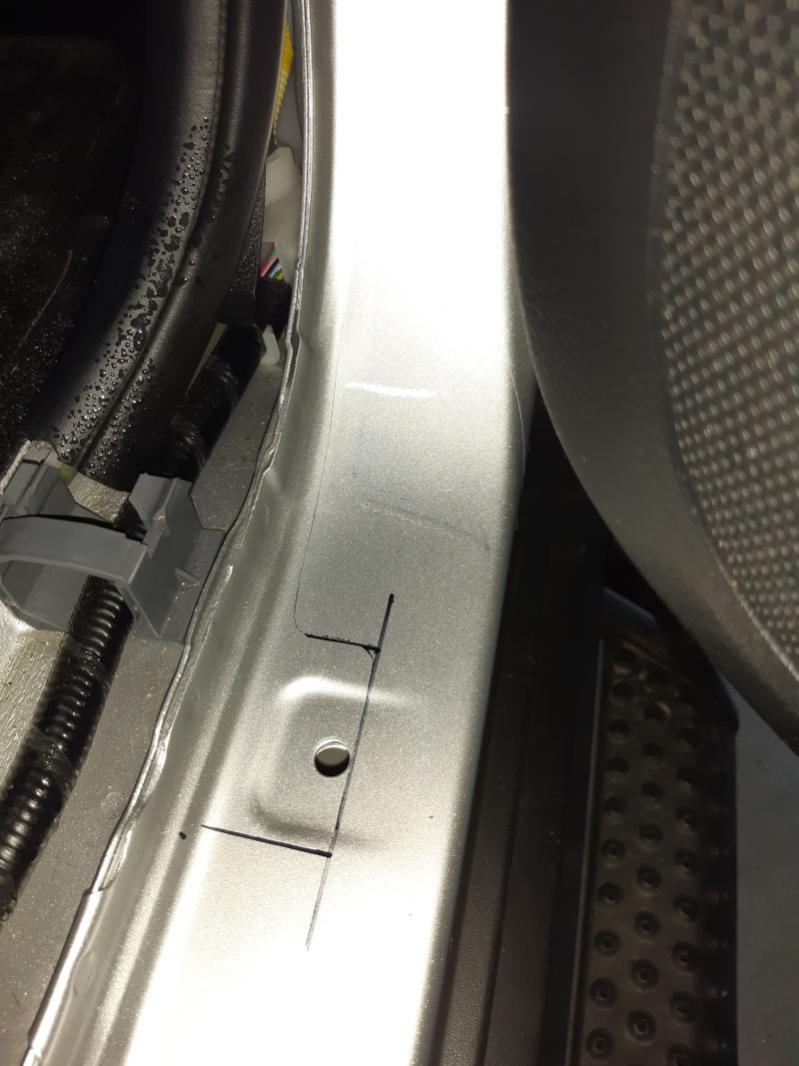

Installed a couple of things, one useful, one a bit more cosmetic-
I installed a dual USB plug in my center console. The 4Runner sorely lacks some USB plugs and the one provided in the front dash for audio input can charge, but is woefully low powered. I've been using the cigarette lighter and eyeing the two blank buttons in my center console so I finally bought a dual USB plug and installed it-
I tapped electrical off the dash cigarette/12v and ran the wires inside the console to the button blank. I had to fiddle with and replace a faulty connector the plug came with, but it works now and I am pleased. Note the rubber flap to keep crap out of the plugs (not like I let the inside get dirty or anything...).

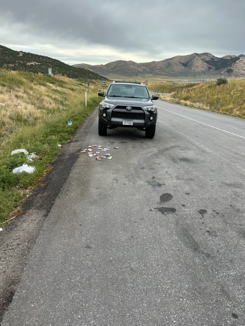

Drove 1243 miles from our ranch in Stevensville, MT to our home in Fullerton, California. While doing the drive, a friend whom I’ve been helping with his search for retirement real estate property in Montana sent me a fly over video of our property. Now you can see why I can’t get my wife back down to Fullerton, CA:
El Capitan Loop - YouTube

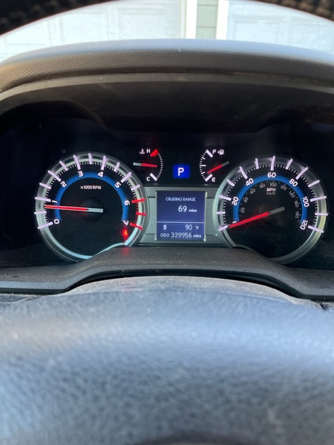

The 4Runner performed flawless and it’s right at 340K miles. I stopped at the Dog Valley turn off from Interstate 15 and cleared the on-ramp side of aluminum cans after a a restroom break. I picked up approximately 100 cans. On a previous trip earlier in summer, I cleared the off-ramp side plugs a couple hundred yards of Dog Valley Rd to the west and stopped counting at 200 cans. This is jus the south bound side and I don’t bother picking up glass or plastic bottles as they take up too much room. Just amazed at how some people are just pigs. People literally just dump bags full of trash. Oh and Bud Light wins the can count by a large margin. The recycling fees will cover the fly line I just bought.

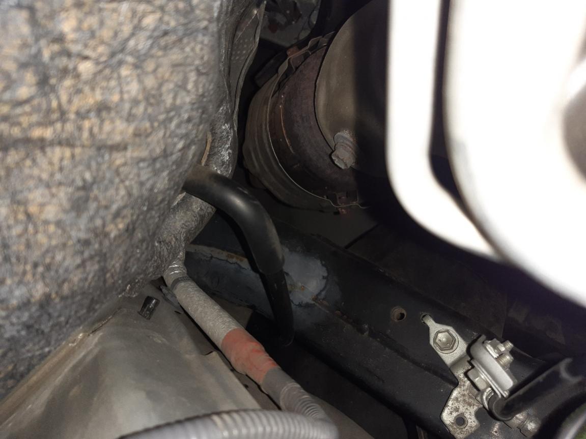

What is the AC drain hose extension? What exactly did you do?
I will try to explain, sorry my English ist not the best.
The last few days there was a relatively large amount of water coming out of the ac drain hose. All the water drips directly onto the frame, then runs into the frame and comes out the bottom. This can cause the frame to rust as well.
To solve the problem, a hose extension is attached so that the water exits directly below next to the frame.
Tacomas and fj cruiser seem to have the same problem, there are several articles on the internet. See also here with pictures:
Tacoma AC Condesation hose extension mod | Tacoma World
I simply put a piece of 10mm plastic tube into the AC rubber hose and attached it to the bottom of the frame (black tube in the picture above)

Found it. Easy enough, has everything sitting in my drawer to make this work. I could see surface rust already starting on top of the frame there.

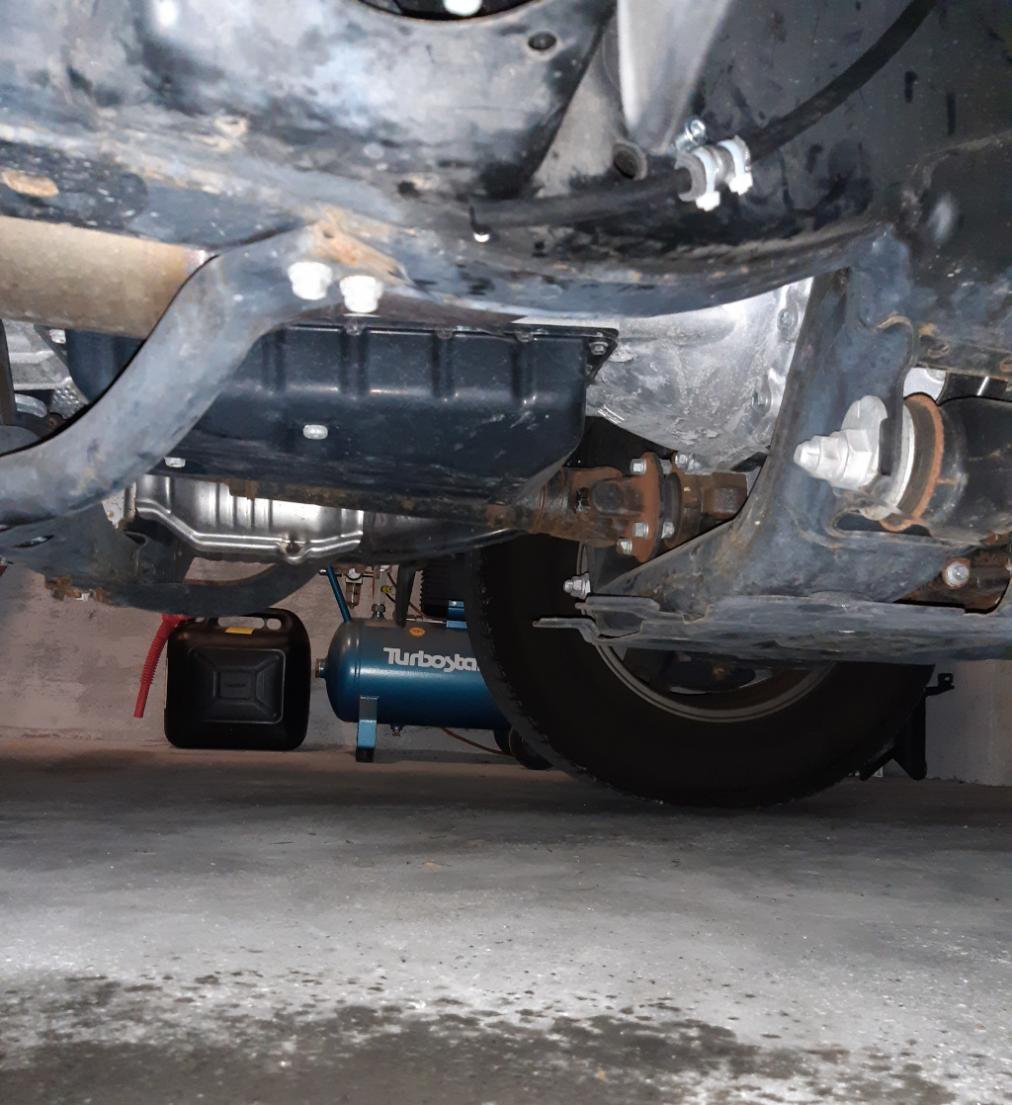

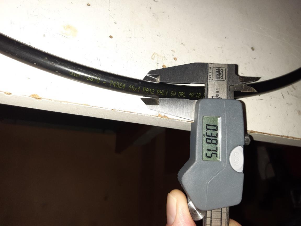

What size hose did you use for the drain extension? Thanks!
I used a black plastic tube with 10mm outer diameter, which should be 0.3937" or about 3/8"?
I was able to insert this tube directly into the rubber hose, and so far it has held without a clamp.
For a hose clamp i would probably have to use a firmer tube or some kind of transition piece like others have done.

So safe to say the factory tube opening is 3/8"? Just want to confirm as I plan to use a hose to hose coupler with some clamps. Just want to make sure I buy the right size. Thanks!
