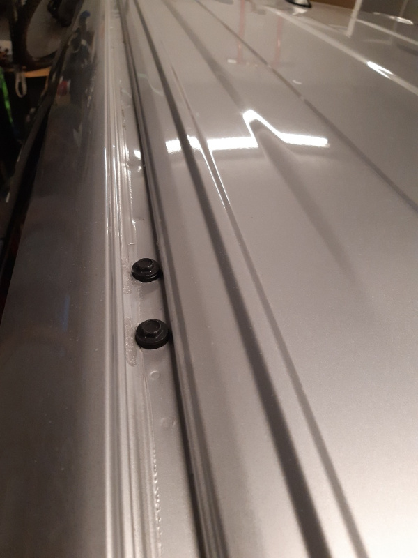

Small details, but it took all afternoon to transform the Roof Drip Molding. I think so i can leave them open without covers, these don't hold properly anyway and with the dirt underneath the rust was not far away.
Pictures from before and after. By the end i had found the best tools to remove the black sealant.

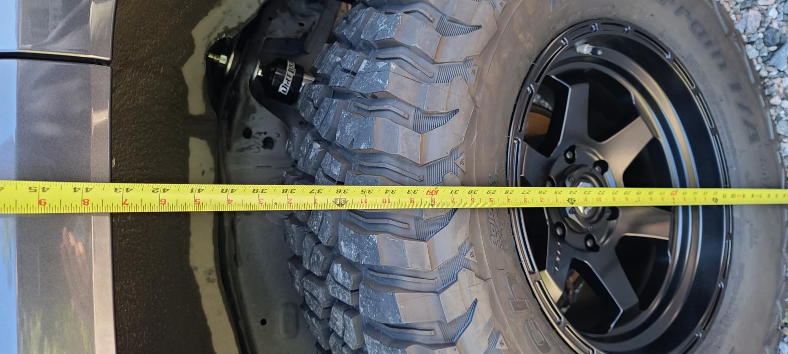

Is that stock size tires? And looks like you have a mild lift, plz explain!!
Truck looks great as its sitting though, good job :cheers:
Sorry, it took me so long to respond. Stock rims, and stock-size tires. 2.5" Bilstein 6112 in the front. Due to the front bumper and winch, only got about 2" out of it. 2" OME rear springs, with Bilstein 5100. Overall, I am very happy with this height and stance.

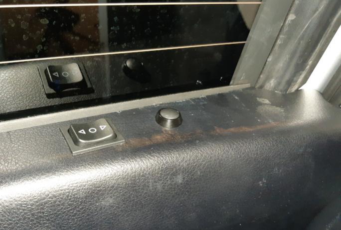

Installed the interior control for the tailgate, also known as Camping Mod for Liftgate/Window. Now i can operate the following from inside:
- Lock/Unlock
- Window up/down
- Open tailgate
I have used these instructions 2021-4runner-camping-mod-instructions-liftgate-window.23328/#post-300706
Thanks for sharing. I’m planning on doing this mod soon. I like the location you used. Most people I’ve seen that did this usually put it on one of the rear pillars but this seems like a more convenient location.
It's easier to run the cables only in the tailgate, and you only need the control when the tailgate is closed. The only disadvantage is that a stranger could operate the buttons from the outside with the window open. But with the window open, the vehicle is not secured anyway.

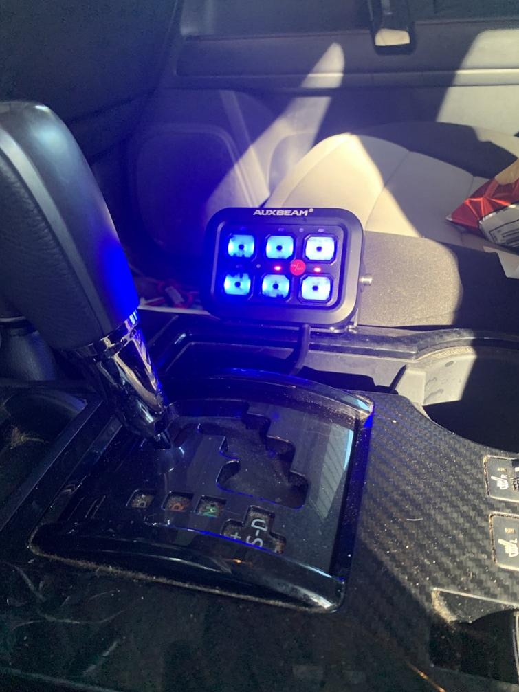

Auxbeam switch panel
Finding real estate to mount things is a pain sometimes. This was the spot I chose. Easily accessible, not in the way, and wiring was fairly simple.

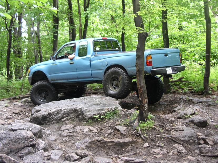

Fabtech 6" lift - 2016
I ran this same lift on my 1995.5 Tacoma with no issues. I decided to run the same lift on my 4Runner. It has been regeared to 4:88 Yukon gears. Feel free to flame!

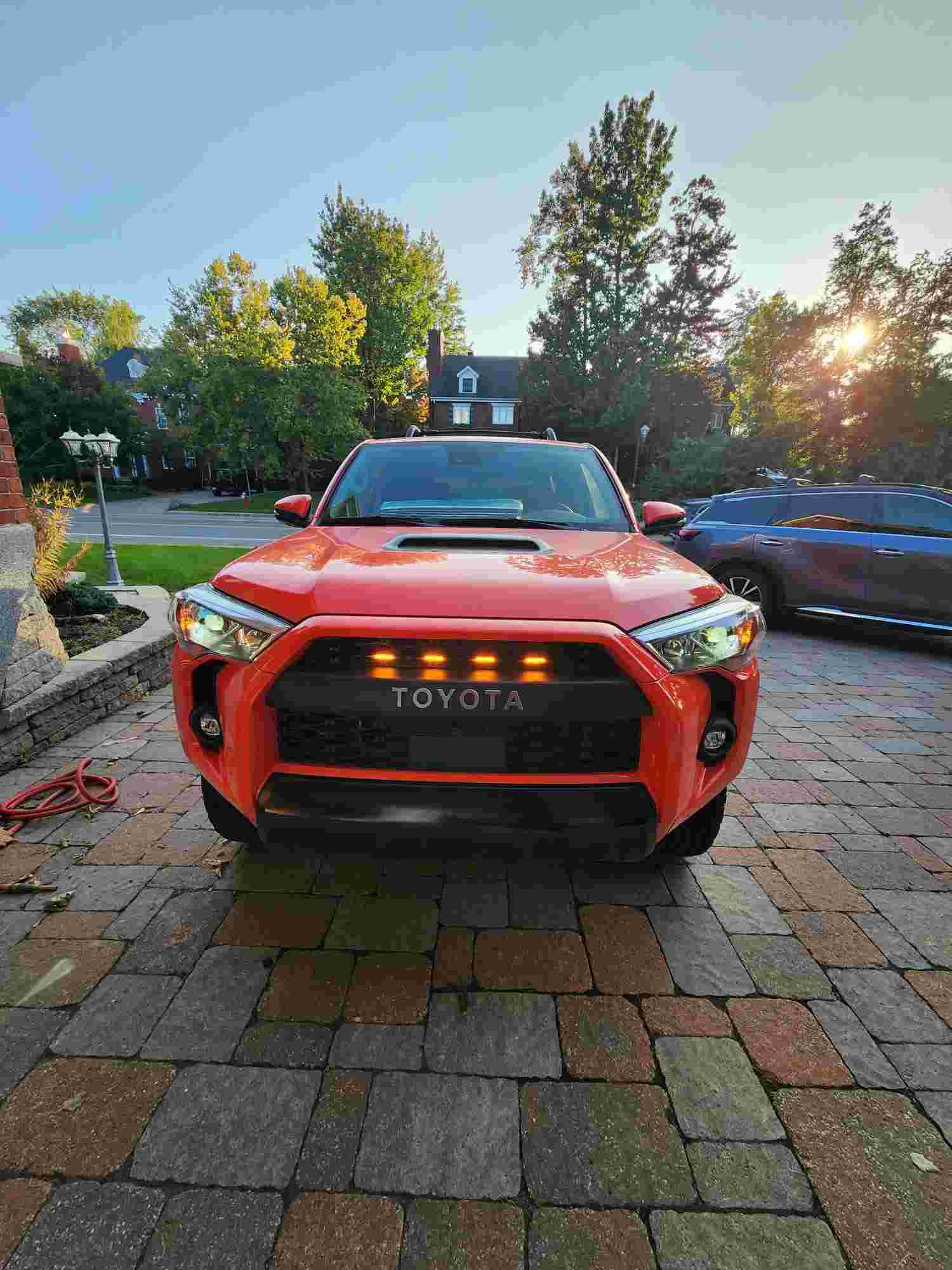

Raptor Lights Installed
Installed the Raptor Grill lights, dark tint and amber lights and tinted the 3rd brake light.
I had a hard time figuring out a fuse to use since I wanted the lights on all the time. Then noticed I have a fuse in the interior panel for KDSS but have a TRD Pro so no KDSS system. The lights were generally great quality except the truck side harness was not sealed and did not have srink wrap on the connectors. Pulled the pins out, this is a basic molonex connector so a small screwdriver in the end and compress the plastic barb and they pull out from the back. Added srink wrap with glue included and put the connectors back on and then heated them in place over the back of the connector and plastic sleave on the wire.
Routed the wires and had to extend them as they did not reach the fuse panel.
Removed KDSS fuse, the Toyota mini fuse does not fit the fuse doubler from the kit as it has a bayonet in the middle, so had to get another fuse; it did not sit very well either but made the circuit work.
All in all this is the second mod and next will be the side mirrors and full LED interior. Need to decide if I do Red or 6000K White. Footwell and under seat RED Led lights are also on the list.
