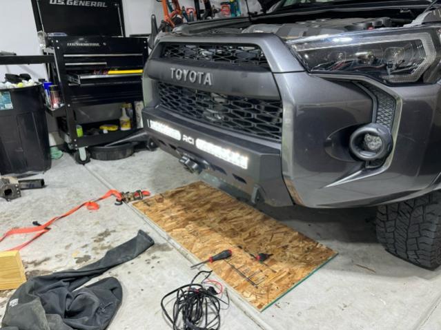

TO keep this post on topic: got my rock lights mounted,
I know the position isn't ideal but i'm done for today. Will play with it again in the morning.

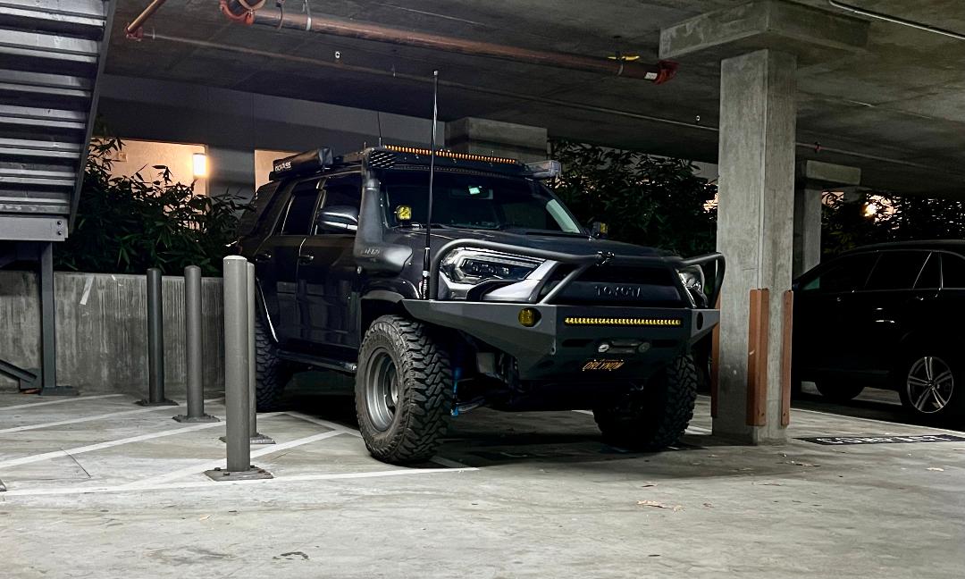

big ass antenna
Had this big ass antenna lying around for the past year from alamosa antenna, and decided to kill some time this evening after work by installing it.
For those that are debating the 6.6db vs 3 db GMRS bullbar antenna's from alamosa or Midland's. Just know, the 6.6db antenna is UUUUUUUUUUGGGE.

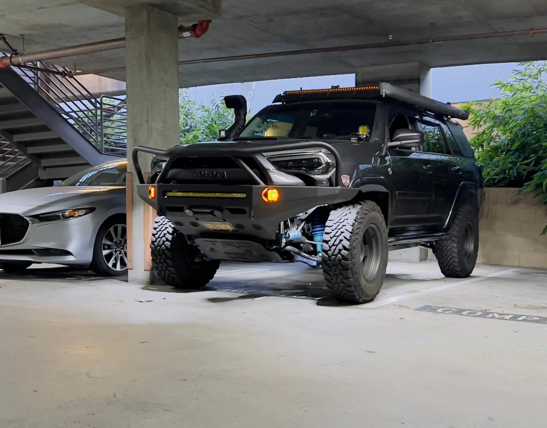

Installed the RCI hybrid bumper, extreme led 30",morimotoxb's, morimoto4 mbabger, and superwinch sx12

I like the look of that antenna. how far can you reach with that one? have you tested it. curious to see how it performs given I bet it wants a ground plane. looks like it could tear down a tree limb if it hit one lol
I have two comet antennas a shorter one and a longer one for more distance for my ham radio. I had a larsen antenna but it wanted a ground plane and I was getting poor SWR on UHF. my comets are ground independent but work surprisingly well mounted on the hood corner. I can hit 20-30km out with my shorty with poor line of sight. so for any hams out there looking for an antenna set up the comet SBB5 and SS-680SB work well for VHF and UHF
I don't think it can transmit any further than any of the other 6db antenna's out there. You are basically buying it for a certain style (like driving a giant RC car) or you want a really overbuilt antenna that can take hits. I still have the previous NMO mounts on the roof so i can switch between 2db or smaller 6db antenna's if i so choose.
Alamosa does make these antenna for HAM/GMRS/CB so pick your poison...lol.
I won't be able to test this out til the weekend, but if there are any surprises I'll definitely let the forum know.
cheers.

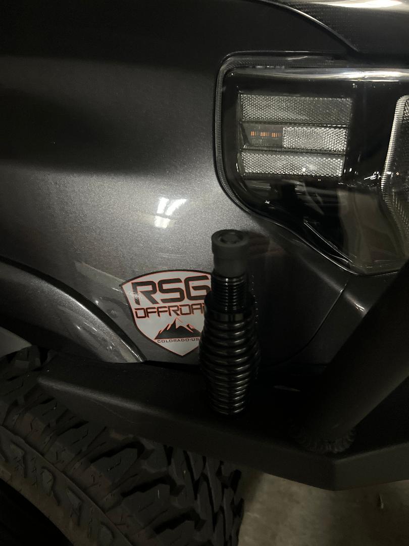

back on topic:

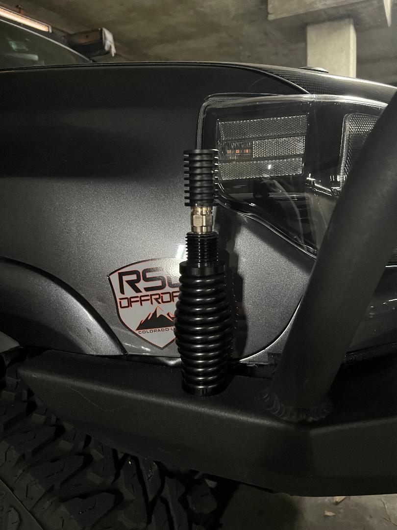

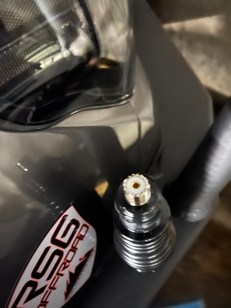

So on the end of the spring base of the antenna is a exposed cable. So putting a cap on it is not that simple. I know you can probably buy a cap for this but i don't know what this end is called so I bought 2 items off amazon:
1. A load tester and hollowed it out with a drill. This turned out too pretty and more likely to walk away and also worried about the thread seizing so I wanted a more low key option so...
2. stole my grandma's cane ends and drilled the opening out. I think I'll use this since its less likely to walk away on its own.

Looks like a PL239 or PL259 connector. There are caps for both, likely some screw on ones too.
that connector is an SO 239. the SO 239 is the female end where the male PL 259 plugs into. you can get a dust or rain cap for the SO 239. you want something that will fit tight or even screw on like hoppy mentioned
Yeah I ordered a few different caps to try cuz the nomenclature is confusing for male and female connections.
Thanks man
