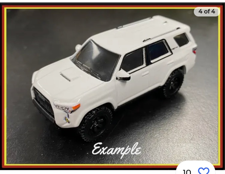

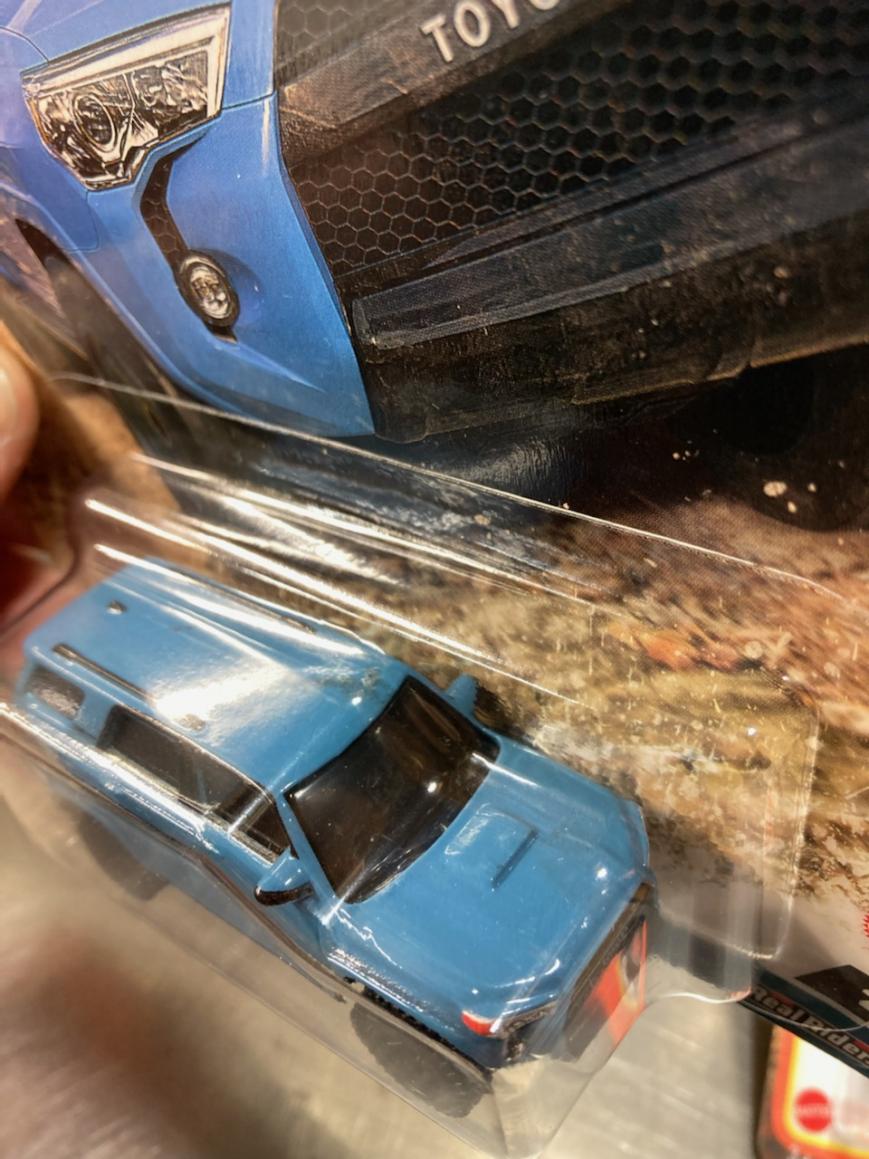

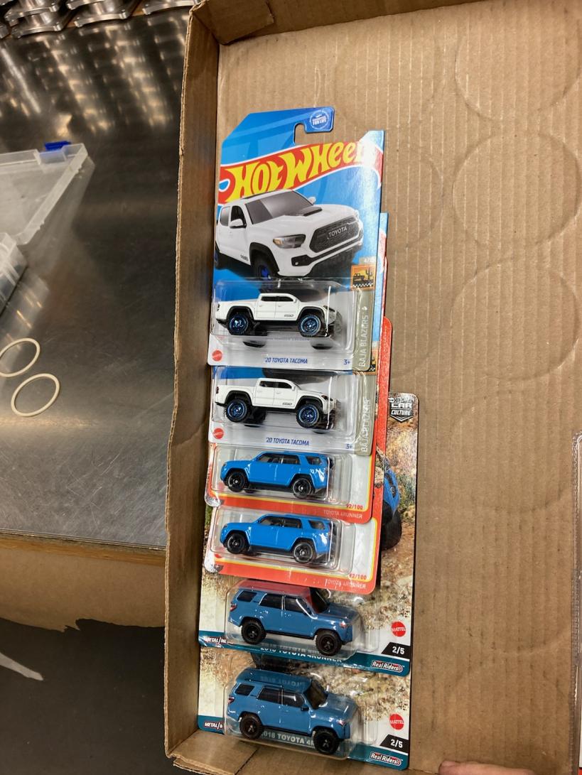

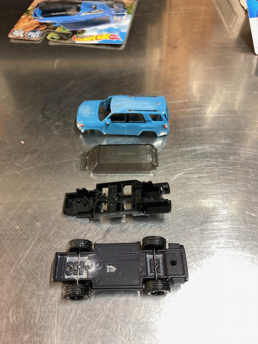

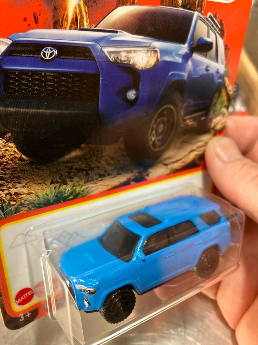

pick up a 2018 TRD pro HotWheels - from target. a few days ago
Dang i just did the same like Monday. Took it apart and going to paint it. Sticker kits on Ebay are like $6, found one in white and thats what i want.

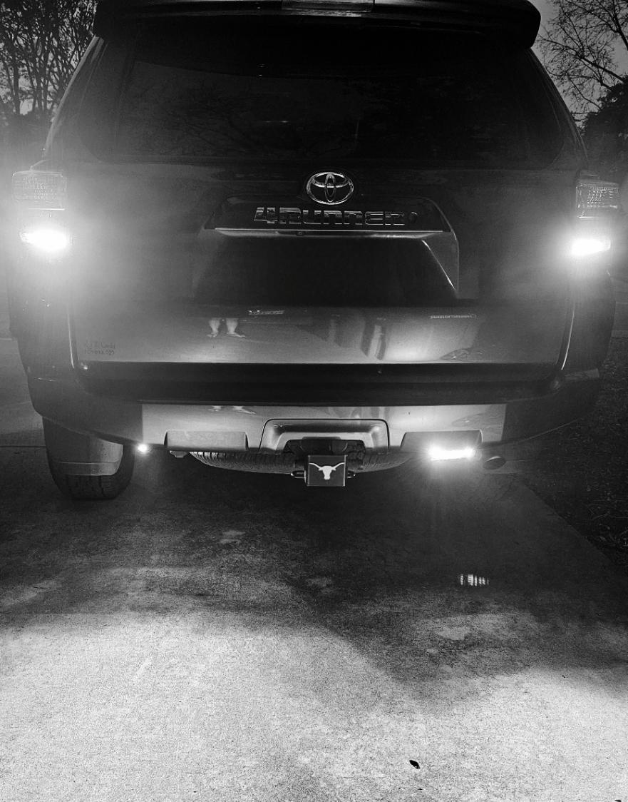

Installed auxiliary reverse lights. Took way more time that I had planned, but got everything nice and tidy: tapped into the yellow and white wires from the trailer harness (for some reason couldn't get ground from the frame), ran the wires up above the spare tire carrier.
Unfortunately, the lights from Amazon are too focused, makes it such that you see two bright spots in the camera and have a hard time seeing the actual ground... May end up sanding the lenses in attempt to diffused them, or maybe cut up a milk jug. ��

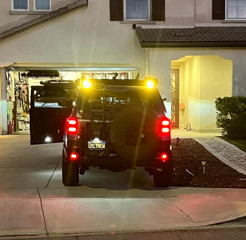

I learned a very expensive lesson a few months back. Diode dynamics backlight products do not work as brake lights or they will burn out.........
So now I had to buy another set of diode dynamics ssc2 pods w/ red backlight and make a brand new wiring harness (with quick disconnects) so they function as rear driving lights and reverse lights.
This is not diode dynamics fault for me using their products in ways it was not intended.
Also, i recommend flood lenses for any rear facing light. Sure you won't be able to see far, but everyone will see you. Also, floods work well with our back up camera's.
Chase lights are KC cyclone v2's... These are my new favorite chase lights. Small, low power draw, and bright, but not seizure inducing. (replaced diode dynamics ssc2 pods). Tempted to change the amber lenses to red so i can use them as road legal rear facing fog lights.
Morimoto v1 rear lights. Yeah, i know alot of people don't like the style, but people don't realize how bright they truly are. Have had them since they came out. They are really bright, and have a deep red hue.
lasfit door bulbs, and license plate bulbs (reflection on floor) round out the rest of the picture.
All auxiliary lights are hooked up to a lasfit 8 gang switch panel.

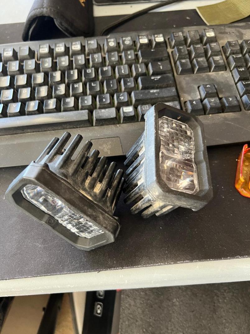

what burned them out? the constant on/off? it doesnt make sense to me as to why that specifically would ruin them. I inquired about running them in a set of headlights for my f250 and using the backlight as the running light/blinker and they said it wouldnt be bright enough for day time use.
we use baja designs s2 sports in the wide cornering as the chase lights. perfect without being too bright. i've been behind guys with s2 pro's and it was miserable.
not sure man, maybe constant on and off, maybe change in voltage, but both right and left lights died around same time (very odd). Maybe living in the rear bumper is too harsh for them...who knows.. It's my guess that its the constant on/off that was occurring 24 hours a day and every day.
When i bought new lights, i tested them in the old wiring harness (wired as brake lights) and they worked fine so I figured it was using them as brakes that did them in. So i basically built a new wiring harness and use them as rear running lights and back up lights (like they are suppose to be). Yeah, the backlight doesnt work well in day time or dawn/dusk (another reason went back to using them as rear driving/backup lights). Raptard lights are brighter.
my buddies BD's in strobe mode wanted to give me seizures. Also me running another set of ssc2's on the roof, made me realize they are overkill for rear chase lights.
RIP little lights (they are both dead)

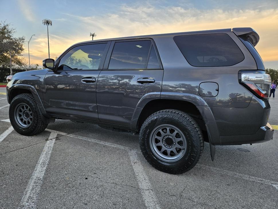

Excuse the desperate need for a car wash, but installed a custom fabricated rear bumper my friend made. Replaces the rear valance to match my front SSO bumper.
He may consider duplicating these if there’s interest. Does require bumper trimming and drilling into frame

very slick
