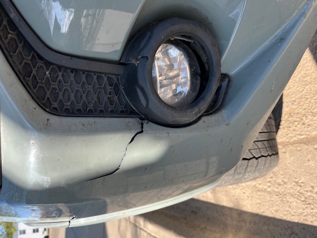

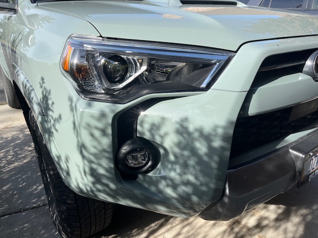

Wife struck a pheasant on a recent camping trip to eastern Montana area and cracked the bumper and fog light bezel on her 2023 ORP. No she did not got back and collect the pheasant for dinner. Rick’s auto body in Missoula did a nice job on the repairs.

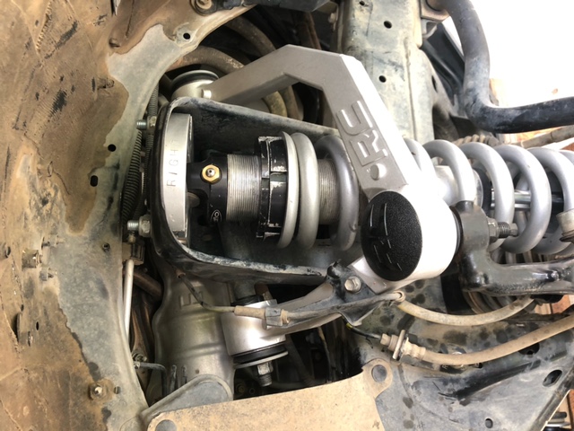

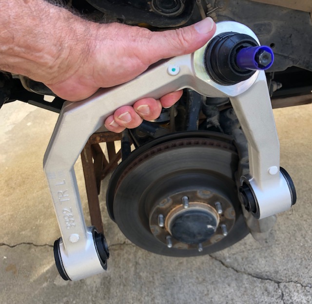

Front suspension refresh and upgrades: It was time to pull out the RadFlo coilovers for a cleaning and refresh. I originally bought them in 2010 for my '05 and then transferred them to my '18.

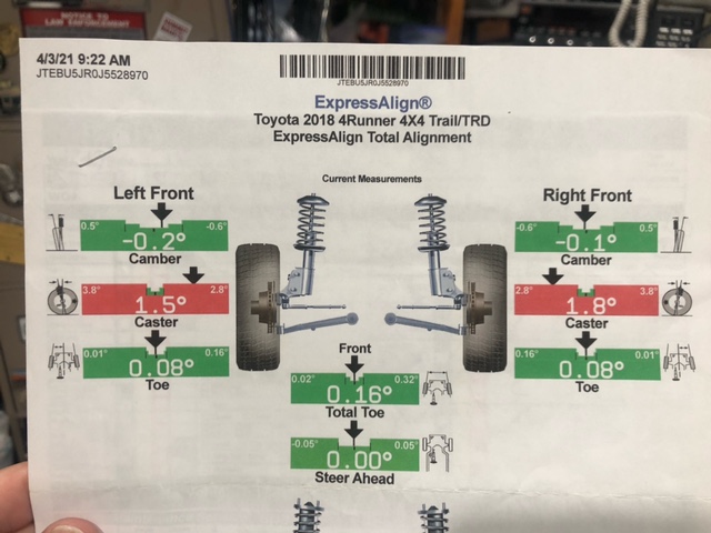

I figured now was the time to fix the low caster numbers with upgraded UCAs. After reading all sorts of posts across the Net I decided I didn't need more than a combination of standard rubber bushings with properly positioned ball joints. My RadFlos are set for 3" of lift and (see pix) my alignment numbers for caster used to be about 2 degrees low. I selected a pair of Rough Country UCAs.
Note 1 the RadFlo preload was backed way off to about 1/2". I also have a set of fender splash shields to install.
Note 2 Rough Country's fitment statement says "only fits 4Runners with 3 of lift" so good to go even though the UCA's are used with other lift numbers. RC makes no published claim I could find about caster numbers but the Net had mentions of a benefit of 3 degrees positive.
Sure enough, the alignment shop easily brought the truck within the Toyota OEM caster range. (See pix)

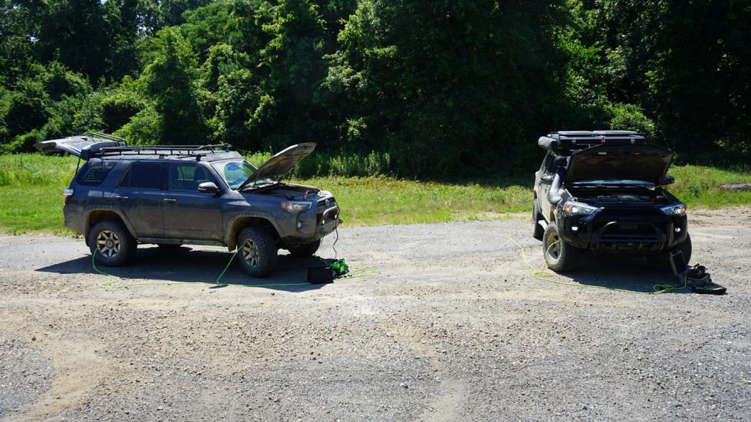

Ouachita Trails
Hit some trails in the Ouachita National Forest this past weekend
