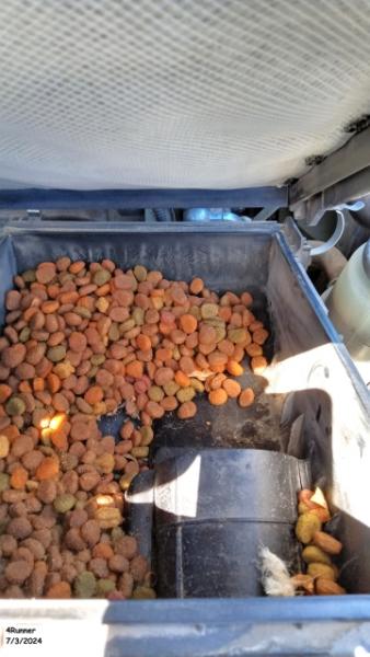

Removed the air filter today to blow it off. When I went to replace it, I found about 2# of dog kibble in the air box. #@$%&*^^!!! mice ...

I think it's an old stash. I installed the filter 7,000 miles ago in December, 2022 and I think it's the first time I blew it off. It probably was put there before I install the ultrasonic device and started putting dryer sheets under the hood both early this year. I've not seen the mouse on the trail camera since removing the food. I removed the cabin air filter and all was clean. So since there is no new food and with the constant noise, I think the mice have moved elsewhere.

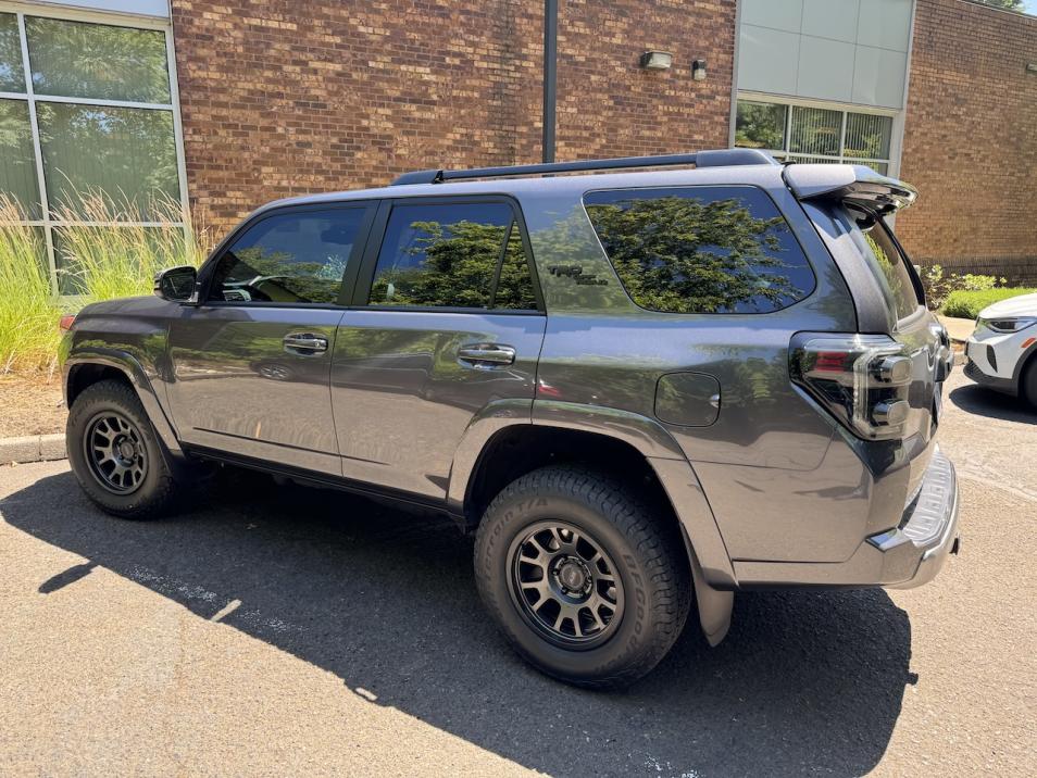

A couple of days ago, I had RR5-S wheels from Relations Race Wheels installed.
Finally. These are never in stock and grabbed them as soon as the pre-orders started again.
Also had BFG Trail Terrains installed. Replaced Wildpeak AT3W's that no one, not even Toyota could balance properly. It was an infuriating year with the Wildpeak's but I won't get into any of that.
