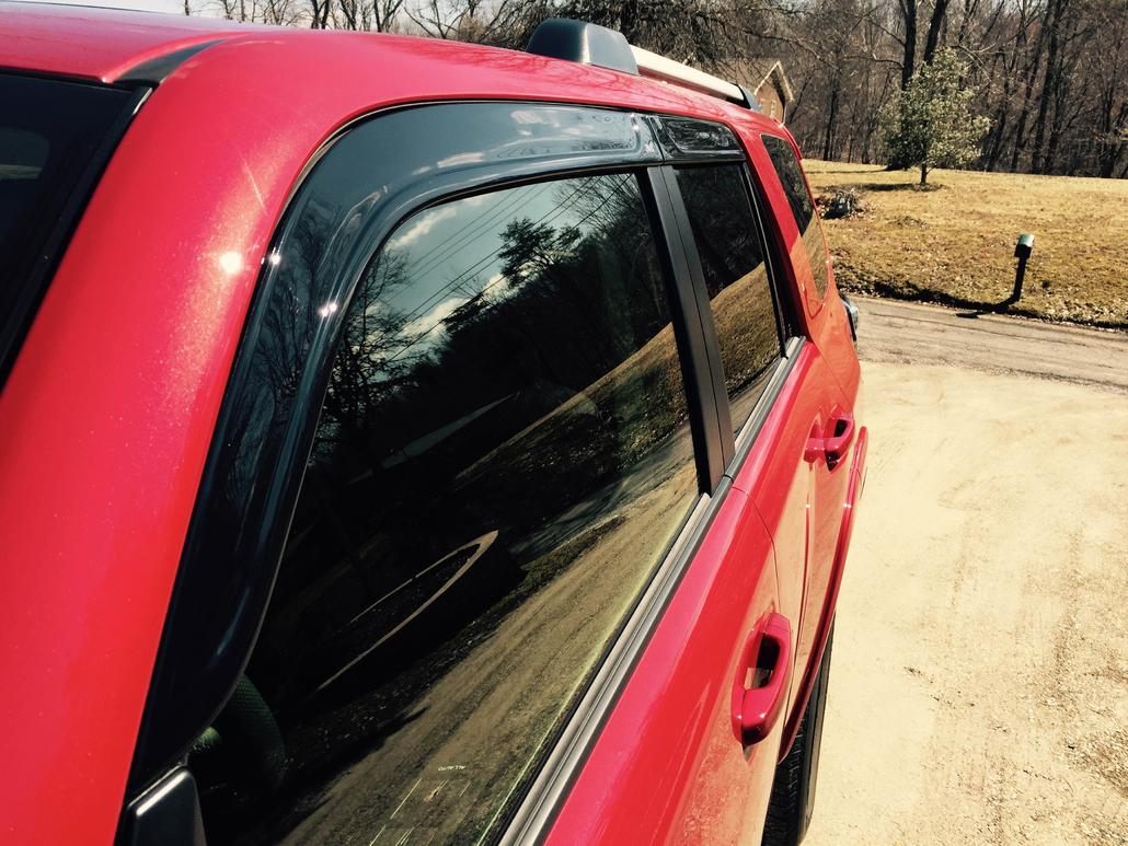

Added some low-profile AVS visors and bug shield............

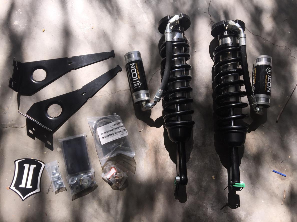

Installed these bad boys today. I was having a problem with the swaybar making contact with one of the support arms on the front bumper after installing the relocation bracket. I'm guessing the arm got bent last time I went to the sand dunes. So I just took the front sway bar off...problem solved :)

Mine did the same thing, though im not willing to remove it. Already had a freeway close call that very well could have ended very badly had id not been there. Im going to try extending the links. If that doesn't eork maybe temoving the brackets or making newones will.
Yeah it drives like a trophy truck without the front sway bar. Very smooth but a lot of lean. I'm going to try it out for a week, if it's too much I will probably end up just bending that support arm a little and try again.

Consider Warthog's "Close Call" for a good while if you do any driving above 50MPH or so. No swaybar can mean the difference between life and death in some cases - and you'll never expect to make that evasive maneuver - NEVER! But it does happen...

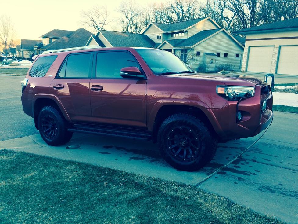

Took advantage of the extremely mild weather to wash the truck. I am absolutely in love with my new Black Rhino wheels and the General Grabber AT2's! Off to Seattle and Vancouver for work for 10 days and when I get home there should be a Magnaflow side exit exhaust and a K&N CAI system waiting in the garage for me! :banana:

What tires size are those?

This is what some of the other guys did when they first did there lift. [MENTION=8206]harper7[/MENTION] was one of the first ones to let everyone know about this spacer between the radiator brackets. I couldn't find his original post so here's one that is similiar. Hope this helps you guys out. [MENTION=102715]CrazyNorwegian[/MENTION] keep that front sway bar on if you do more pavement driving than offroad.

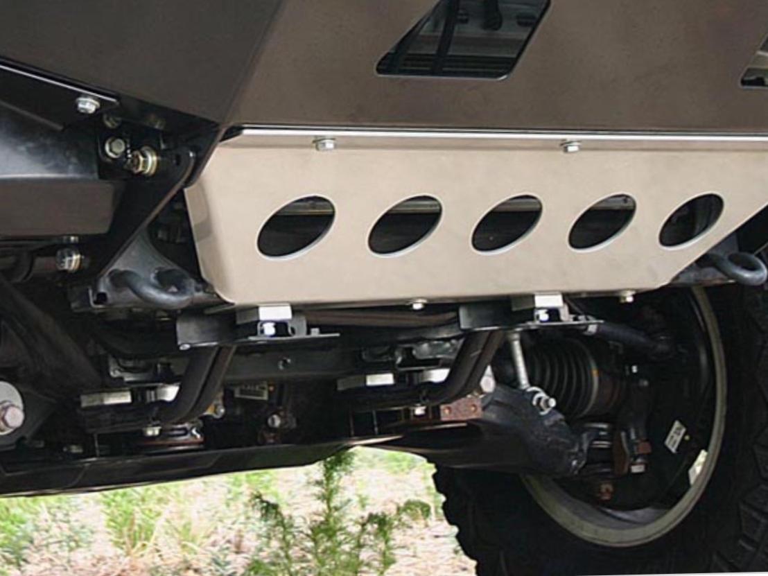

Take a look at this photo from shrockworks front end. You can see that they put in spacer blocks of some kind to drop the radiator bracket lower to prevent contact.
