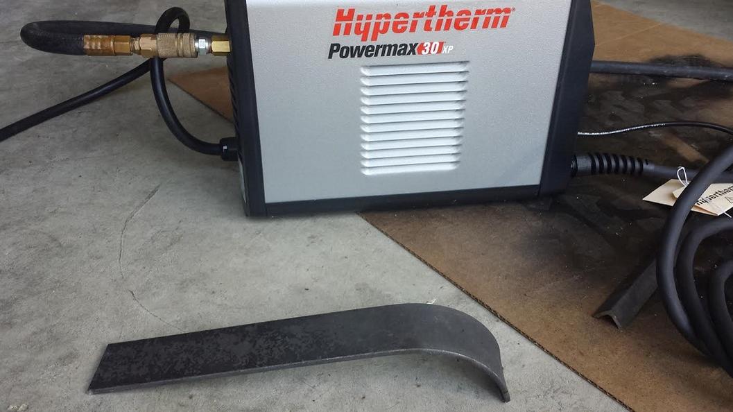

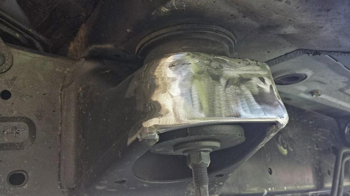

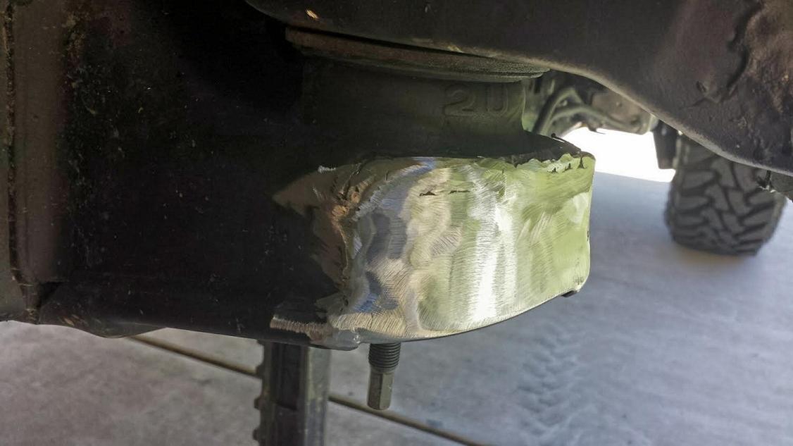

Completed the Body Mount Chop. Used 2" X 3/16" flat stock. Used a 3' long piece and bent into a "U" shape and then cut in the middle of the "U". From there, fitted up, marked, cut and grind to fit. After I had the piece made, used a torch and heat treated the steel, then welded in place, grind, clean-up with a flapper wheel and paint.

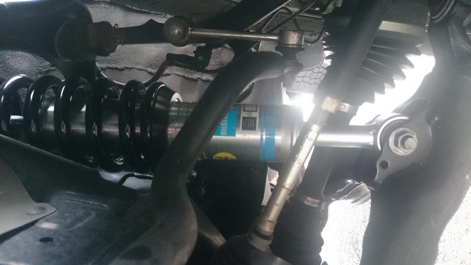

just had the 5100's put on. Didn't change anything else, kept the stock coils. I don't really go off road, so the little bit of lift is just fine. It's just about perfectly level now. I didn't measure it, but I should have. Any higher and I won't fit in my garage.

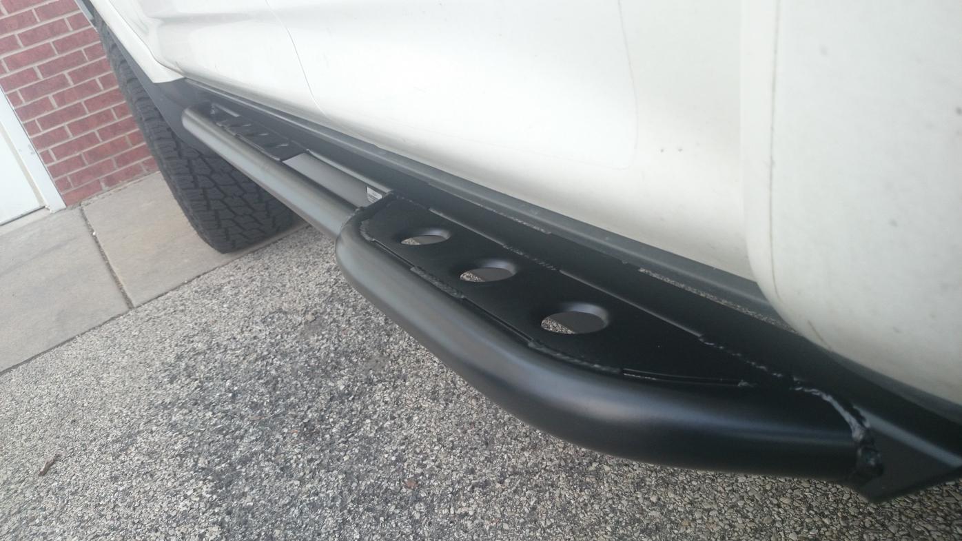

Spent the afternoon at RCi Metalworks with Josh, Miranda, and Eric. They have lots of cool stuff and are expanding their business. Really nice people! Should have a pair of RCi sliders for KDSS TE in about 2 weeks. Few mods needed to be made and then powder coat. They are going to make a kickout version as well as the straight.
