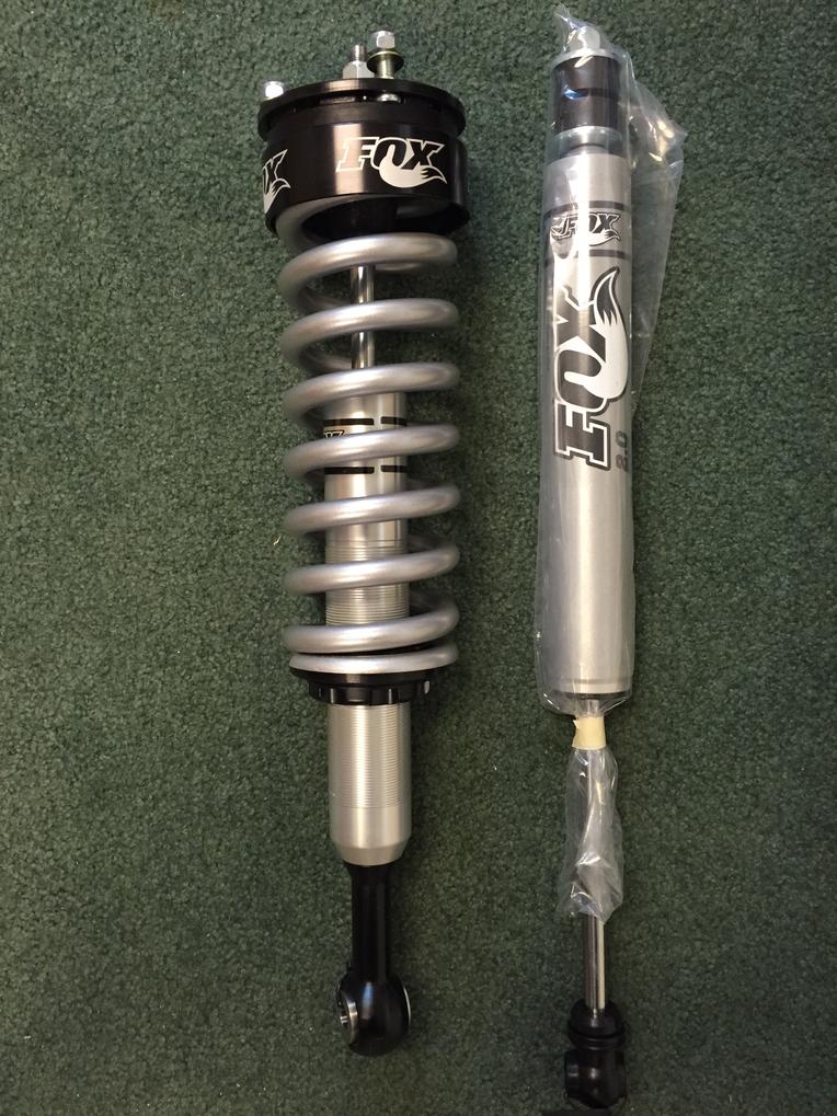

2.0 Fox IFP CO's & Fox Rear 2.0 IFP Shocks
These got delivered last night - Hope to install these this weekend or next weekend when I get some spare time. Replace rear shocks and crank the front CO's 1" to level the rig out.
