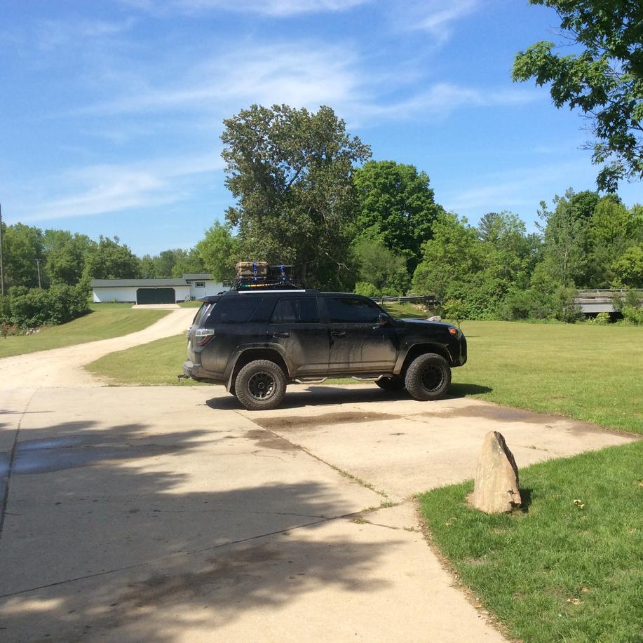

Packed it for our 560 mile road trip back home from mi to tn.
