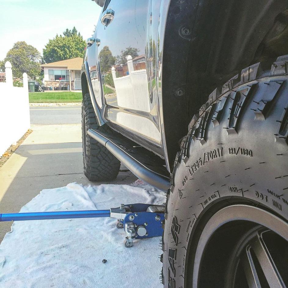

Installed my sliders today.

The main purpose is protection. They are probably the most common form of armor put on a vehicle. The help you to "slide" over rocks or stumps without causing body damage as they are mounted directly to the frame. They can support the weight of that side of the vehicle so they can be used in conjunction with a high lift jack for recovery as well.
Some serve a dual purpose and also function as a step. These provide a minimal amount of step assistance, but like you said are nice and low profile. They are also good at preventing door dings from idiots that open their doors into you at a parking lot :-)
These are Rocky Road Supersliders.
The slider part runs directly under the rocker panel and is make of hitch steel and is incredibly strong. The upward "step" bar is the "super" part providing additional body protection.

How was fitment? Wait time?
Fitment was good. Not great. The instructions said that the plastic piece behind the front tires will need to be sanded a bit. Wrong. They had to be chopped substantially before fitting back on. The width of the mounting bolt hole locations were imperfect by a couple millimeters. There is a large space to allow for variation in frame bolt location, but the mounting plates on both sliders were built just a bit to close together making for an imperfect match with the existing frame bolt holes.
The kit includes 6 bolts for each side and says not to allow the sliders to hang from the frame until all 6 bolts are tightened down. Well the hole where the bottom bolt on the middle mounting block is is not a threaded hole and no bolt will go in there. They did provide some spacers for making more space for the fuel line on the drivers side, but it was unnecessary. I'm going to image all of this and email it to them so they can address this for future sets made. I don't know if there have been changes made down there since they designed these or what, but a couple discrepancies. No big deal and I'll probably have them spot welded on also so no worries. Just a couple notable points.
Wait time was great. Received 3 wks after order made. 2 wks to build and 1 week in transit. At $539 powdercoated and shipped I really can't complain.

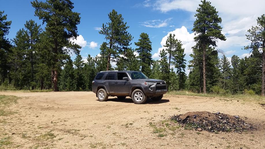

I went and did some light wheeling in Pikes National Forest up by Woodland Park, Co.

Funny story: Ranger shows up and asks the guys: "Where is he going? Who in their right mind would bring a new truck here? Are you sure he is the owner of that vehicle?"
Guess he's never met any Arabs... we all Drive it like we stole it :driving:
But honestly would never do mud stuff again.. washing it again today just to get the rest of the dirt off and stop those front brakes from squealing :redbrick:
