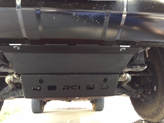

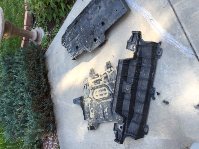

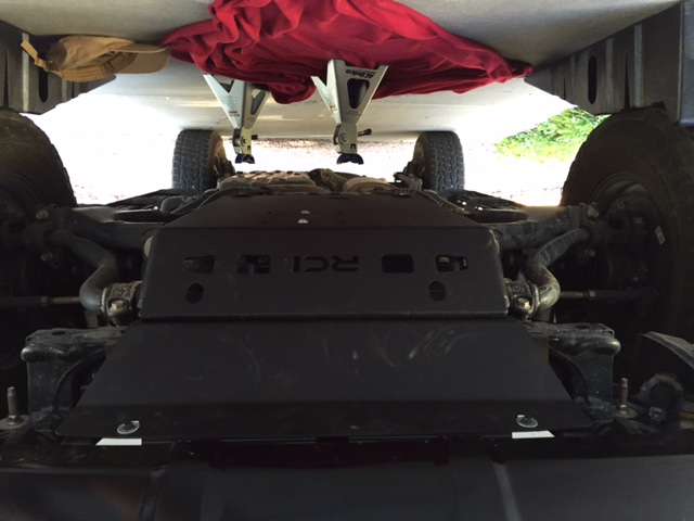

Installed RCI skids this morning. Very easy install. You don't realize how crappy the factory skids are until you install a nice product like this. Next step will be protection for the transmission, transfer and some sliders. Also investing in ramps and jacks to hold up stuff is very helpful.
No idea why the middle pic keeps flipping over.

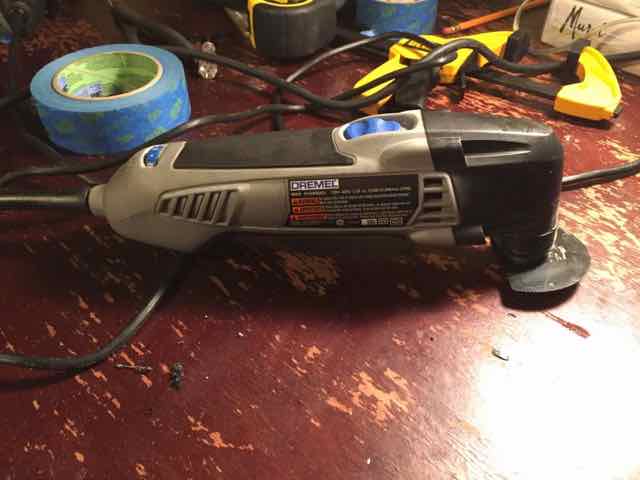

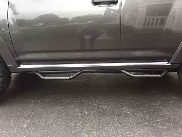

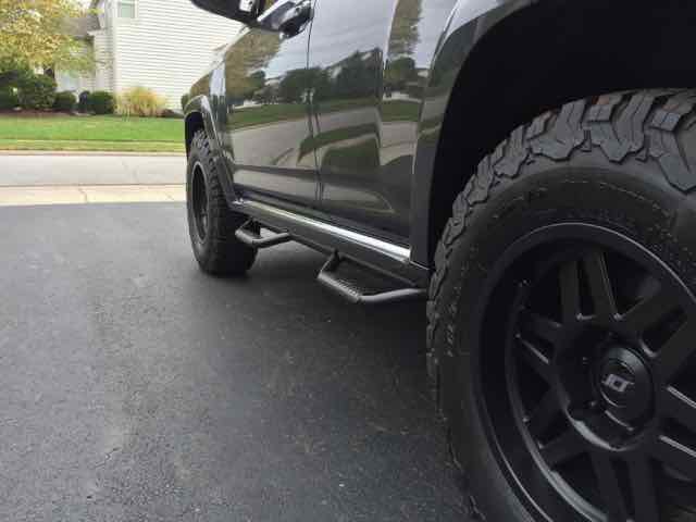

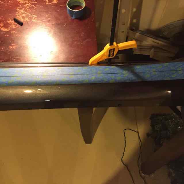

Rocker panel cut and n-fab install. Thanks [MENTION=65614]Antman[/MENTION]
Tools for the job:
Dremel multi-max with oscillation blade (started with grinder below but man this is by far the superior option. No overheating.

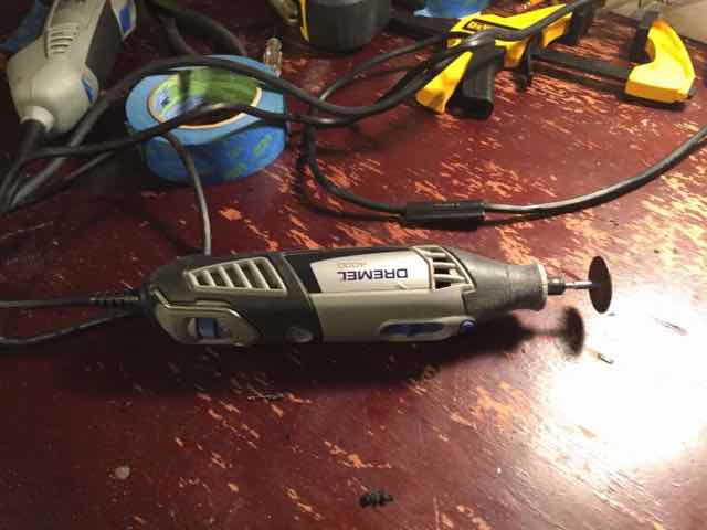

Dremel with grinding rotary wheel

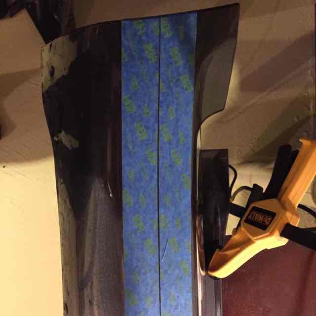

Measure, sharpe hash, tape 'em up
Clamp 'em down with the best investment for this job
Hire this guy
Finish it up

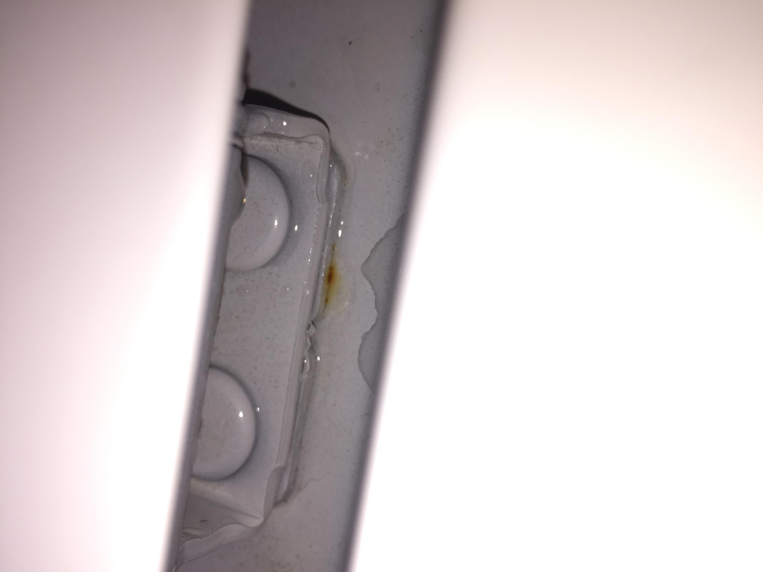

2015 got a bath and I found rust. WTF?!
Anyone have this issue or even noticed it? It's the tailgate hinge on the drivers side. This shot is looking down through the gap in the roof. It's small, but the thing is 2 months old

Have not noticed that on mine but you are in the salt belt. Still messed up being so new.
