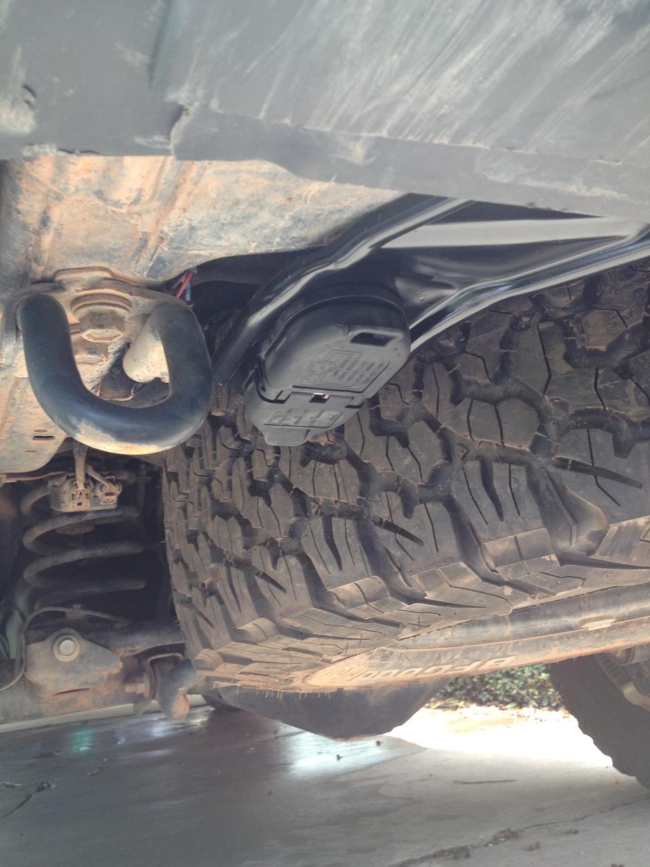

Fixed my trailer wiring plug after ripping one of the covers off in Moab last week. I removed the bracket and bent it up further to better protect it off road. I know it was already hard to get to and this makes it harder, but I've only towed once in the 3+ years I've owned the vehicle, and off road functionality is more important to me. By the way, the trailer wiring plug is the same as the one used on the Tundra. If you search for a 4Runner one you won't find it, but the Tundra one is identical. The part no. is PT725-34140.
Good to know. I tore the cover off mine the other day wheeling. I need to replace it. My buddy has a tundra. Maybe I'll take his when he isn't looking...
