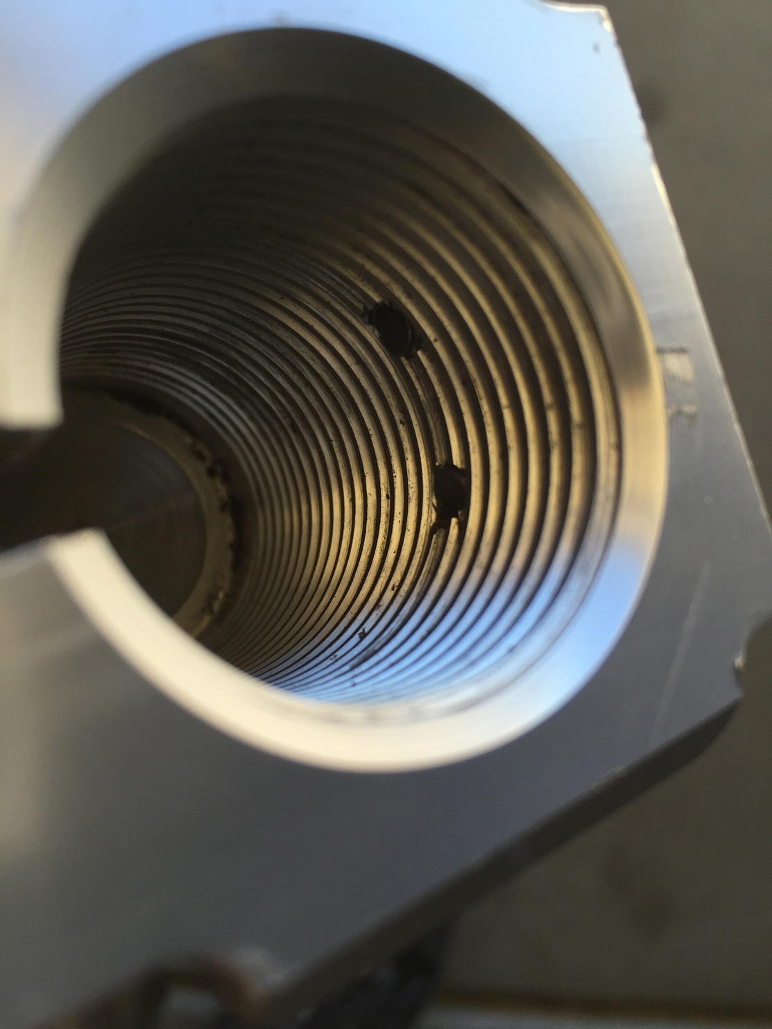

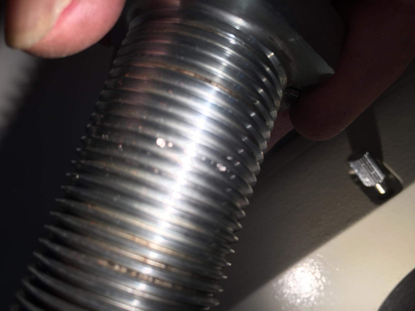

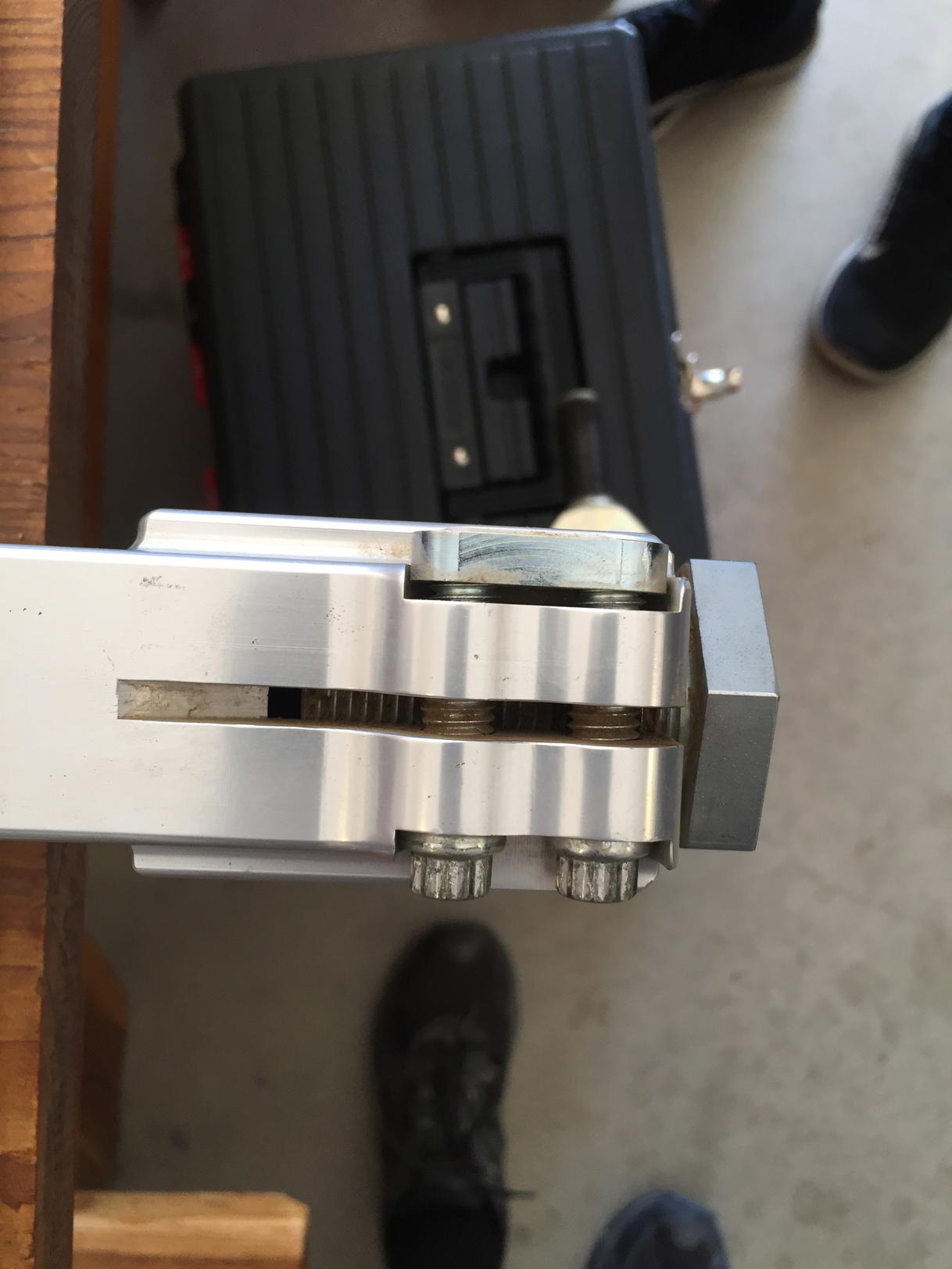

I tore down my Icon rear trailing arms after 5k miles for inspection and grease. Hex collar was frozen due to the threads being seized up with dirt. Blew out and washed the sleeve, sprayed some lubricant, it loosened up but wouldn’t spin freely. I tried loosening the screws that fasten the skid plate on the opposite side and it came free. Seems that the skid plate screws were too long and were pressing against the threads and inhibiting movement/adjustability (note the two fang marks from the screws). Put it all back together and everything seems ok…until they get dirty again. Seems like a poor design to me, with the pinch bolts and the space that is left for dirt to foul the threads on the outer sleeve. Icon is sending me shorter screws.
